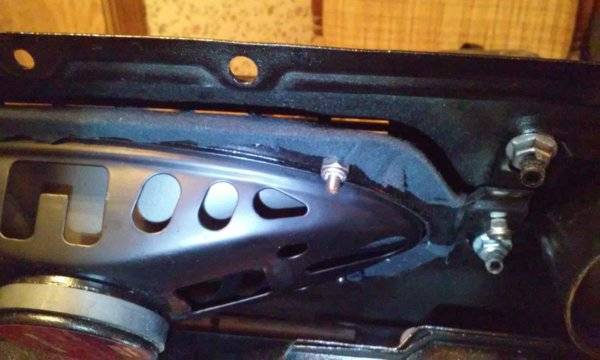

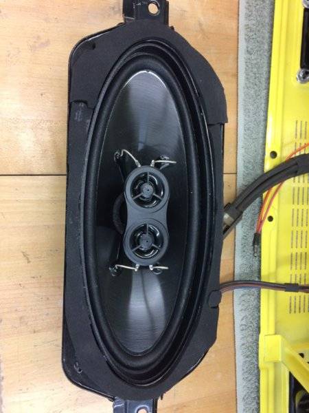

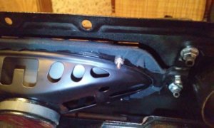

I got a replacement dash speaker to replace the old rotted out one, and installed it. I had to make my own vibration gasket but everything fit well.

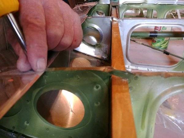

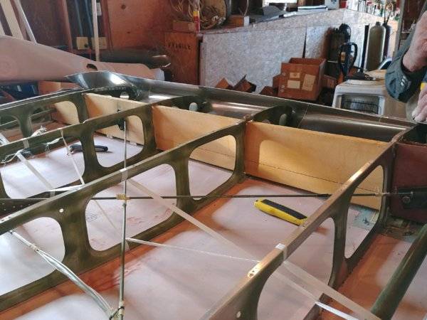

On the Citabria, after inspection, we found that the left wing had a cracked main spar. We will need to disassemble the wing and install and re-attach the ribs to a new spar. There is also some rib damage that will need to be fixed.

I just installed a new speaker in my dash also and noticed that you mounted the speaker on the bottom of the bracket rather than on the top and sticking thru. I was worried about clearance with the radio so I cut those unneeded ears off and then it fit thru the top. I also cut a piece of black cloth and glued over it. I'm not sure since I haven't mounted my radio yet, you may want to check that radio fit if you haven't.

One of my chargers I used the dual speaker. It is tight but fits...

Thanks Kid for pointing that out. I think I can see from your picture how it should go. I already have it mounted and everything seems to fit with the radio but it will be no problem to change it and mount it right. I also like your idea of covering it with a thin black material to keep dirt and other objects from falling in and vibrating around in the speaker diaphragm.
