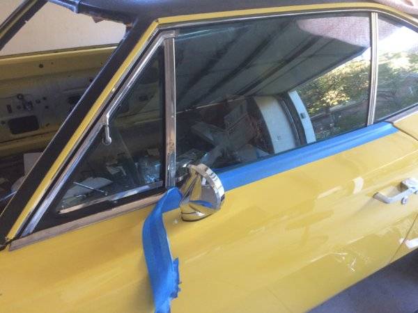

I worked on reinstalling the door windows. I spent the whole day cleaning and fitting. I was able to install the drivers side but I am still missing a part on the passenger side.

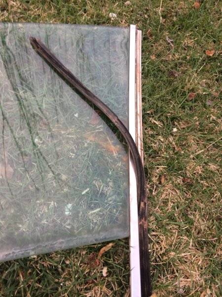

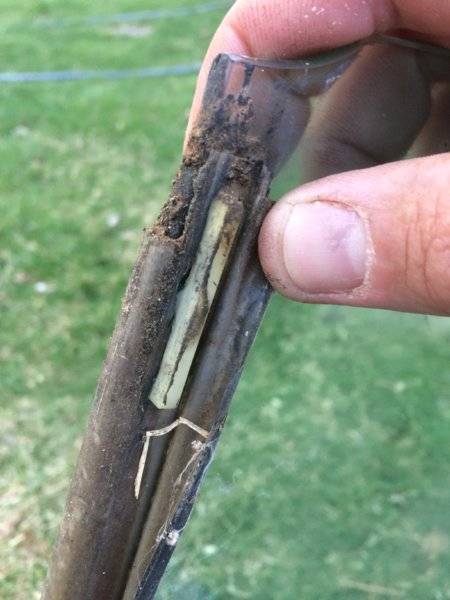

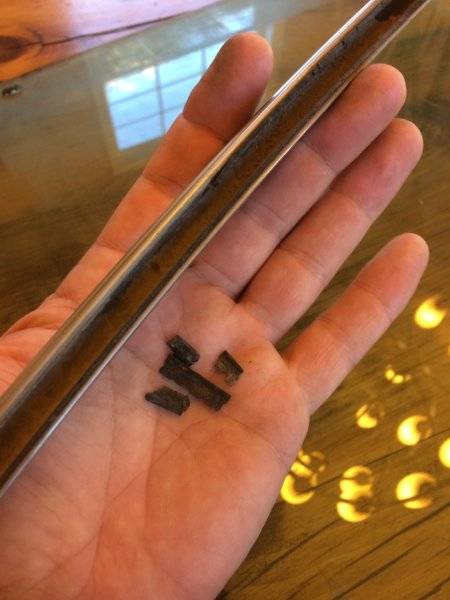

I first removed all of the old broken and brittle seals and kept tract of how it all came apart.

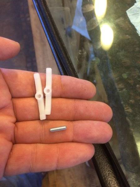

I used a razor blade to clean all the hard water off the windows and decided that they were still in good condition.

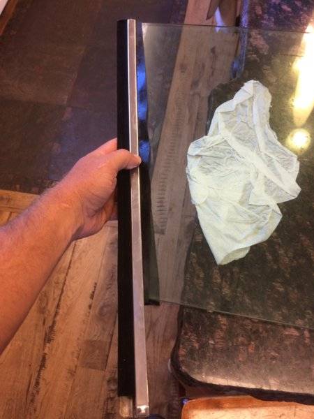

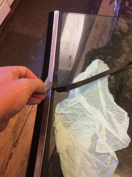

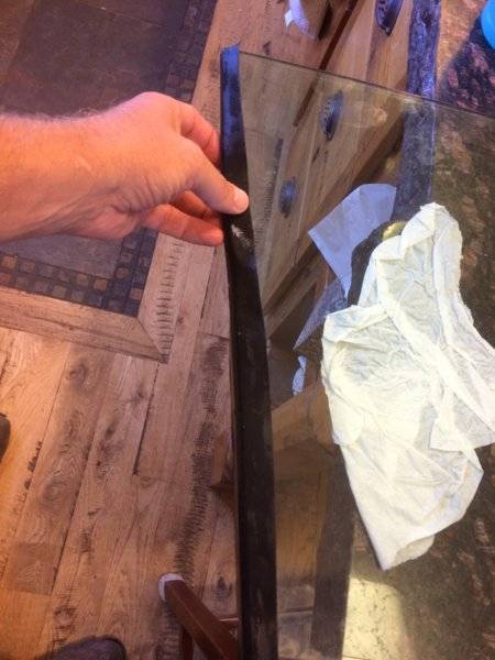

I had gone to out local glass company and got some window installation tape to reinstall the chrome trim back on the windows. I had previously redone the wing windows so they were ready to reattach.

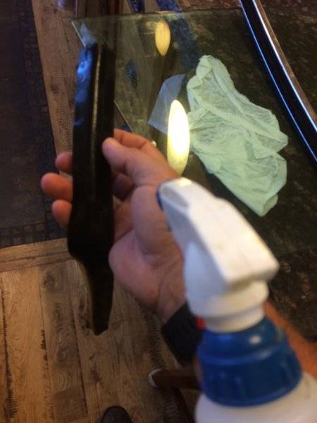

Once the window tape was cut to length I used glass cleaner to wet the tape to help it push on better.
The side that attaches to the wing window was more of a struggle for me. I had a hard time feeding the wing window on but after a few trials I got better at it.

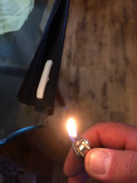

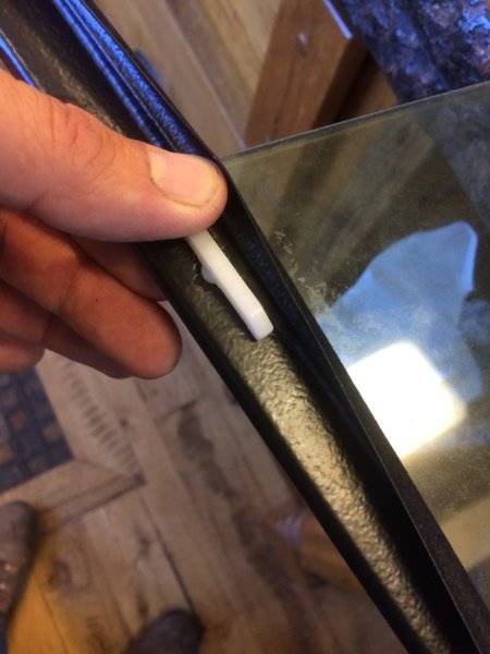

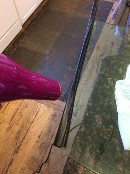

I used a hair dryer to help the plastic conform to the curve of the window first and then fit the plastic clips through the holes. I used a drill to drill the holes in the plastic to match the holes in the window.

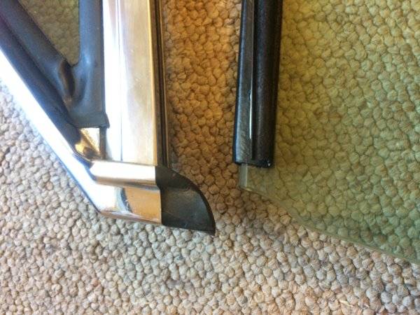

After a couple of tries I realized that I had to cut the top of the plastic trim back far enough so that it did not hit the top rubber seal on the wing window.
I also had to heat shrink the top of the plastic trim so that it did not hit the top wing window mounting screw.

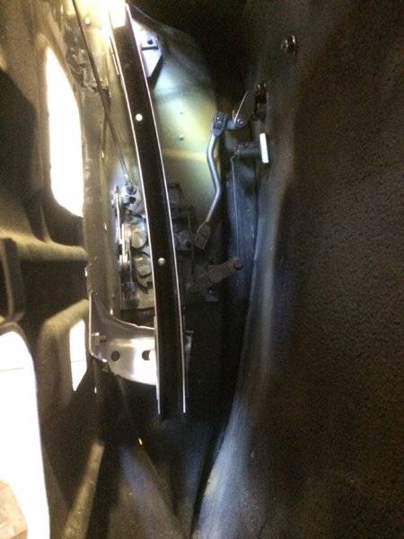

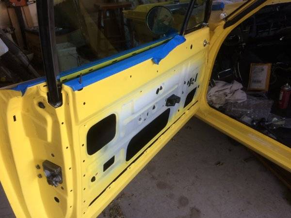

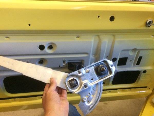

I set all of the window hardware loosely in the door and got all of the mounting hardware ready to set the window.
I had to recruit my son to help me set the window in the door, it is definitely a two person job.
I played with the fit and think that I have it fitting pretty good.

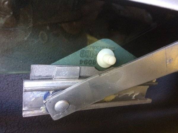

I am not very happy with the window mounting bracket from the roller arm to the window. It seems to rock back and forth and wiggle as it is rolls up and down. The slide up and down through the wing window also seems to tight.
Watching this part close. Keep the pics coming.. I've been putting off doing my windows, I guess because they look so hard to do, and get right. Looks like you're getting them right tho.

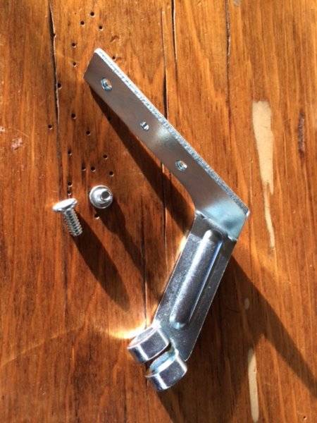

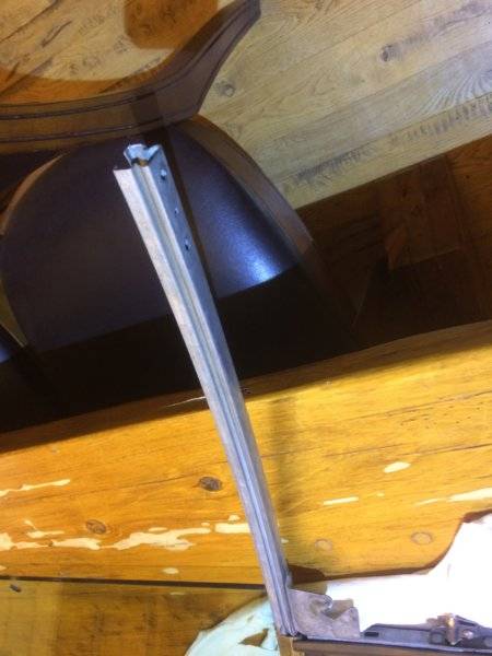

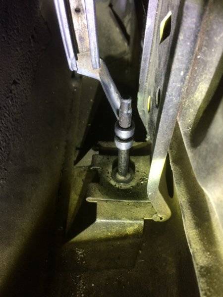

I did not realize until I was cleaning the window mechanisms that my driver side window slide rail is missing the little loop support that slips over the rod at the bottom of the inside of the door. Does anyone know if I can find one of these without buying the whole wing window frame?
If I can't find one I may be able to make and weld me something similar.
Might check Mega Parts, they have great prices & don't charge you out the a$$ for shipping.
Thanks both of you. Looks like both places have the pair for the same price.
I now have a pair coming. I will have an extra left side bracket if you find out that anyone needs one.
I got my vent window support bracket the other day ( fast shipping from Mega Parts).
This bracket came with mounting screws. I was going to spot weld it on but maybe with thread lock I could trust it to not rattle off or do you think I should still spot weld it on?
