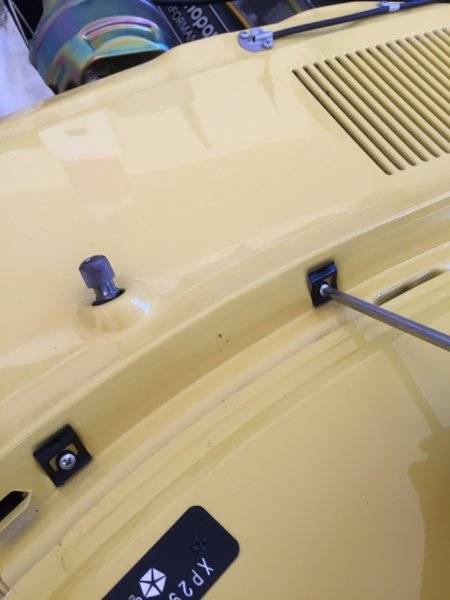

That plug has to push in to lock the holder.....
Do I have it in backwards? I thought that I remembered that it went in the way that I had put it.
I did have it locked in before but the arm of the window lever was to close and would catch on the edge of the plug extension as the window would go down and pushed the plug sideways until it bent and pulled out. After shortening the end some, so that it would not hit the lever arm, I made sure that it locked back in and I put a screw in the tab end to insure that the locking tabs would remain spread and locked. Maybe if I had pushed it in from behind I wouldn't have had that problem.
You have it the right way but the pin has to be pushed all the way in.....

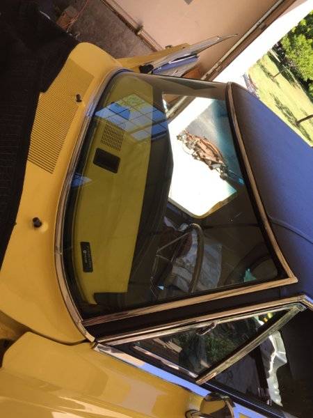

so cool your driving it, i'm not too far behind another few months but then winter will be back again. I just got back from my maiden voyage around the block with no windshield been dragging my feet on that one, hoping to have my trim clips high enough to grab the stainless. in your windshield install pic is that the clip level height in reference to the cowl, before the adjustment or after, thanks and congratulation on actually enjoying the car and driving it.
The trim clips kit that I had bought did not have the right sized clips for the bottom of the front window. I had installed them the other day in preparation for the window installation. When They installed the windshield the clips were to low and would not clip the lower trim on. I had them remove the window. (which was scary to me. I thought that they were going to break it.) I re-drilled the clip screw pilot holes 1/4” higher and reinstalled the clips. They reinstalled the windshield and everything fit good. I was happy.
Your car is coming along nicely and looks great. I have been really enjoying taking mine out for drives.
The window trim clip reference picture it before I raised the clips up. I had to bring them up about 1/4" higher.

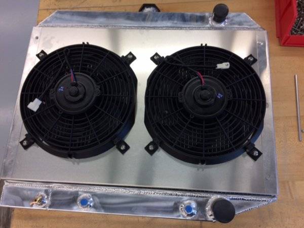

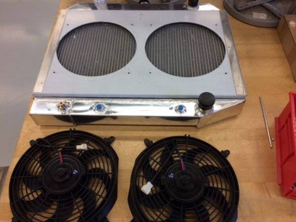

Lately I was able to fit and attatch my electric fans on my radiator.
So I'm wondering is your radiator installed like the picture? I'm thinking it might help to remove the solid mounting sheet for the fans and mount them with straps. All you air has to come through those holes and maybe it's to restrictive. Also check that the fans kick on at your set temp, and they are spinning the right direction. Just some random thoughts of the top of my head.
Thanks Tim,
I have been checking the radiator, fans, and mounting sheet. I called the company that sold me the setup and they suggest that the setup like mine helps the air flow better. I can feel the fans pulling a lot of heat through. I still may try opening the blocked areas to see if that helps.
