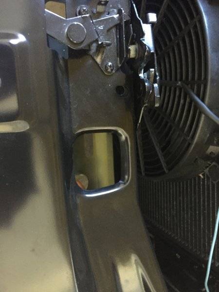

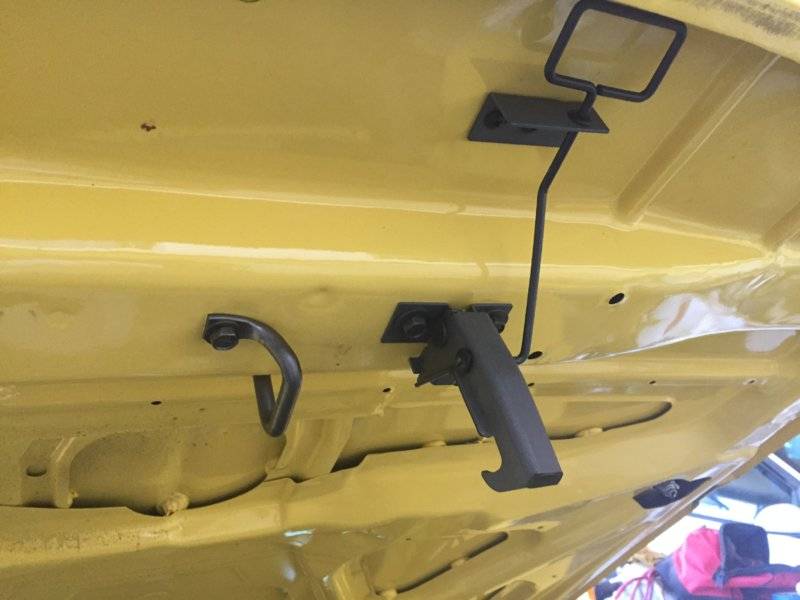

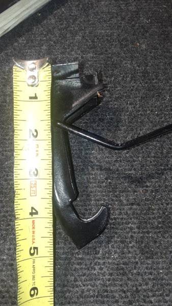

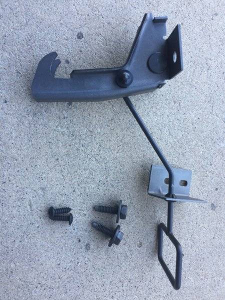

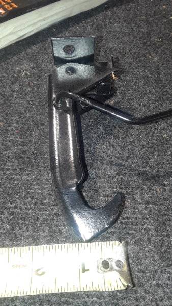

I have been worried about driving my car around without a safety latch on my hood so I bought a re-pop one for a 68 charger. I bolted it on to test fit it and it doesn't latch onto anything. This is on of the many parts that my car was missing so I don't know what I might be missing or what it was suppose to look like. The latch does go through the hole in my grill support frame. Is there another bar or something that is suppose to be there for the latch to latch onto?

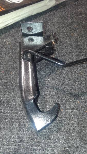

mine catches on the back side of the hole, i believe i have an extra catch if you cant adjust it to work. maybe repop is off?
I see the problem the stock one bolt holes line up with point of catch yours doesnt
That repop looks off. The bend in the original looks more prominent.

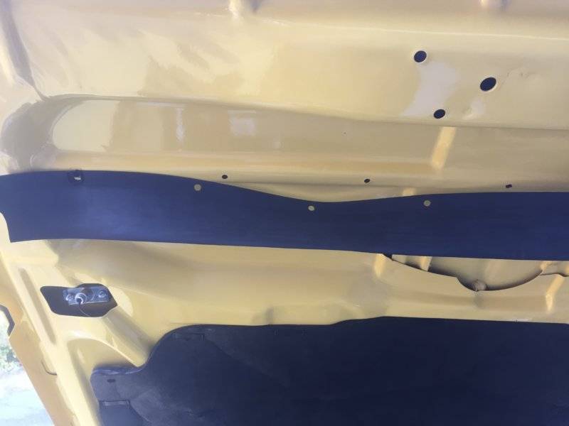

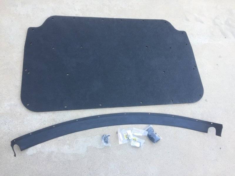

I guess in the process of trying to make one size fits all they are making parts that one size doesn't quite fit anything. I just got the hood to radiator seal and tried to install it. The clip holes do not line up. I called Classic Industries and they told me that that was because it was made to fit many different cars. I guess I need to modify it and make my own holes.
Ahh the Imperial to Metric conversion didn't quite work out so well...
Now I'm glad I was able to clean mine up because I was looking at replacing it with the exact one you have from Classic.
You would think that if they wanted it to fit multiple cars, they would make ‘em so that you can punch your own holes.
