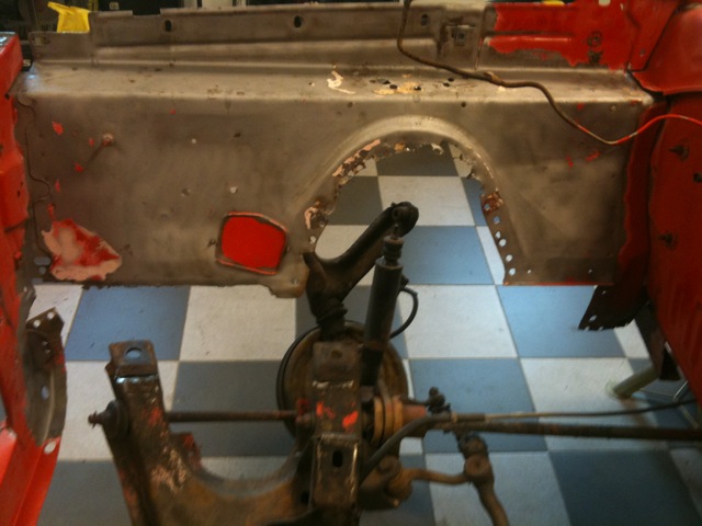

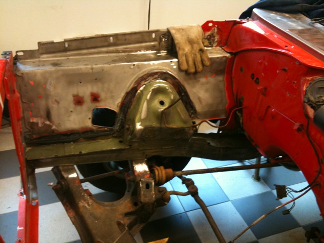

Almost ready with the right side, that was the easy side... Will start with the left side today.
Should have ordered the fullsize floorpan :mad:, had to replace a bit over the rear bracket. The rear bracket was also crap so I mad a new one.
I envy you guys who lives on the right side of the atlantic ocean, 4 bracket are like $ 120 but for me it is $ 240 due to taxes and freightcost, and it takes a couple of weeks to get them. :mad:

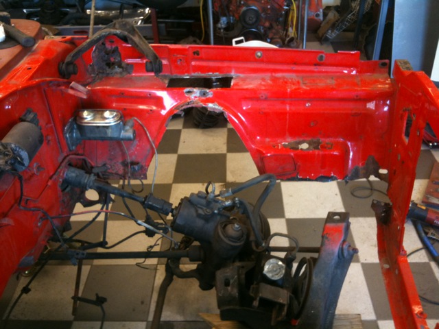

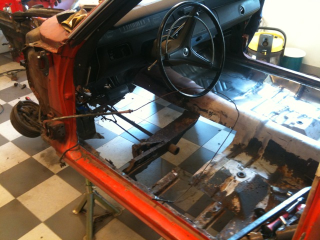

Yes! My wife went to work this morning and I still have three weeks left of my holiday, guess what I am doing????

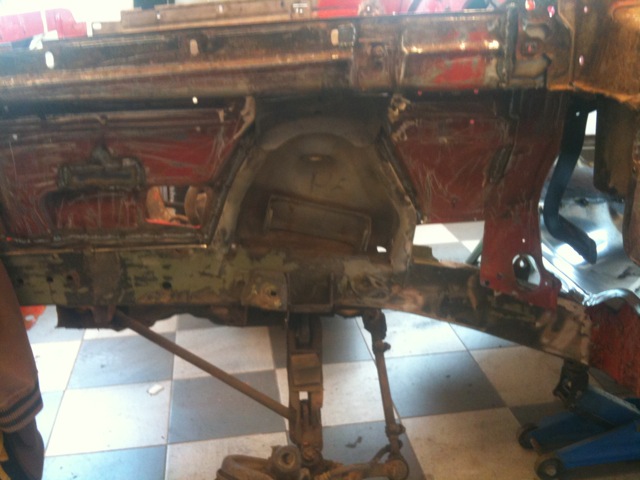

Spending my day with a "camber" bolt that was stuck, than the k-member bolt rotaded inside the frame so I had to cut it up to get it loose but finally it is ready to tryout the new frame rail. Found a rat nest inside the frame too!
If I can stay to the plan it will be ready to grind and put on some primer this weekend, I will probably take off all the undercoating and paint it, I will never drive in wet or salted roads again so it will do good with epoxi primer and 2 k paint.

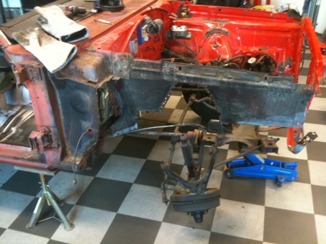

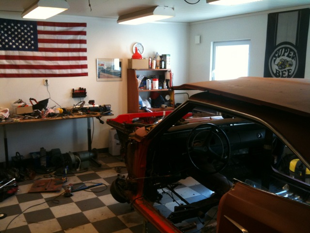

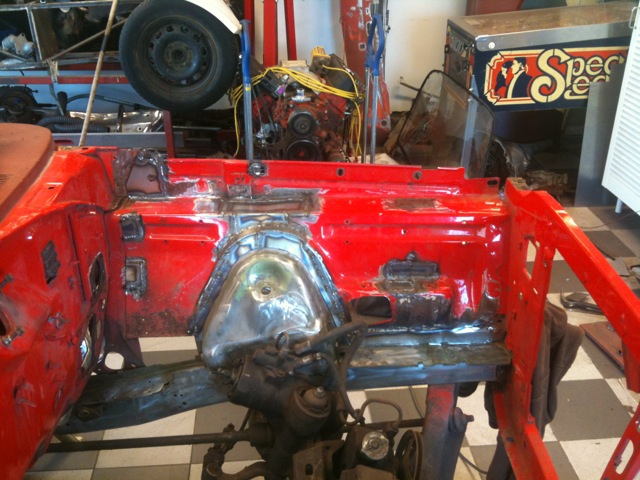

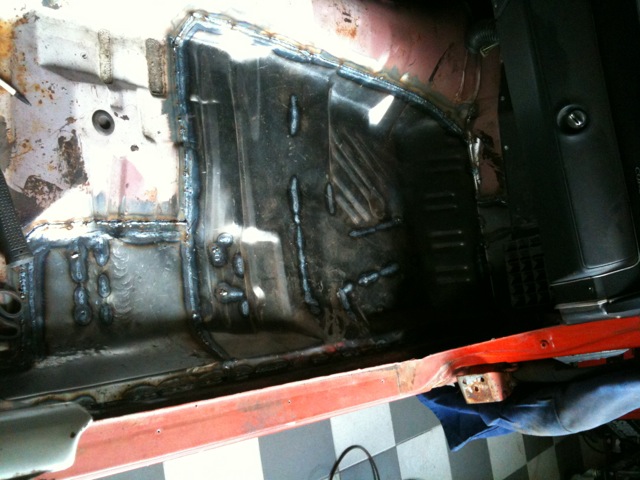

Had to lay down production due to visitors from out of town :mad:, almost done with the rust repairs:), both framerails are now in place and I only have to weld the floor on the drivers side, ran out of gas to the MIG but have a new bottle now, my Kemppi weld runs like a dream!
Will try to get the primer and topcoat on the floor next week, will grind of all old paint first, painting it black instead of body color, don´t want any body color to shine thru my black interior.
If I had knew how bad the left innerfender was I had bought a new one but the delivery time is to long for me to wait. But all the rust is now gone...

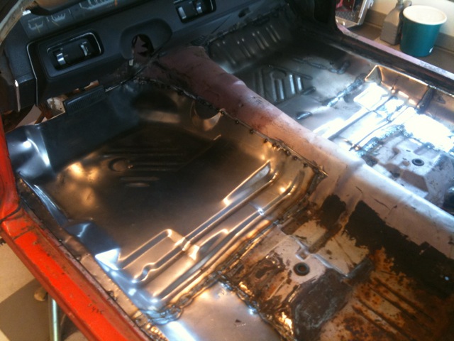

wow!The new floor looks good,was it hard to do,cause i'll have to do the same on my project?
Roger, the floor it self was not hard to replace as long there´s some steel left to weld it to, I was lucky and the rocker panels and the firewall was OK, the trick is to clean up from paint and rust. A good "spot weld drill" and a wire brush ( I use the 3M scotch brite) is half the job. If you buy two halfes of the floor you will keep the centerpiece, be careful not to remove to much of the center before you have removed the bottom of the floor, otherwise you can end up with a 1/2 inch gap when the floorpiece sits on the framerail. Better to cut two times instead... I put my floor with a overlap of 1/4 inch to the existing floor and welded it from both sides, it works on the floor. Two of my brackets to the seat was to rusty so I made a new pair, no original part but they do the work, this is not a $ 50 000 resto :)

good to know,thanks.I'm not looking for an OEM resto,i just want to get it to looking nice and driving it.

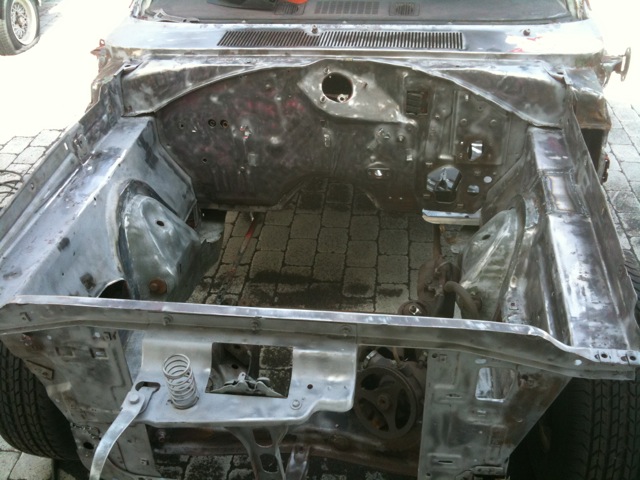

Finally home again after spending some days in Denmark, weather was ok this morning so I rolled out from the garage and took a wire brush and a small sand blaster and cleaned up the engine compartment. Getting closer to get some paint in it now, if the weather stays good tomorrow I will probably put on some epoxi primer before it is rusty again ;-)
looks good,you can't even tell where you took the old off and put on the new.

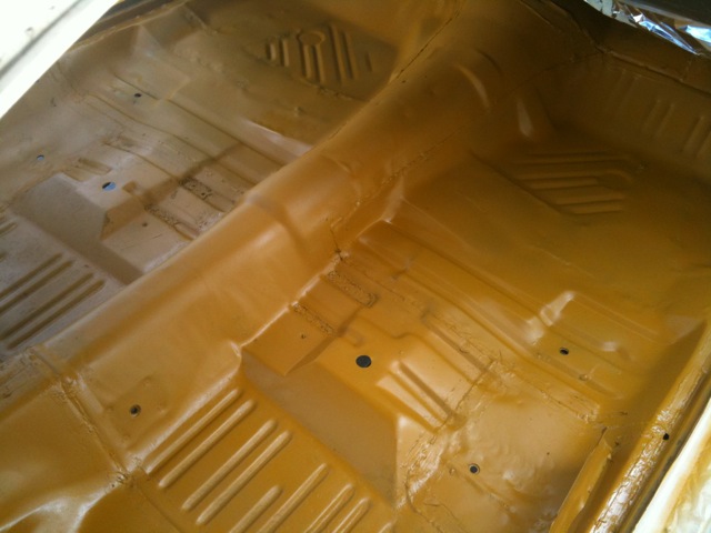

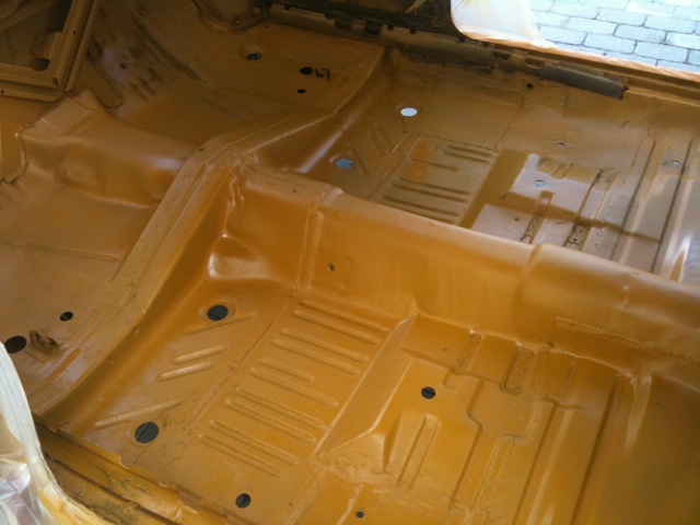

Yes! Put some primer on the floor, I know I should have waited and painted the engine compartment at the same time but I really needed to see some progress. Can take the engine compartment tomorrow;-)
