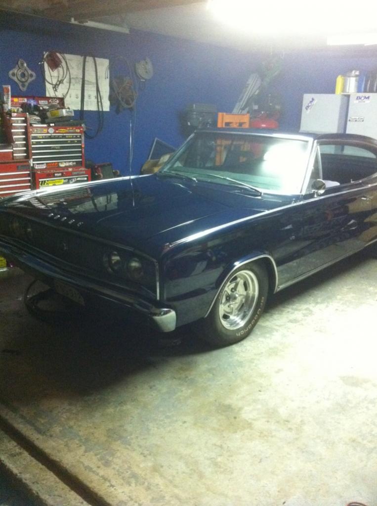

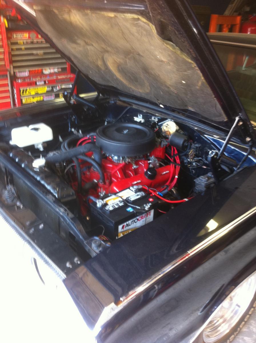

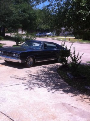

the car is a 1967 dodge charger. bare bones no option b body with a small block stroker in it currently. started life as a white exterior blue pin stripe blue interior vehicle.
currently running a 408 small block/4 speed non console drive train.
here is a current pic of the vehicle as it sits on the american racing salt flats.
the car has a set of 15x10 on the rear and its running some 295 series bfg's for now.

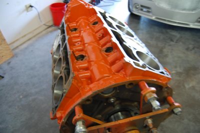

the hemi i am building is based on a 3rd generation block. 6.1 liters to be exact. which comes out to a 370 inch displacement.
the block is a slightly used block from a srt8 jeep. since i closed my shop a few years ago i have a few of these things laying around so i figure why not build it ?
the block is bored .030 for a finished bore of 4.080. the stroke is coming in at 4.080 for a square motor of 426 inches.

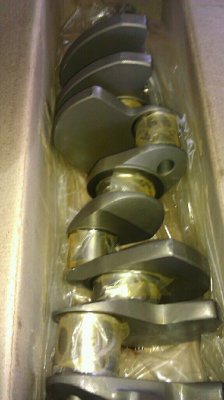

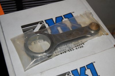

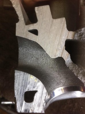

the crank is a k-1 piece and is forged. the rods are a h beam design and use a small journal chevy pin. .927 wrist pins also.

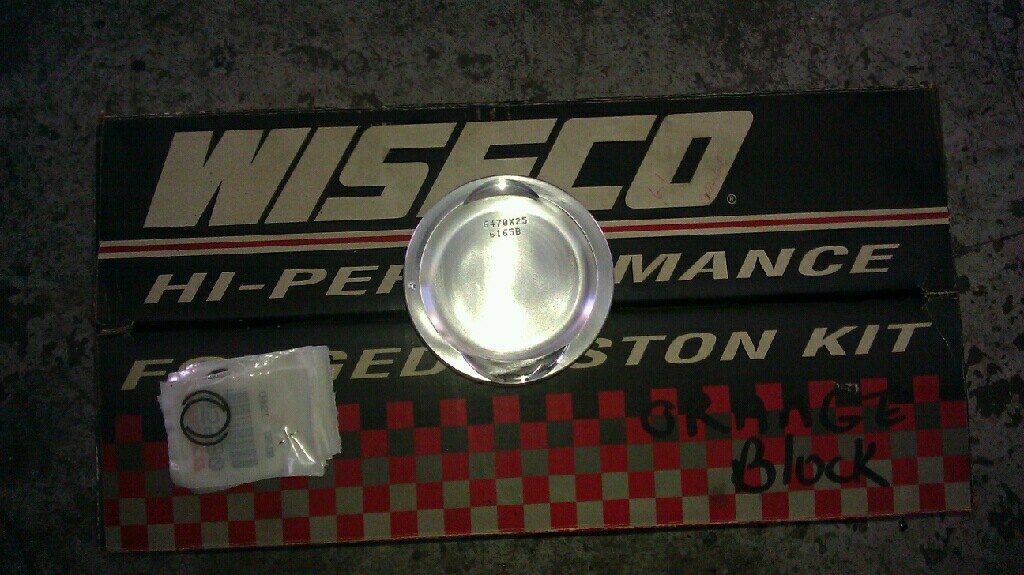

the piston i have for the combo is a 9.0:1 piston based on the stock 76cc chamber of the 6.1 hemi head.
its using a 1mm/1mm/3mm ring pack of standard tension. the piston is built for a boosted application.

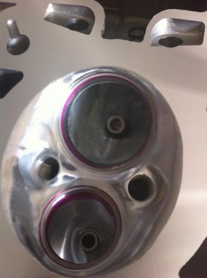

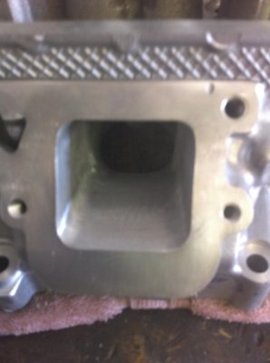

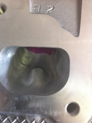

the heads i have are a set of 6.1 hemis. the heads i ported and move right at 381 peak on the intake with a exhaust peak of 230 cfm. the chamber i modified slightly to improve the airflow and to help tame any unwanted detonation.
valves are a 2.08 diameter intake one piece stainless valve. the exhaust is a 1.59 diameter stainless btw made by ferrera. the valve train consists of a PAC pacaloy beehive spring. Ti retainers coming in at a whopping 4.5 grams each in weight. stock shaft rocker system will be used.
