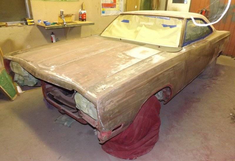

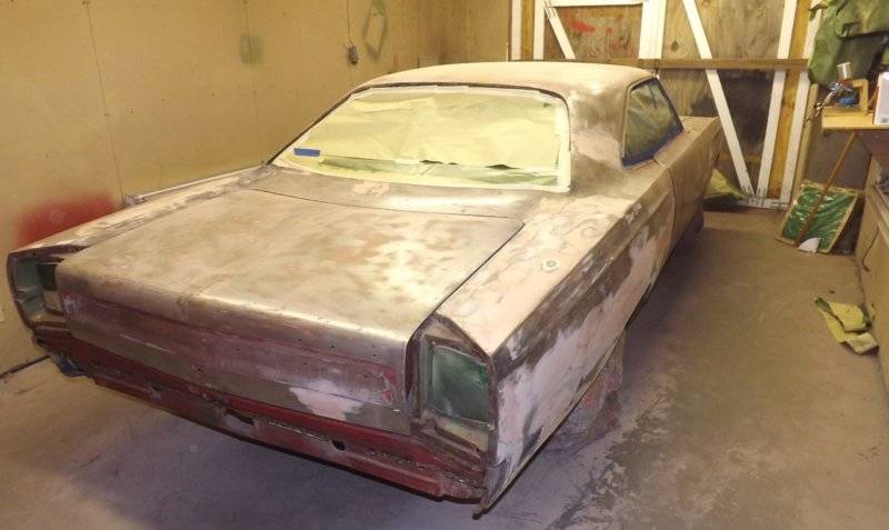

Yup Ac car. Good chassis rails and front cowl, inner fenders are spotless and the roof and windshield areas are in great shape. The car needs floors and lower quarter work plus a couple of little patches and that's it. It looks far worse than it really is.

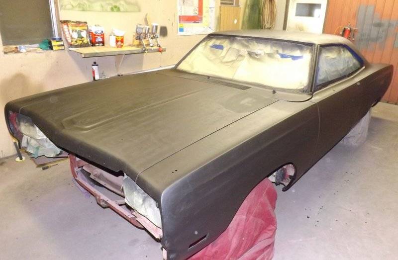

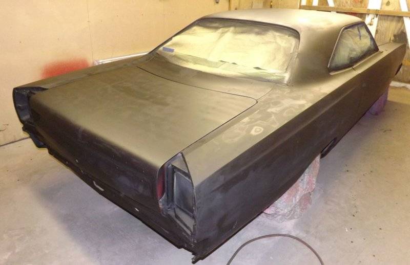

Long time since I updated this thread, but here is a bit. I ended up taking longer making the panels straight than I expected, but it is done now. I also epoxy primed it too.
Nice job! Missed you and your Fury at the cruise in last weekend. Moving out and building a new house so things have been hectic. Maybe I'll catch you at the next show.
