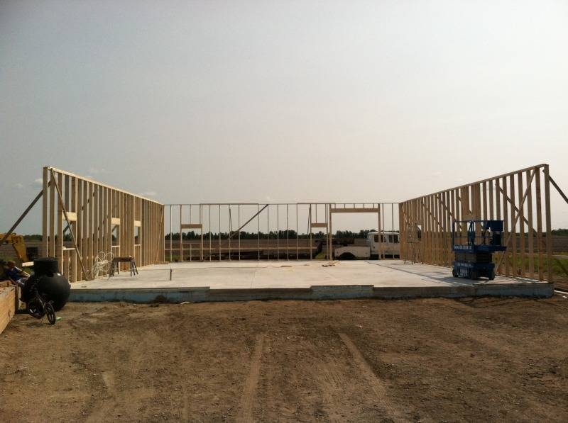

Looks like the same kind of luck I've had whenever I have someone come out to do anything!! When I did the pour for my shop (50 yards) it was in the middle of August and 98 degrees and the guy in charge wasn't here yet but the crew was along with his father in law who was from New York. The the concrete driver dropped a test slump, it landed like a kissy and I said too dry and the FIL said "it's fine, pour it" and I told him he would pay for it. Well, he did in the fact that he dropped 3 trucks right after the other and then couldn't work it. That's when his son in law finally showed up and said F#CK pretty loud. I should have told the driver to add some water to it because I'm in charge and am the one paying for it. I haven't done much concrete work but I've been around it for a lot of years starting at the age of 14 and know how it's supposed to look when you drop that first little bit to see how it looks. Yours looked kinda hot when it was poured but looked too wet when the power trowels were on it. When I did the drive way (another 50 yards), it was in the middle of winter and 38 degrees and it was way too wet right out of the truck. Had to cover a large portion with plastic to try and keep the heat in. That's the worse area. The shop floor had to be sanded because the power trowel did nothing but pull it up and then once it was dry, all it did was create dust when it was swept and I had to paint it to stop it from making dust clouds. What a freakin mess. My dream shop has a lousy floor. Thought about capping it but my dad did that to one and it cracked up. 1 1/2" cap wasn't enough I guess. I feel your pain!

Like Cranky stated in his 2 LARGE pours...
The 1st pour it was too hot (temps) and it set-up too quickly. Iit's hard to do the finnish work as it is setting quickly.
The 2nd pour it was too cold and the "mud" was a "HOT" mix...Already doomed at this point.
My resoloution?
1. I always try to have enough support for finishing the cement on time
(Cranky's drivers dumped 30 yards all at once..thats tough)
2. I accecpt the fact that it is "hit or miss" with weather, temps and winds
(wind can set it up too quickly, more so than heat)
I dont expect my concrete to come out perfect anymore...I expect spider cracks, some rough areas & flaws, period.
I know this is a comprimise but it make me feel better.
It's cement and it is not a perfect process. It's OK.

He had two trucks on the ground pretty fast and that was ok because there were enough guys on site to handle it but when I saw the 3rd truck go down, I exploded on the jerk. That's when the son in law (the boss) showed up and said WTF too and I told him to let's get this right and I would deal with him later if it wasn't right.....and it wasn't. I worked my butt off right along with them which really pissed me off because all I was supposed to do was just watch and maybe help out with the small stuff (what small stuff lol). Some of the same kind of crap happened when I remodeled my home. I ended up doing way more work than bargained for because of inept morons. Another lousy concrete experience several years ago happened when I had a patio poured......and the sky decided to open up. It's not too bad but not as nice as it should be. Today, my wife wants to build a nice patio cover and I'm reluctant to do it. Just not worth the stress anymore. Glad you're feeling better with your build, Dave....

Yup....but they do what the 'contractor' tells them to do. After unloading it and sitting in the sun for 5 minutes he had the audacity to tell me that I'd end up having a cold joint if it was left to sit for very much longer in the hot Texas August sun. Geez....kinda late now to put water to it ya think. Anyways, besides the lousy finish, it's held up pretty good considering all of that. It'll be 30 years old next month.
Top skinned over too fast, areas where the cream layer got "burned" the surface was too tight, water was still trying too bleed out but couldn't breathe through those burned spots. So, it basically blistered the cream layer loose.
Something like that.
That's basically the best theory right now and my own impression from what I've gathered.
The concrete guys are looking towards the company that supplies them with mix powder, thinking something caught them off guard with the condition or age of the powder itself that lead to a "hot mix".
These guys batch a good volume on a daily basis, they aren't what you'd call a now and then small time operation. One of the crew guys is a friend of mine, he came out to look this morning. He said he's been doing this for 20 yrs and he's only seen this happen once before.
I guess I'm just lucky as phuck huh?
Yep, from what little I know about concrete that looks like standing water on it. Probably hurried the trowel work and sealed it too soon.
Never put steel on it before it finishes bleeding.
I must have gotten real lucky with my little garage slab. Old retired fellow that pored it knew what he was doing and took his time and did it right.

My slab is fixed.
We pulled an all nighter wed night into thurs morning. We had chipped off all of the questionable surface area on the old slab, then formed for a new pour which was around 3.5' to 4". I made riser sleeves for my floor drains and installed a water closet flange extender to raise the water closet flange about 4" for the toilet.
We used steel mesh panels which were cut, fit and wired together on top of the old slab. Then we wet the old surface with a bonding agent, sprinkled on many bags of straight Portland cement powder and broomed it all together making a paste/slurry layer over the old chipped surface.
The new mix used pea rock and 3# of fiber mesh per yd. The last of the crete was in the forms at around 10 PM wed night. We did a night pour so we would have cool temps for longer finishing time.
The last power trowel was pulled from the slab at around 9:30 AM Thurs morning.
It looks really good, nice finish, nice drain slopes. I watched the entire process and helped with what ever I could. I do have confidence in this fix after watching it all happen, and I'm happy with the end result.
Now maybe we can get a damn building on this thing.

This is a new 3.5" slab over the "old" one.
Pretty extensive surface prep and bonding process, I watched the whole thing. I'm confident in it, and it finished well this time. The slopes to my drains are nice, it all looks good.
As far as the floor heat, more mass means 2 things. Slower reacting to the thermostat, but... More "storage" of heat which is a bonus to me since our electrical rate is discounted because they can turn my boiler off when the elect company is having a hard time fulfilling customer demand. That's how it works up here. You invest in a heating system that can store heat for sustained periods of time, that way you don't even realize it when they have cut your power. My boiler will be on a separate meter that the power company can control remotely. It will not effect my shop power, my lights will still work, air compressor, welder etc, it's just the boiler that they control. We're on our second home that is heated with this system and it works very well in homes. We have one winter under our belt in our new home that uses floor heat, previous to that we have 12 winters experience in another home that used floor heat. Both were set up the same way, separate meters for heating system which the power company can shut off to help divert power to other customers under high demand periods. The kilowatt rate is drastically reduced, it's a nice way to go in my opinion.
The building starts going up on Wed this week.
