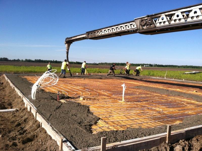

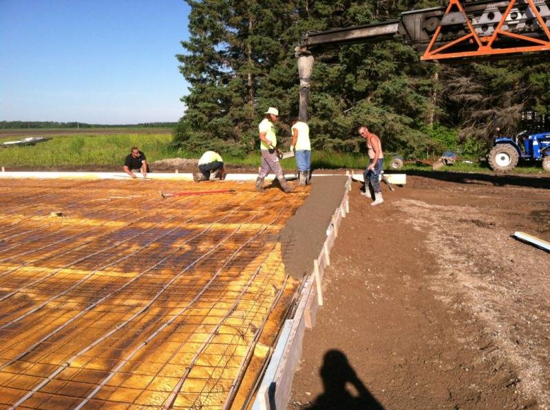

The crew started the pour with the edges where the slab is thicker.
they used a boom truck with a remote telescoping belt that fed the concrete out to a drop chute. The owner of the truck walked around the outside of the pour and controlled exactly where the mix was dropping in. He had a wireless remote on his belt that controlled the swing, extension, feed rate, height etc. He also has an alarm button to signal to the concrete truck when to stop and start feeding the boom truck with each load of concrete that came.

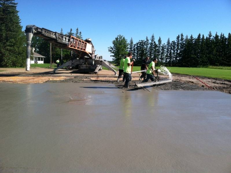

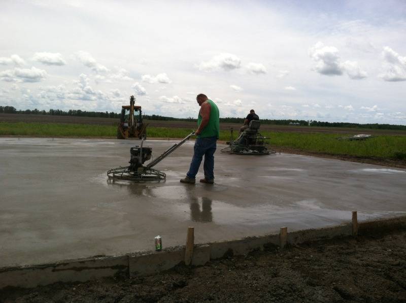

Partial pour complete here, screeding with a 12' vibratory screed.

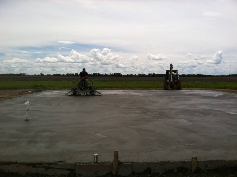

A couple of power trowels are finishing the top here.

Trouble with my slab. The finish is messed up. It's very patchy with loose flaky areas.

Top skinned over too fast, areas where the cream layer got "burned" the surface was too tight, water was still trying too bleed out but couldn't breathe through those burned spots. So, it basically blistered the cream layer loose.
Something like that.
That's basically the best theory right now and my own impression from what I've gathered.
The concrete guys are looking towards the company that supplies them with mix powder, thinking something caught them off guard with the condition or age of the powder itself that lead to a "hot mix".
