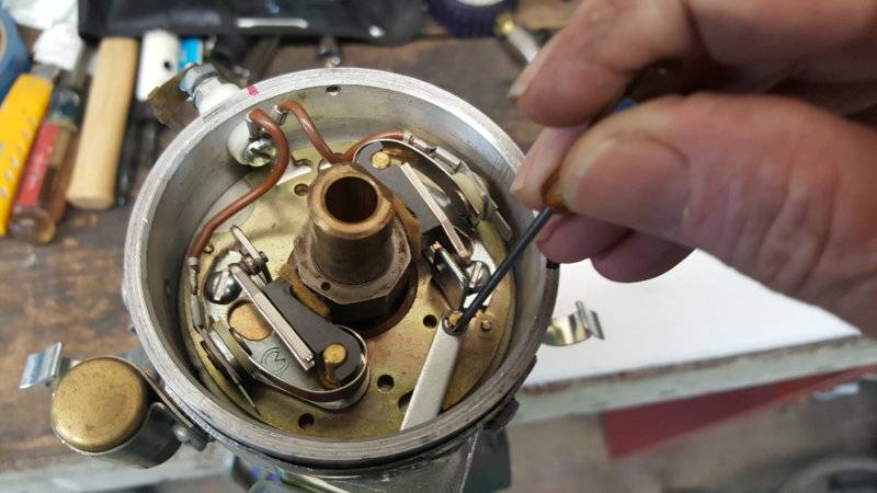

Here's the way the Mallory is set up.
Presolites the pigtail from coil has a wire that goes one set of points then to the second set. Just somebody cut it off or put a single point pigtail, this is a long shot but put out there.
