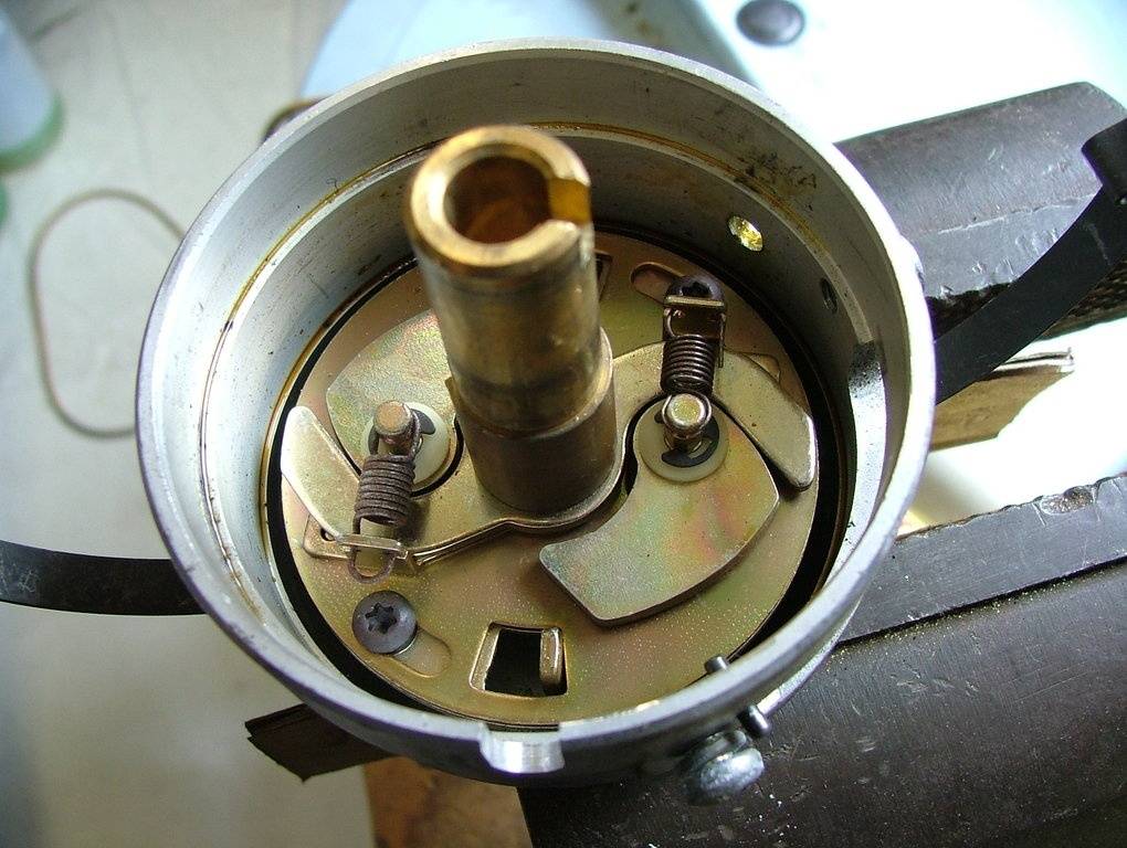

Thanks. Just to make it clear I have the later style MP distributor with the small advance weights and adjustable limit plate, the FBO plate doesn't work with that. Today I pulled off the reluctor and pickup plate, here is a pic of what I have. As I suspected it looks like I have the wide open limit setting, one lighter direct acting spring and one heavier spring that has clearance so it kicks in later. This is supposed be a "performance" curve, does anyone know what the stock specs were for these conversion distributors?

I'd suggest keeping the springs, until you get farther along, until shown you want a change in the advance 'rate'. That's exactly what the springs control...the rate, or timing of the advance.
It's been a long time, though I've used about the same light/heavy combo, but on a Mallory dual point, mechanical advance. Just a pairing, or mixing, of the springs to set the advance rate you want.

OK that helps, mine is currently about the same, that would mean the "stock" setting is around 24 degrees in the distributor. Is a total mechanical setting of 36 degrees considered the max?

No Don it would be pretty darn good, you only need another 8* initial at idle and you've got 36*. Then it's only how quick that 26-28 comes in. For the street it seems pretty good the way it comes.
