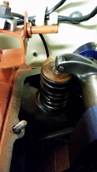

So I finally found the correct part number for the o rings that go into the Milodon spark plug tube adapter seals. So out to the garage to put things back together. This is what I find. Like I originally stated the engine sounded loud on the passenger bank. Yet I found this broken spring on cylinder 7 drivers bank. ??

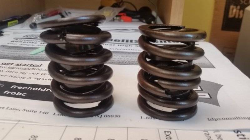

So I ended up with 2 broken intake valve springs, concerned as to why they would break in the first place. Went over the valve adjustment numerous times before buttoning everything up. Started right up, now the unusual noises I had are gone but on the side that the valve spring kind of overlapped itself it sounds like I missed the adjustment and ticks louder than the rest. Solid lifters, I checked for coil bind, no bent push rods and I'm quite sure the adjustment is correct. Being that the spring broke and was overlapping itself I keep thinking it must have been coil binding each time that valve opened. Could anything happen to the internals of a solid lifter to make noise? Any ideas?
I’d be more concerned if the valves kissed each other or a piston with the broken springs. May be in you best interest to do a leak down
I agree. I would do a leak down check.
I get the common sense to do that, but would it account for the louder ticking in the area where the badly broken spring was?
Fyi there is no misfire, runs very strong.
Is it still ticking after fixing broken springs?
It's sounds as if I left a valve or 2 a little loose on the lash adjustment. But I'm 99 percent sure I did not I checked multiple times.
Got the right springs?
You can bore a scope that cylinder to see if you dinged a piston.
That of course would not be your noise.
The springs that I bought the car with are single spring with damper, wire size is about .220
