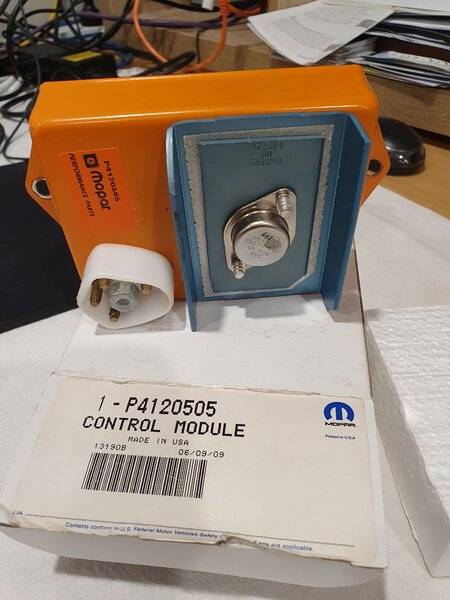

I know this is not a WTB Advertisement, but I just happen to have a brand new one of those Orange boxes on my desk right now. Dated 06/09/09, Made in USA, #P4120505
If no-one is able to hook you up, and two weeks is no issue, I could send this one over to you.

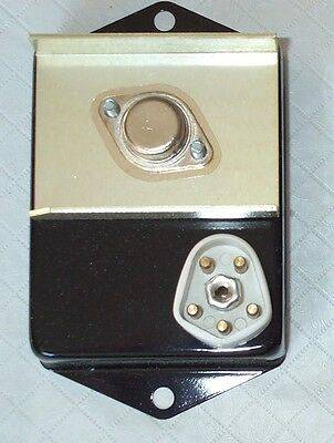

I have some tested used and tested new boxes, have to get some pics, nothing new NORS. Here is what may help you ID what you want.

We got into this pretty hard on FABO. We have a member retrofitting them with 4 pin GM hei's and was pretty surprising what differences there are inside. Some have just a chip, quite a few have false transistors on the front, bad potting material that let moisture in etc. The older Mopar ones are pretty consistent. Big clue is what is on printed on the transistor itself. RCA and Motorola and Prestolite I believe are real ones. Any thing else either false or junk.
