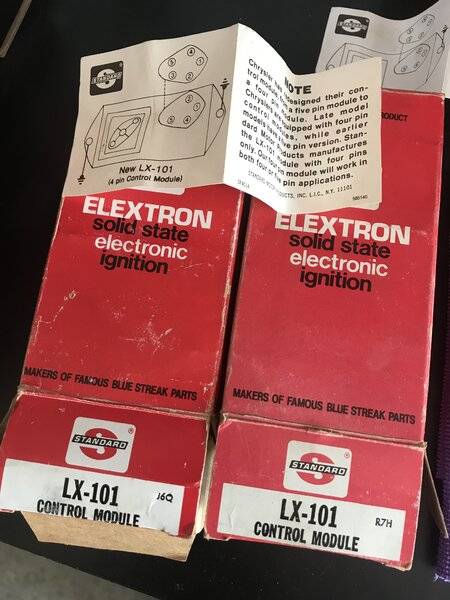

I have new original 1975 Electronic CU for sale I can get a photo of it for you.

If you have a part # on the box ?
And a price
Thanx

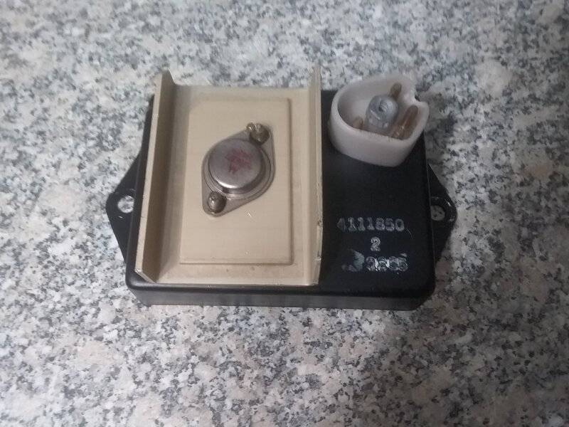

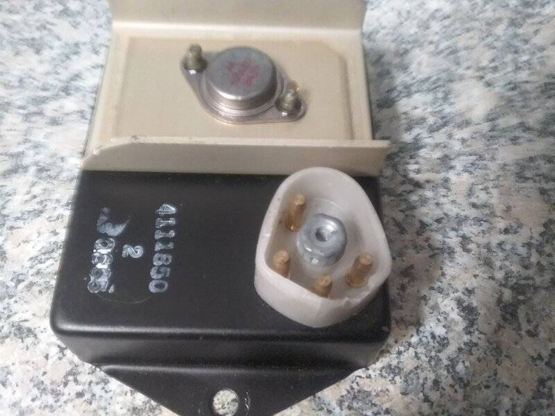

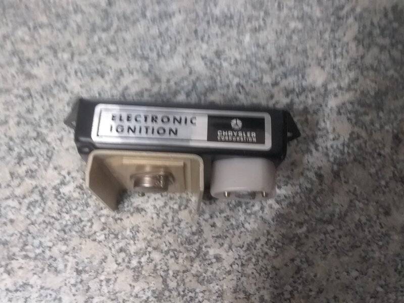

Another
I would assume some kind of service replacement for dealers

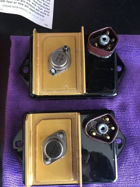

Don't fail? You tell me! 3 Chromed boxes in a row in 2 years! LOL
I've heard the chrome boxes were race only and would get too hot and fail with normal use. I have orange boxes in 3 vehicles and have had no issues. Guess I'd better knock on wood huh? On another note, I make sure they are properly grounded. (less than .3 ohms)

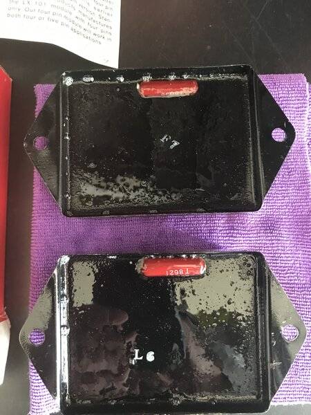

Picked these up for $6.00 and $13.00
Brand new old stock never mounted

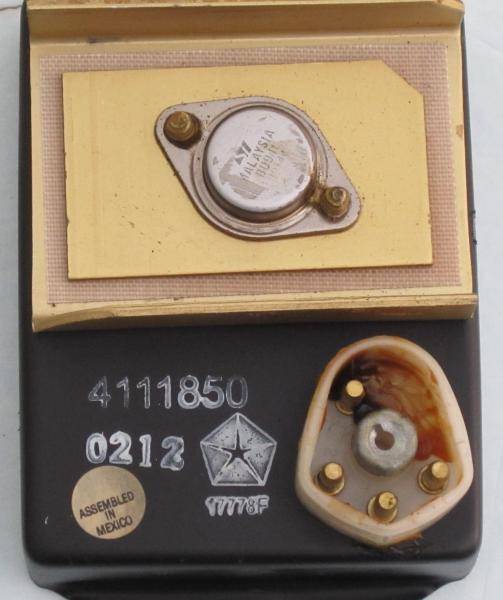

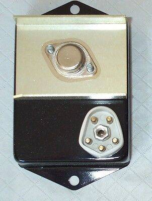

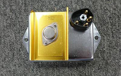

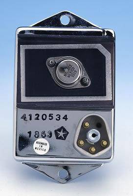

We got into this pretty hard on FABO. We have a member retrofitting them with 4 pin GM hei's and was pretty surprising what differences there are inside. Some have just a chip, quite a few have false transistors on the front, bad potting material that let moisture in etc. The older Mopar ones are pretty consistent. Big clue is what is on printed on the transistor itself. RCA and Motorola and Prestolite I believe are real ones. Any thing else either false or junk.
View attachment 986854View attachment 986855View attachment 986852View attachment 986856
