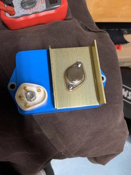

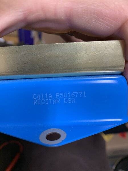

Just picked up a blue box from summit, rated at 5500 $30. Thinking all my issues are due to that dam mopar ecu. Says USA on it but not made in.....we’ll see.
90DC2951-100C-4824-9B55-A01D66E41776.jpeg 5AEF4AE5-DC06-487E-A3A3-A4CFA08AFE8C.jpeg
I have gotten blue boxes that the harness won't go on because the plastic surround is too thick.
