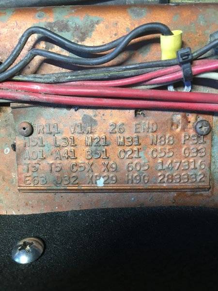

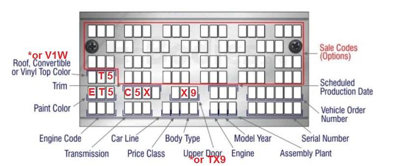

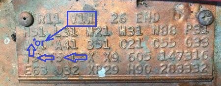

In the actual tag shown (2 characters/2 positions for paint), it is normal for 1969. The "missing" first character of the paint code (
xT5) is somewhat irrelevant as it refers to the model-year that particular color was first developed for (example below). The 3-digit paint/4-digit interior tag coding is as
@69Coronetrt states - not until 1970; that decoder you show really isn't appropriate for 1969, and prior to '69, the tags are
completely different.
If this tag/car had more options, there
would be a 6th (top) line, but 5 lines was enough to code how this car was to be built. And if 6 lines aren't enough for a car's option codes (the ones that even GO on these tags), a second tag is added with the codes that didn't fit on the first tag.
