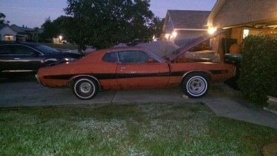

New 73 rallye 440 owner here : D
View attachment 339405 View attachment 339406 View attachment 339407
And down the rabbit hole I go....

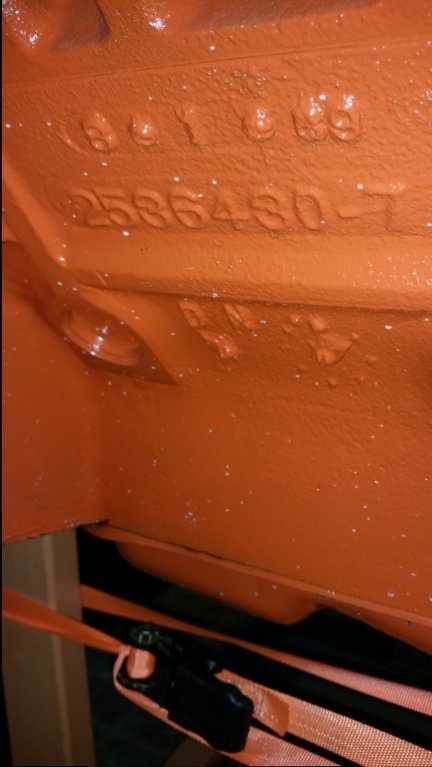

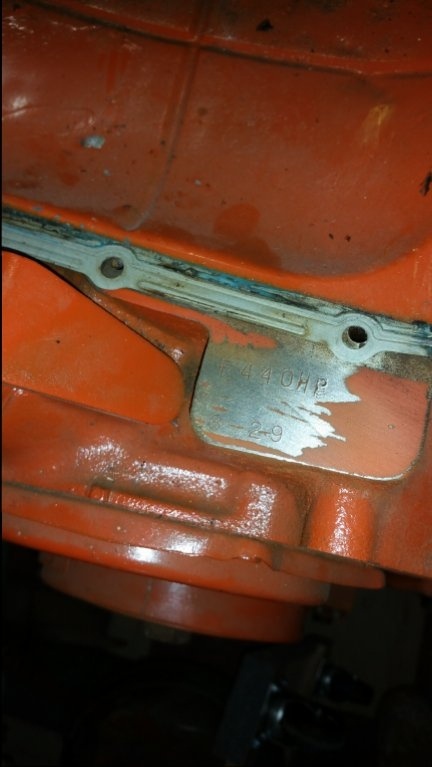

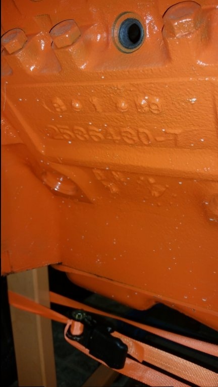

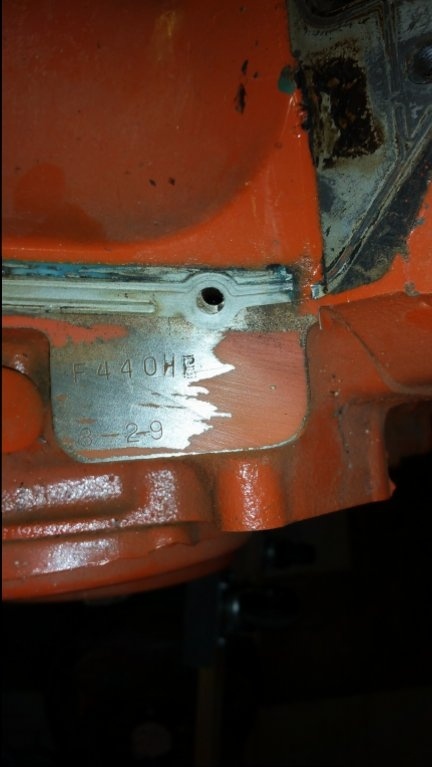

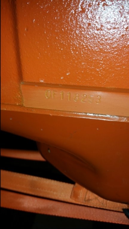

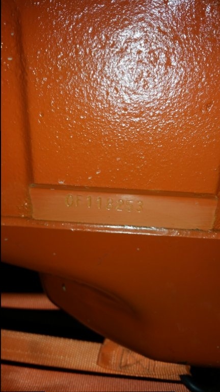

Now the engine, the engine that came with the car is
1969 440 supposedly from a super bee,
The VIN on the block starts with 0F. The "0" indicates a 1970 model year car. The F indicates the Newark plant, which built full size Dodge and Plymouths so the block is out of a 1970 C body.
The A13 on the tag indicates the scheduled production date of October 13, 1972.
Ok , thanks for the info ..
