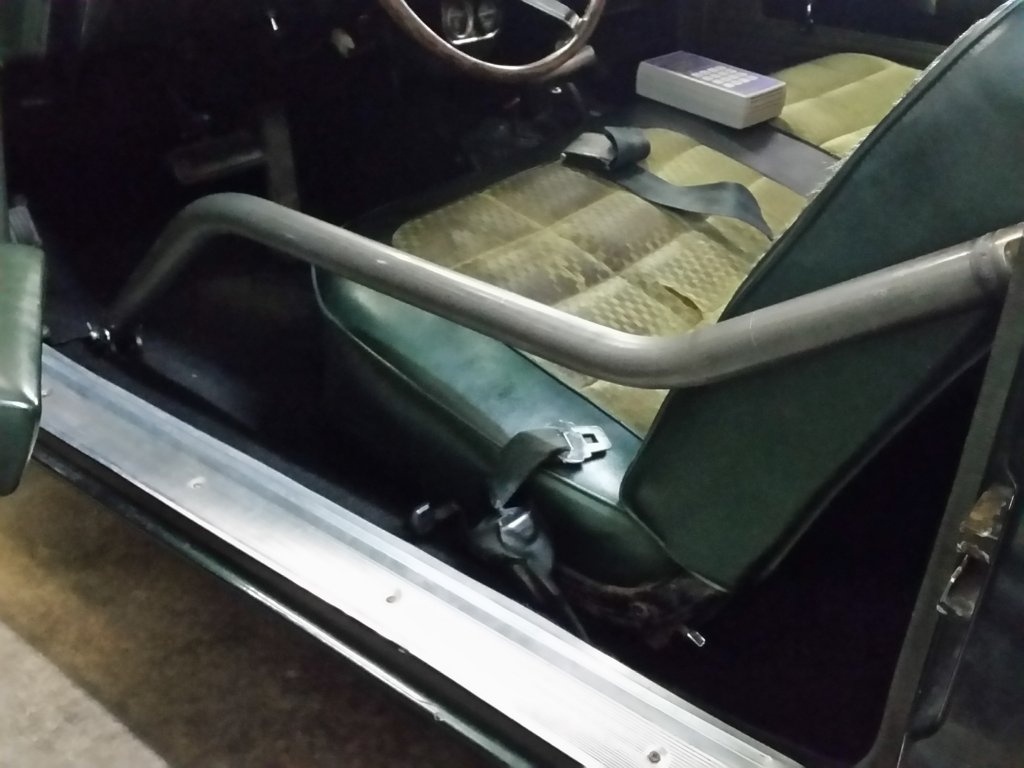

They did a really nice job on that bar. That's how I would want my side bars to be bent if I do go that route .

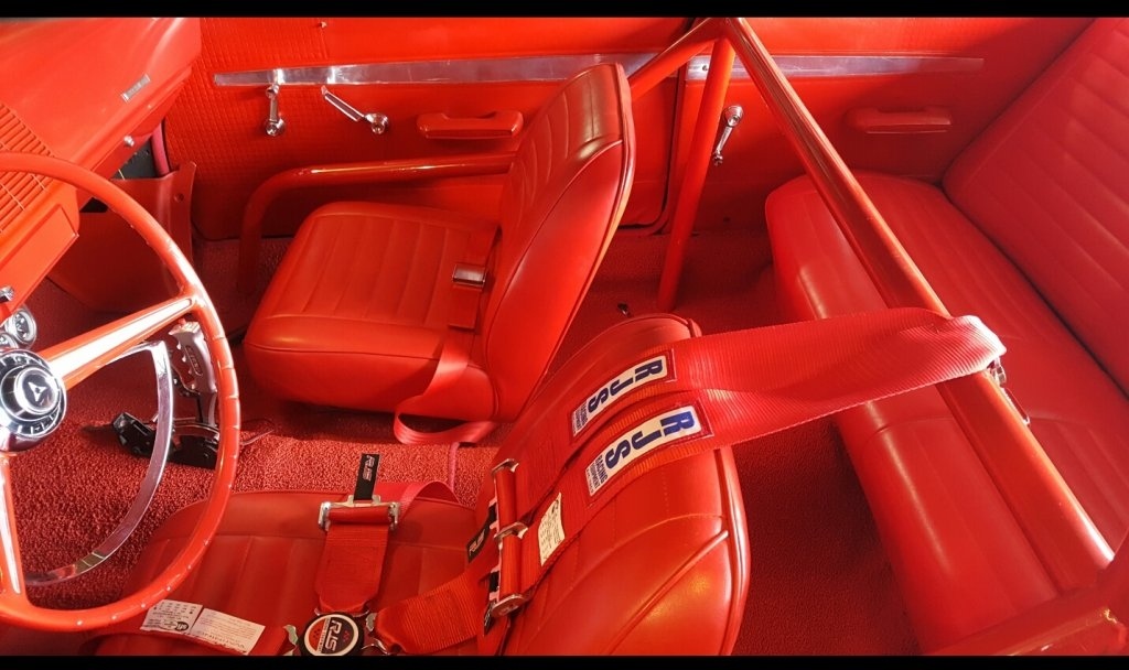

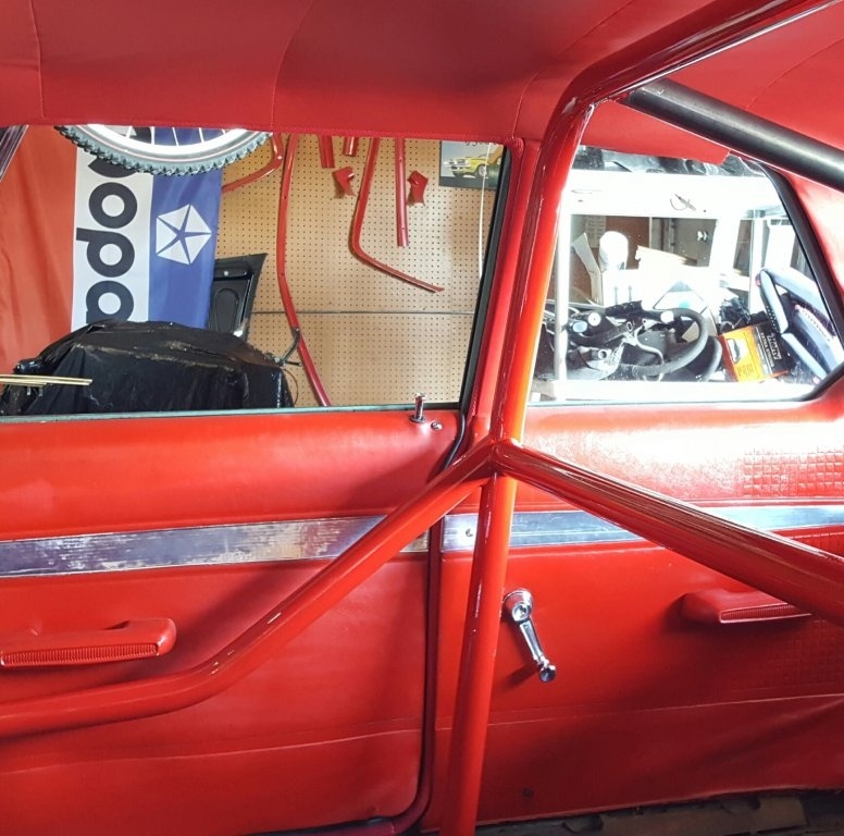

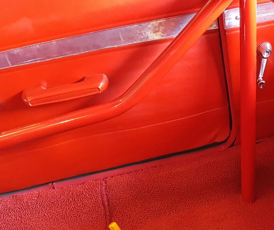

I wrestled with this as well as I drive mine often. I finally gave in this winter. I just finished painting it and re-installing the interior. I actually enjoy driving it in traffic as I now have a 5 pt. harness and feel much safer should I get in an accident. The shop that did it did a great job in accommodating the fact that it is primarily a street car.
Painting it red helps it "blend in" as does the fact they installed the main hoop to perfectly match the angle of the B pillar.

That bar is t!ts.

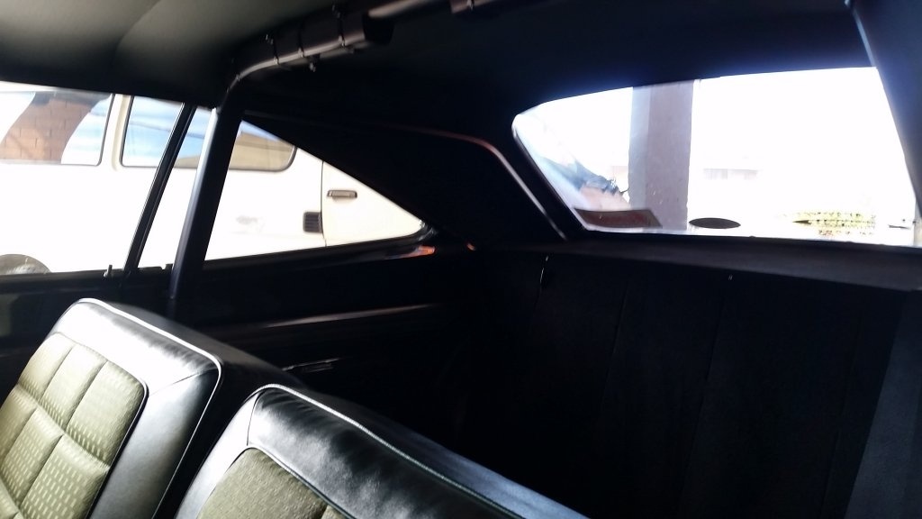

Some of mine . Chromolly .
Door bar and taxi bar is removable . Uses clevis fittings and 1/2" pins

nice setup Tex

Here are a couple of shots of the bar before the interior went in.
View attachment 411414 View attachment 411415
That's a nice doable setup too...
looks great
If I do it, it will definitely be custom fit. And I like what I see in some of thes pictures! Tex, when you say "taxi-bar", are you talking about the main hoop cross support. If so, I'm pretty sure that is not NHRA legal. That bar must be welded. Nice looking fit, for sure, though. I'd like to see more pictures of it.

Yes cross bar , not sure its NHRA legal either - but here in Australia it is teched . Same fittings as Chris Alston sells . BUT since then they have changed rules 3 times in 6-8 months. Though it is welded in hoop and back stays they want to call it a removable cage ? #uckers , especially as head of tech @ ANDRA (NHRA equivalent) said was good to go
But that's another battle
Also here in Aust you cannot have a fixed side bar in a street registered car . Fixed taxi bar in coupe means no rear passengers . Not enough head clearance so no back seat now .

Hate to say it but that side bar isn't legal, nor is it strong. No tube on the oppsite side of the bend. Rules state it must pass between your shoulder and elbow while in the driving position. Removable shoulder bar is also illegal. Tech may not catch it. Then again you may make a 6 hr tow some where and get turned away.
