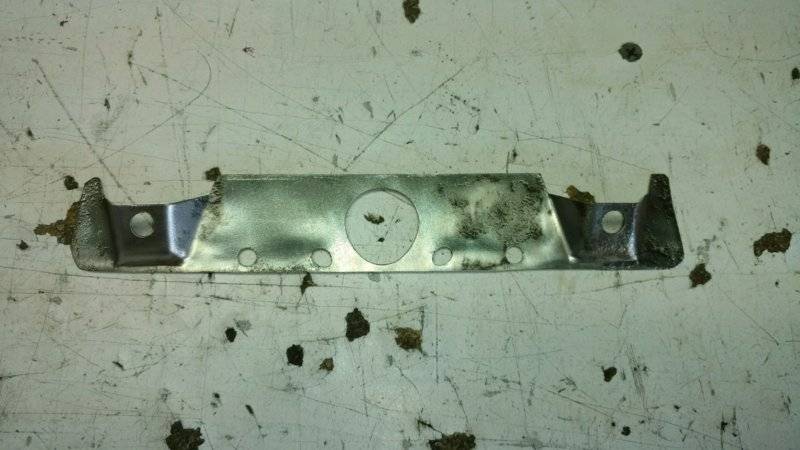

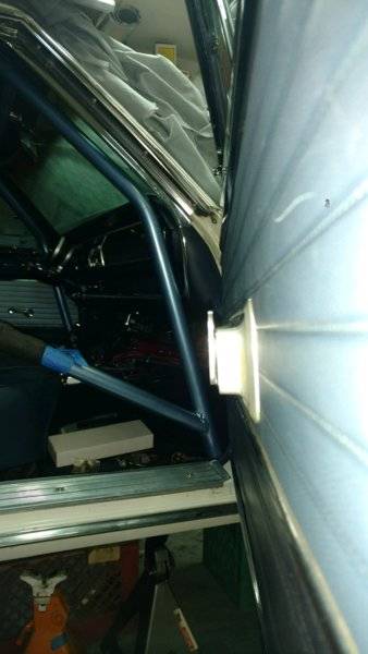

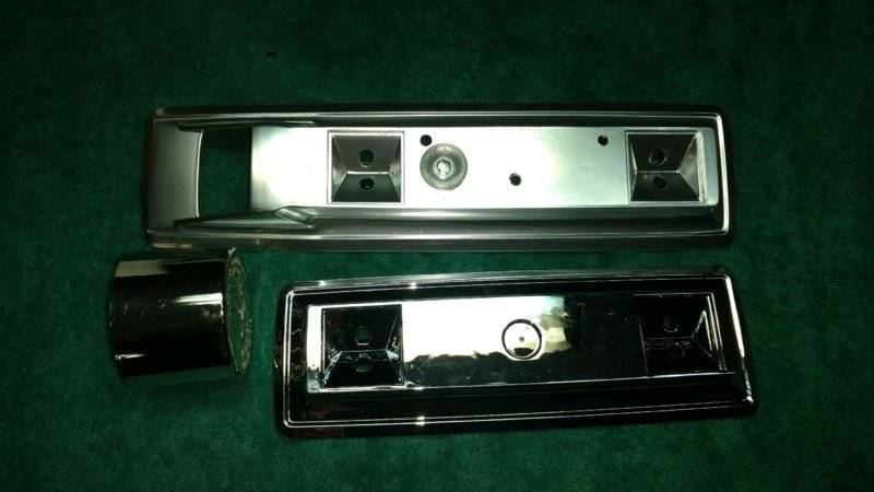

6 weeks and counting at the second machine shop so been working on something else that always bugged me. The door bars of the roll cage interfere with the door arm rest pads so I had to remove them. I just screwed the bases to the door by themselves but there is nothing to grab to shut the door.

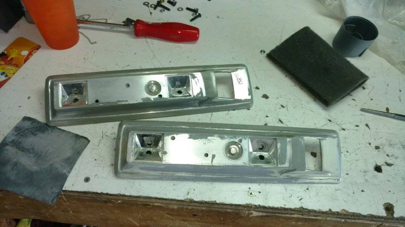

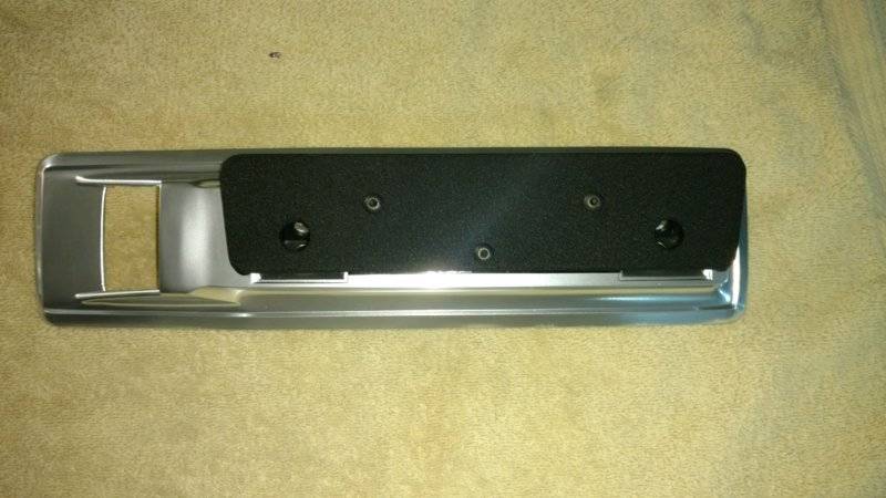

I got some crusty arm rest pads from a fellow FBBO member, he stripped the foam off 'em before he shipped 'em. I cleaned and trimmed them down.

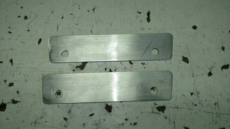

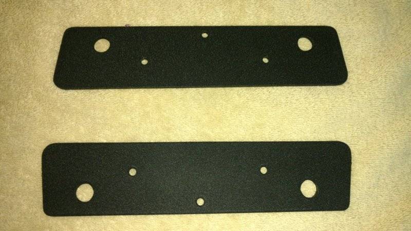

I made some plates out of aluminum that share the same silhouette as the arm rest pads. The plates will attach to the bases with the trimmed arm rest pad base sandwiched in between it and the plastic base.
My original bases were bad off, I bought some chrome paint and sprayed them - not quite chrome (compared to the cap and a new repro base) but good enough for the Brick.
I wanted to paint the plates Navy Blue Wrinkle finish but could not find any so I settled on black.
Finished product - now as you can see from the right pic there is something to grab onto when closing the door instead of the window crank or wind wing latch!

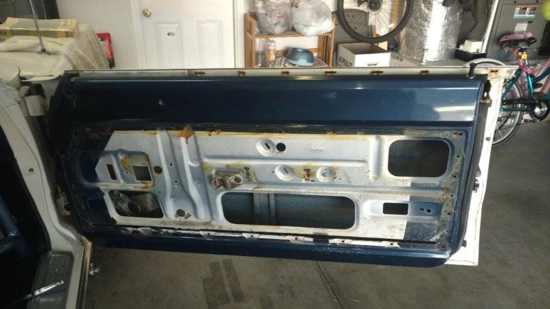

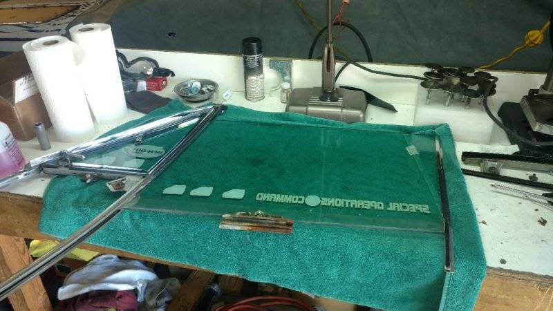

blew passenger door apart, vacuumed, cleaned, & waxed the paint on inside of door. The car still had white overspray on the blue paint some 54 years later. I was able to get it off.
clean & prep window -

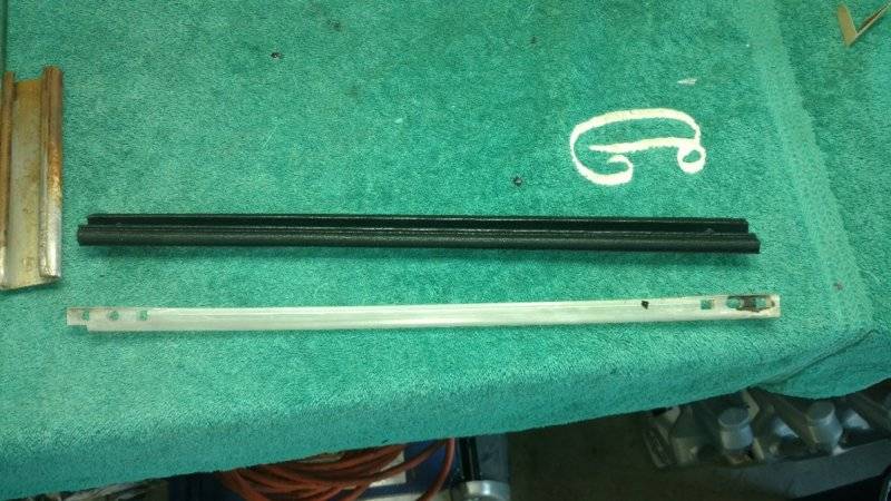

New window glides - very different from the originals and tight in the channel - hopefully not too tight. Had some other issues with the cat whiskers too . . . it's always something.

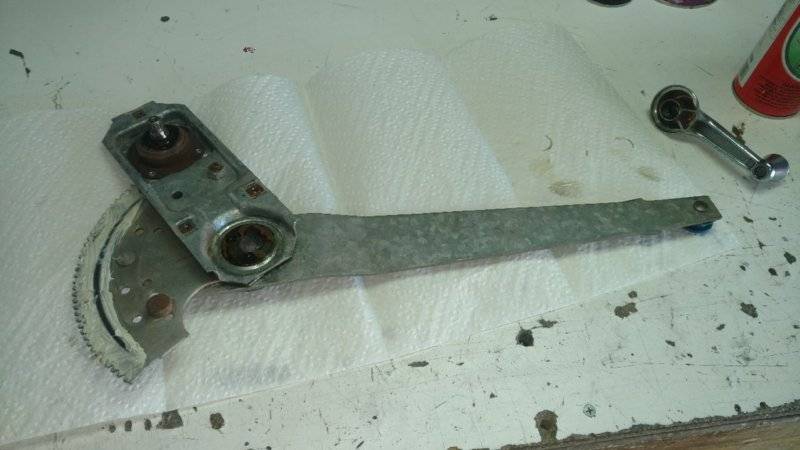

Cleaned & lubed up the regulator

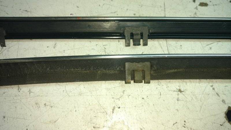

Well, the inner door cat whiskers don't fit right - the clips were attached too low on the part - I was hoping to finish this up today but it seems something always goes sideways . . . upper new, lower original.
Here it is installed - sits way too high. Time to call the supplier and have it out . . .

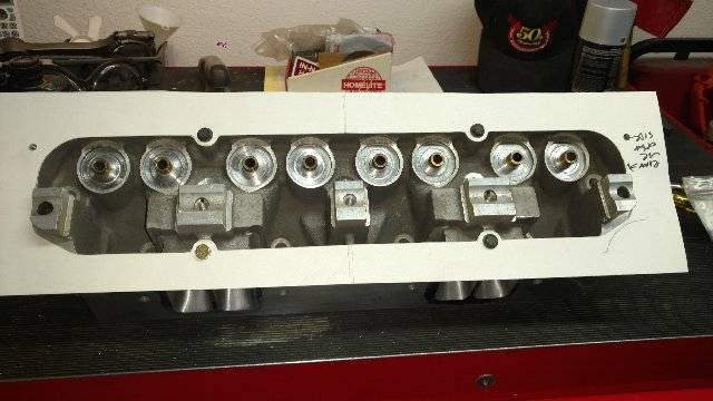

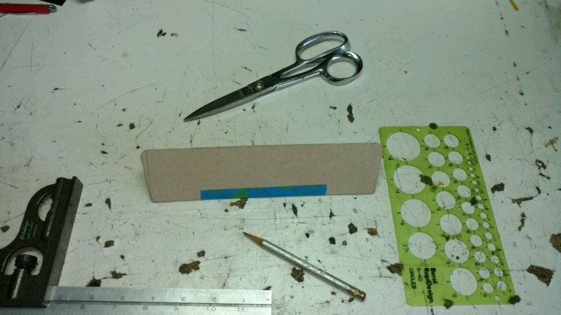

Got the heads back to my cylinder head guy to finish them up. Also the machine shop called with an update - block is finally in the machine for line bore, then sguare the deck and deck height measurement so I can order pistons. I'm having some valve cover spacers custom made, they will be 1/2 tall and seal with o-rings so no valve cover gaskets! Here are pics of me test fitting the templates, some adjustments were needed.

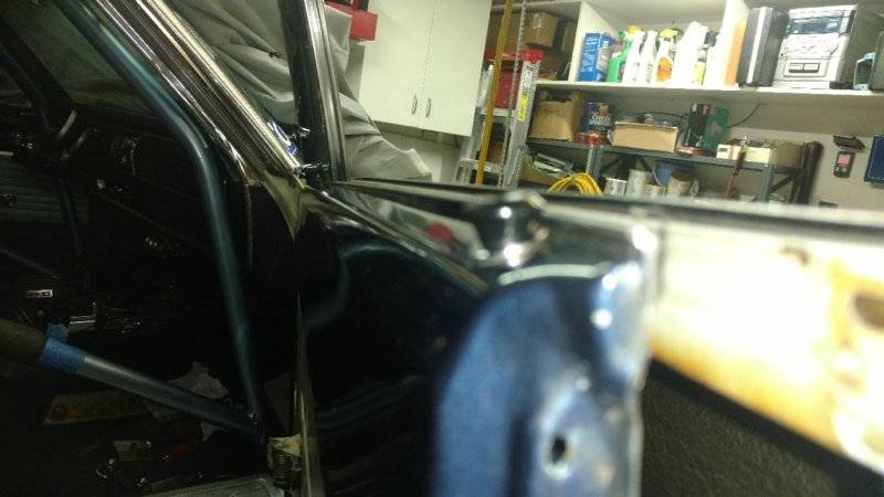

Can you snap a pic of your a pillar bar beside the glove box? My bar is in the way, so I can't open the glove box door. I'll probably have to push out the bar some.
