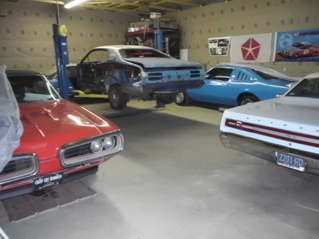

here's what will be my shop eventually when Pops quits Traveling, I let him keep the RV & boat in there right now... I will concrete the whole area after digging down 6-8 inches, installing plumbing & electrical trenches & add conduit or pipe, it's sitting on 12"x 8' deep concrete pillars, with anchors & a concrete reinforced wall, I will fill in the sides,backs & install a 10'x10' & 12'x12' roll up doors 28' wide x 42' deep, 14' tall at the peak, absolute biggest I could go... it will be allot better than my tiny 20'x 20' I have now, I had a 64k sq ft warehouse @ one time that was really nice... downsizing sucks
Lots of lighting, parts washer, retractable air hose & electrical reals, lots of air & electrical outlets 220 & 110vt, 60 gal. compressor, a urinal in the back...LOL... a 4 post lift, a overhead chain hoist/crane, benches all over & storage off the floor everywhere, the smaller side will have a retractable curtain & filtered ventilation, for painting & assembling parts/engines, kind of a poor-mans paint booth & clean room combined, stainless steel counter tops, heating & A/C...
