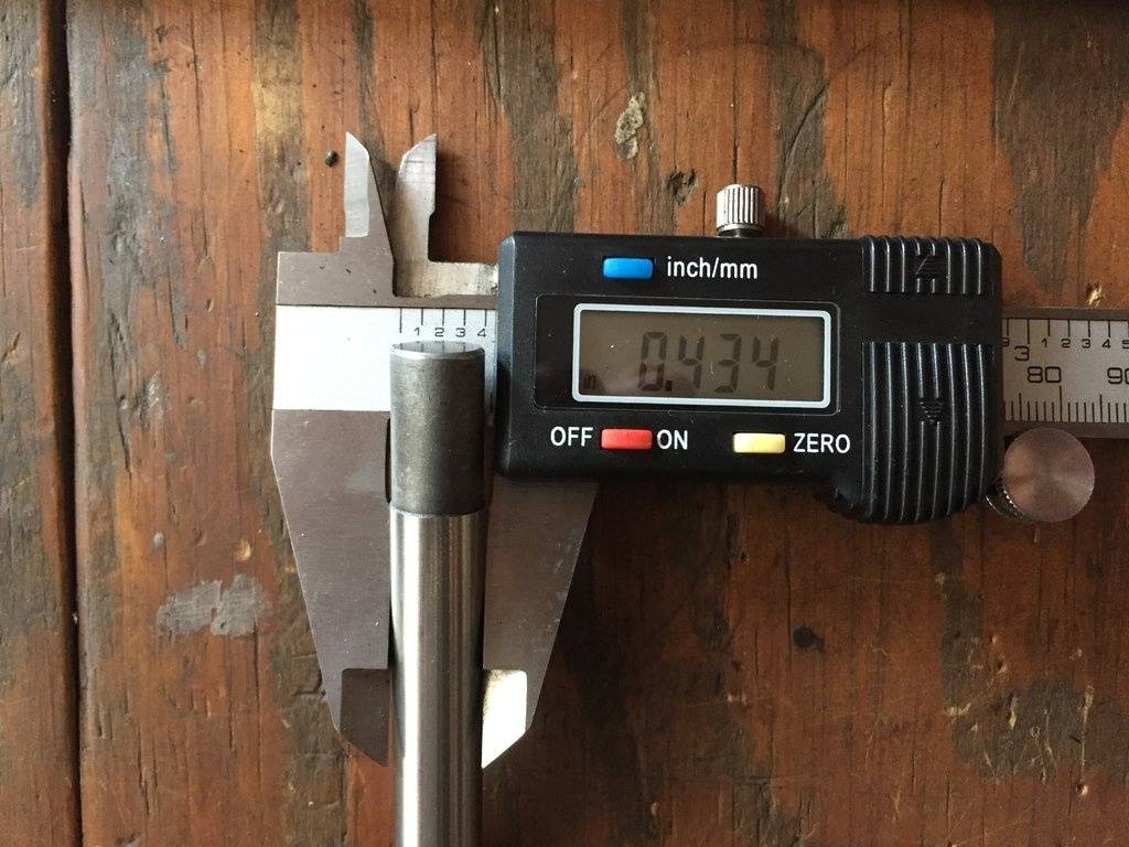

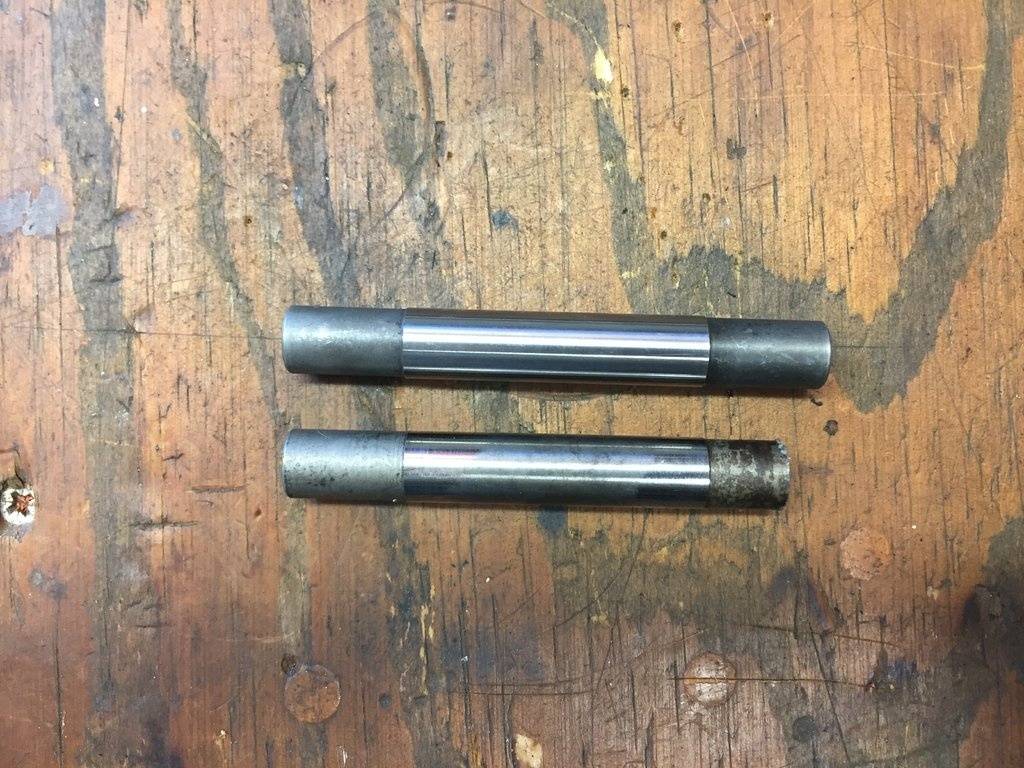

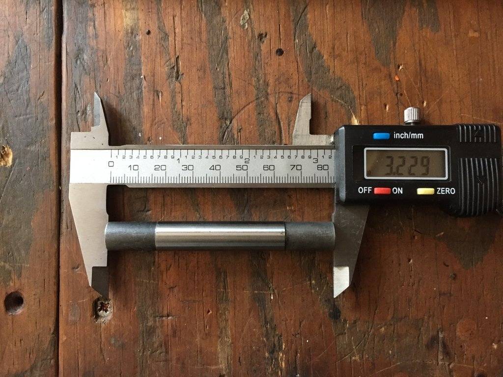

Pretty unexpected, but i already received the NOS push rod i bought off Ebay.
Weird, sometimes is so fast and sometimes takes forever.
Anyway see the pictures, measurements are good and looks like new and unused so was as advertised.:thumbsup:
Maybe stupid question, but this push rod can go in either way right?
I test fitted it and moves nice and smooth in the bore.
Plan was to use the other (non NOS) rods but they are just send so might take another week to get here.
This was holding me up with the work so guess i will use this instead for now.
Maybe later i can still change it out for the other ones.
As i have a precise measurement i can compare it's length after a few miles and see if there really is excessive wear happening.

Glad you got the nos one I linked for you, make sure you use assembly lube on the ends when you install it.
Some lube on the shaft will help hold it in place to install the pump, also turn over engine so the eccentric lets the rod go up all the way, makes install easier.

I've pulled the push rod again today to check it's condition.
Done around 40-50 miles on it and found it was 0.002" shorter then before, so guess that is break-in wear.
Looks like the push rod is rotating during operation as well so it's "wearing" evenly and the camshaft end of the rod was very smooth.
I will do the same again after maybe 150-200 miles, at that time i guess will pull the distributor as well and check the camshaft for any potential horror occurring there.

....and, judging from your pictures, the point of contact on your cam appears to be recessed vs. the un-worn portion of the cam lobe.
Time for a new cam as you're down beyond the case hardening on the cam.
