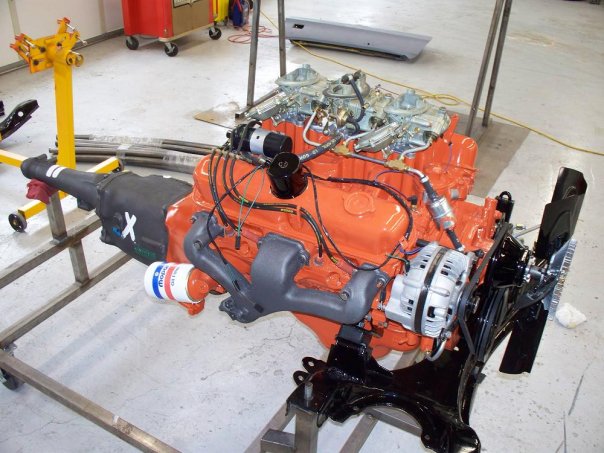

I found this on Facebook about that "Graveyard Carz" show. It's a 340 6-pak for a Challanger T/A
they resurrected. I don't think the black for the pullies, k-frame, and breather are correct. Not the
plug wires, I think they were orange in color.
Here is a picture of the drivetrain for the Challenger T/A just prior to installation. Note the colorful assembly
line markings, original squeeze clamps on the fuel lines, correct Hemi Orange paint, date coded hoses and
belts, original date coded spark plug wires. This is a great example of the rewarding feeling that comes from
a job well done.
I'm not trying to bash on Chip, he does some great Custom work and he is a Super Nice Guy, ...just his work for the most part doesn't impress me much, the level of work he performs is Awesome, he just goes in the wrong direction for me, ...I'm big on Originality.
Im with you there on being original and keeping it that way. I think its great if you doing a Hot Rod and maybe modding some of the new stuff like he does.

The orange spark plug wires didn't start showing up on the assembly line until late 71 and only on electronic ignition cars. The black paint on the pulleys, k member, torsion bars, breather cap, etc...was a 60-75% gloss. I use a full gloss on a car that will be driven to make clean up easy at car shows. Semi gloss paint tends to stain and mar easier.
