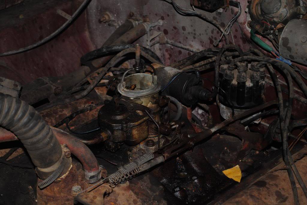

I bought a 66 Coronet 440 2dr; 318 engine. I have searched the forums and I am still lost. I am doing a frame-off restoration so I am not in any hurry, but I do want to be prepared. The PO said the motor will need to be rebuilt. The motor does turn over, but I think the coil is bad, so I don't know how bad the motor really is. After doing some reading, I think it is a "Poly" engine, it is very wide across the top end. "If" the motor needs to be rebuilt, would it be cheaper to rebuild my motor back to stock if possible, or look for a bigger motor to put back in it when I get to that point. Any information on the Poly would be appreciated. The PO said it is the original motor that came in the car, but I have not had a chance to look at the numbers. I don't plan on racing the car, but I would like to "go fast" when I want to. Also, it appears that finding headers, reasonably priced, will be hard.

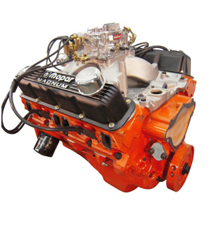

INDY CYLINDER HEAD....
$4,995.00
Chrysler 360 LA and Magnum Small Block Engines
All Engines Blueprinted, Assembled and Dyno Tested At Indy Cylinder Head
Make plans to visit us and watch your engine run on the dyno!
360 Magnum With Indy MA-X Cast Iron Heads
**** Your Best Value Under $5,000.00! ****
PRINT OUT ENGINE DETAILS
380 Horsepower @5500 RPM
415 Torque @3200 RPM
Engine ran with Brad Penn 30WT break in oil
Fully prepped 360 Magnum block
4.020 bore--3.58 stroke
Eagle SIR rods
Speed Pro Hyper Pistons As pictured
Coated shirts--9.5 to 1 $4,995.00
New Indy MA-X cast iron heads
1.920 / 1.625--5/16 stem valves
Hydraulic roller cam
.467 / .482--208 / 216--HR113 Included for $65 with complete engine:
M.P. black Magnum valve covers Orange control box
M.P. Single plane intake Wiring harness-resistor
600 CFM Edelbrock carb M.P. 8 blade water pump
LA timing cover-Mechanical fuel pump OK
Stock 360 5 quart oil pan
M.P. Electronic distribuitor--curve set
ICH wires--Champion plugs # 71--RC12YC
Engine externally balanced
Engine accessories and upgrades
2.02 intake valves (adds 10 HP) Add $100.00
8 qt deep sump oil pan Add $100.00
Externally balanced B/M flexplate Add $82.00
Flexplate bolt kit 6 flexplate-4 5/16 converter Add $30.00
Flexplate bolt kit 6 flexplate-4 7/16 converter Add $30.00
Mopar dipstick for 5 qt oil pan Add $20.00
Mopar mini starter Add $170.00
Chrome water pump bolt kit Add $29.95
Thermostat housing Add $10.00
Thermostat housing gasket Add $3.00

Well, I may have jumped the gun. The PO said it might need rebuilding, but we changed the coil and the motor started right up, did not knock or smoke. Sounded great!! I did not realize the Coronet had a uni-body type frame system. This is the first time I have dealt with a MOPAR, so I have learned something new already. Thanks for all the responses.
