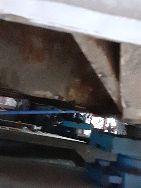

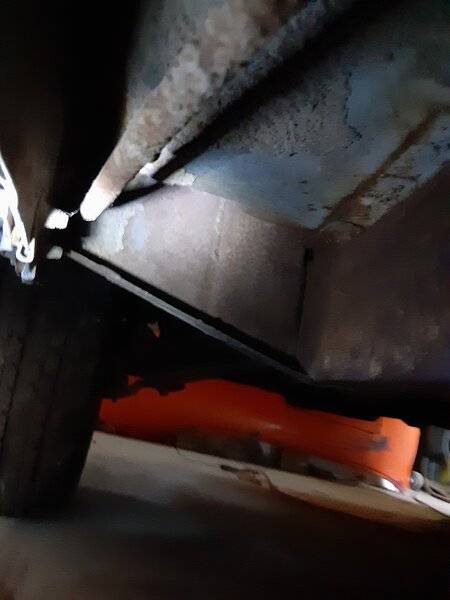

I took pictures of the drivers side of my 70 Charger R/T V code car,also no torque boxes.

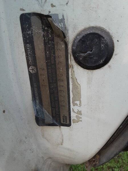

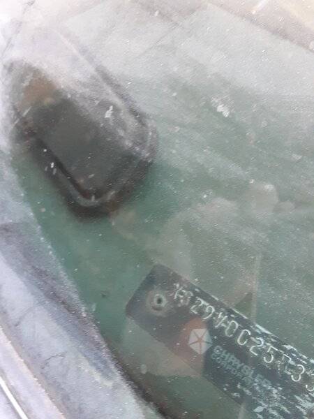

Better get that paint stripped off around the sheetmetal VIN stampings so you can see where/if they were tacked in...LOL.

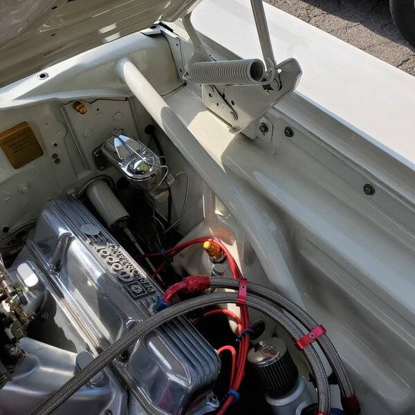

Saw this 67 gtx at a cruise, plate was welded to the outside of the firewall then smoothed out, two drops to the shock tower then down to the frame rail, looked very clean.
Thanks a LOT for the picture and description. :thumbsup:

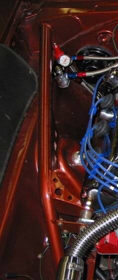

I noticed and posted about the only ONE other car I've seen in another thread that had the same basic thing done, and it happens to be one of THE nicest looking cars of all under the hood. I emphasize "under the hood" because KernDog's red car is a beauty too, and so is HEMI-ITIS's car, but his "inside the front fenderwells J bar and cut out inner fender" look isn't the look I want. I don't have a beautiful supercharger to distract the gaze upon my firewall...lol.:D
Look here:
Budnicks posted a lot of good info, but look how nice the copper color pic is under the hood!
https://www.forbbodiesonly.com/mopa...-hangout-friends.197025/page-3#post-911611340

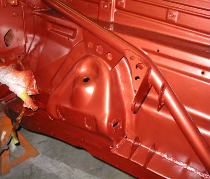

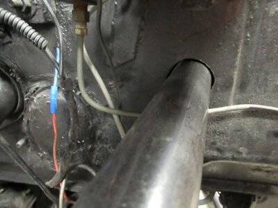

Here's a couple of those pix in the above post of the plate welded on the firewall and painted, and J bar:
My good friend scared me when I saw these pix, because my fenders haven't had to come off, yet...
This is when I learned about J bars:
https://www.forbbodiesonly.com/mopa...-hangout-friends.197025/page-2#post-911607106
...and I know this is unfinished work in these pix, which makes it easier for me to understand what I'm seeing, and the car itself is beautiful, but these pix:
made me worry about the fenders having to come off (I've calmed down a lot) and I was wondering about options.
I'm pretty sure that the "through the firewall" install of the J bars ties into the "cage/interior" roll bars and also my understanding is that's preferred for strength.
