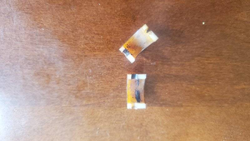

So I found myself a distributor (383) and took it apart and cleaned it up good. When driving the rollpin that holds the nylon collar she decided to let go. Anyone got a lead of where one can acquire one?
Thanks

Pretty sure he sells a metal one , that he had made , reading previous threads on this very subject
You can buy the correct nylon collar from hardware stores , Fleet Farm , they are good quality and cheap in price
Drill the proper hole can bee a challenge
Then you have to make sure you have the proper end play
You can also get metal collars at the hardware store with set screws.
Dump the nylon they will crack and set screws will come out look for a one piece one and yes the holes are a PIA because Mopar never used a jig to drill straight across the shaft. I have them 10 each out of stainless and the ride.

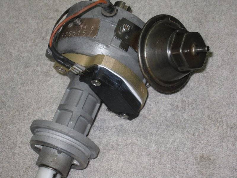

I used Delron rod stock (great for bushings) for my own replacement. Just had to drill 2 holes. I made it longer to avoid future splitting. Best/only photo I have.
