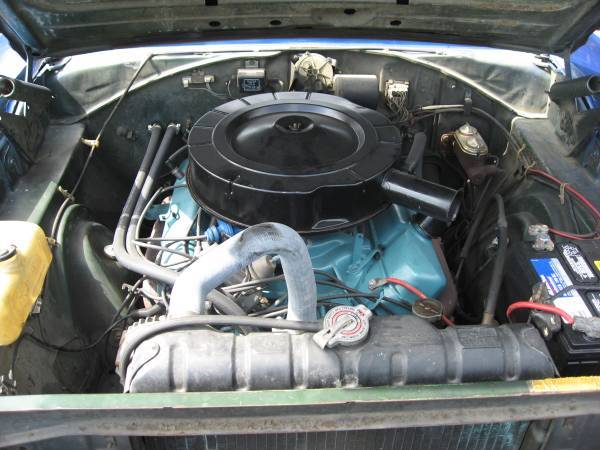

I built my car in the spirit of late 60s- 70s day 2, or street machine whatever you want to call it. I want to keep that look, these intakes were the direct connection suggestions which is why I wanted to use one, if it’s a better choice. It’s just a fun cruiser, not a race car yet. Any experience and advice is appreciated!
I re-read your original post. Period correct, day 2 look, better choice than Offy, fun cruiser, hood clearance, then my choice would be (and is, by the way) the Eddy Performer. Proven performance, period correct unlike the Performer RPM, it's a dual plane for real world drive ability and lower deck height for hood clearance.
I bought a used Performer for my car for the same reasons as your original post, it's an upgrade, dual plane, low deck (I want to keep my tall air cleaner), period correct for a stock motor and exhaust manifolds.
I bought a used Performer for mine for the same reasons as your original post, it's an upgrade, dual plane, low deck, period correct for a stock motor and exhaust manifolds.
