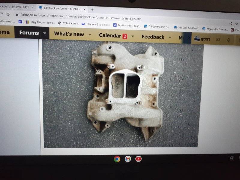

this is the older one i was thinking of with out EGR pad
