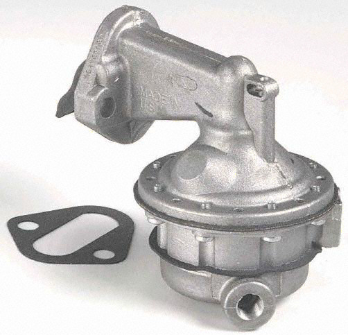

Great. Now, WHICH Carter? Seems Mancini has two, one of which makes me slightly nervous because of the pressure output.
Depends on your needs for your application the basic one with 120 GPH 5.5 to 6.5 PSI should be perfect
http://www.manciniracing.com/cabheen5psis.html
Fits: Big Block
The product specialists at Mancini Racing worked directly with the Federal-Mogul/Carter Fuel Systems brand team in bringing back these highly sought after mechanical fuel pumps that Mopar enthusiasts have been requesting for some time.
Both the Carter M6902 (small-block) and M6903 (big-block/Hemi) have the following features and benefits:
• 5.5 to 6.5 PSI
• 120 GPH flow rate

Bit the bullet and got on the horn with Mancini. Seems they are having Carter (Federal Mogul) reproduce the (famous?) M6903 hemi fuel pump, which has the proper pressure and of course, tons more flow than the 440 ones:
Once he assured me of no need for a regulator, done deal on that. It's on the way, along with the Comp Cams fuel pump pushrod #4626, made specifically for flat tappet cams.
Dieseldazzle was dead on the money with his comment on these - seems todays' cams eat fuel pump pushrods if they don't have a proper tip on them like this unit does.
I'll have to do some adapting of fittings once it gets here (pump has 1/4" female inlet and outlets), but no worries there.

Good choice. I like this one because with 1/4 npt you can get a fitting for 3/8 hose barb. I didnt like mine because it was not rebuildable and was only 5/16 hose but it flowed 33gph which was more than enough for my mild 383.

Hey looky there, we were posting at the same time. Yep, JB, the Carter M6903 is the exact one I just ordered, you're spot on!

Well, the pump looks great on the car and sure enough, the old pump pushrod had been eaten on some - I'd guess about a tenth of an inch, seems like. Probably not enough to matter, but glad I bought a new one just the same.
