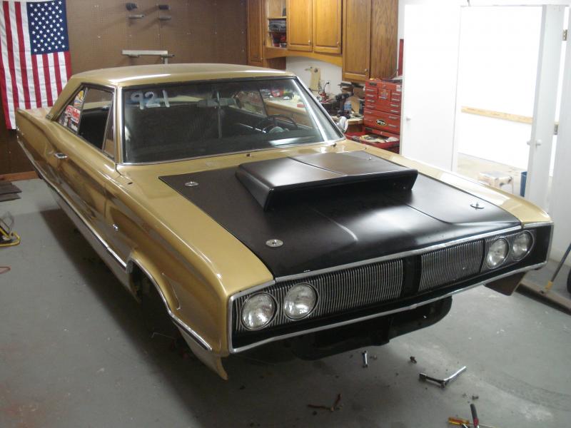

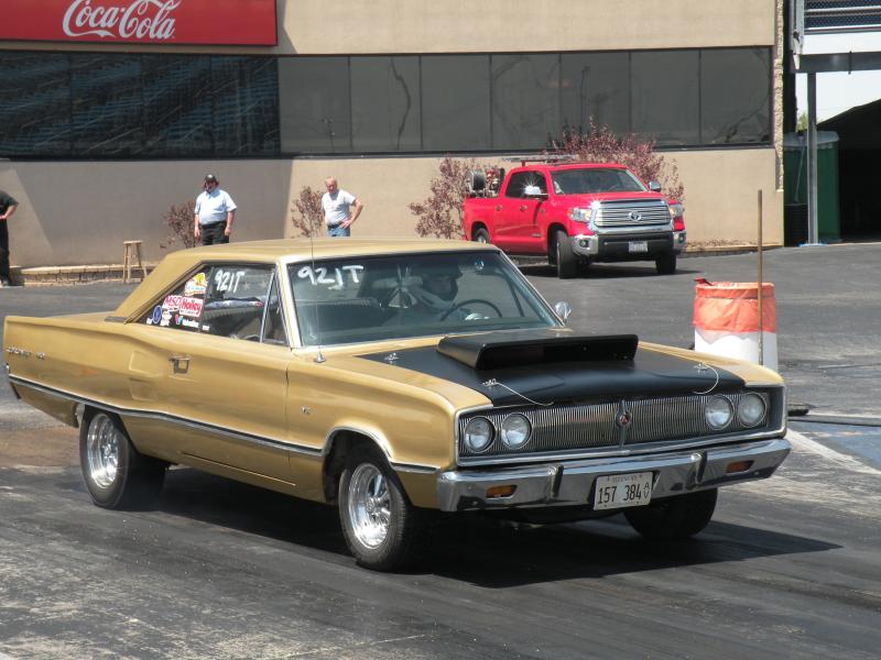

Hey guys,
Currently I have a 67 Coronet with a 440 in it out of a 76 Motorhome. The engine runs great and I have done a bit of bracket racing in it and very little street driving... Maybe 250 - 500 miles since rebuilt 2 years ago. A few details about the engine...
440 CID
8:1 est. Compression
Balanced Rotating Assembly
Forged Crank, LY Rods w/ ARP Bolts
452 Heads, Valves were lapped when rebuild, Port matched to Intake
Edelbrock TM7 Intake
440 Source 7qt Oil Pan
Windage Tray
Hughes Whiplash Cam .518 Lift w/ Valve Springs to Match Cam
3/8 Manton Pushrods
440 Source Roller Rockers
750 cfm Holley Double Pumper
727 Torqueflite - 2500 stall
Cheetah Manual Valve Body - Forward Pattern
Best time of 12.96 @ 105 w/ 4.11's out back.
I'm looking to rebuild another engine for the car, really want to get into the mid 11's. What do you guys think this thing is worth? It has all new bearings, piston rings, and low miles on it. I want to sell it engine and trans together. Or maybe is it possible to get this thing into the 11's maybe with aluminum heads? I don't know, just looking for opinions... Lets hear em! Also that youtube video is the last time I had the car out, maybe 2 months ago or so... Car was running a bit weird that night, was thinking it might of been some old gas.

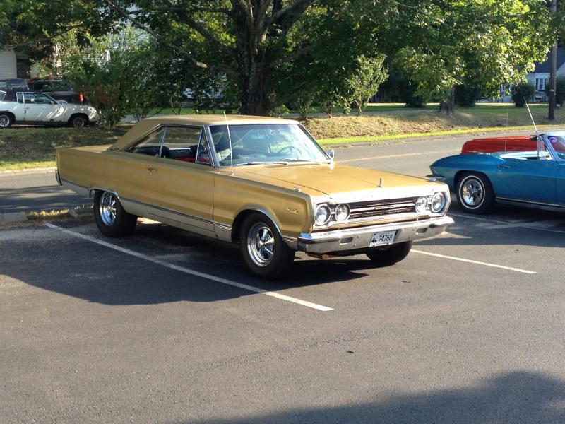

I would up the compression, replace the whiplash cam with a 509 Purpleshaft or equivalent (245-250 duration @ .050), and buy yourself some aluminum heads. PS I like your car, reminds me of mine.

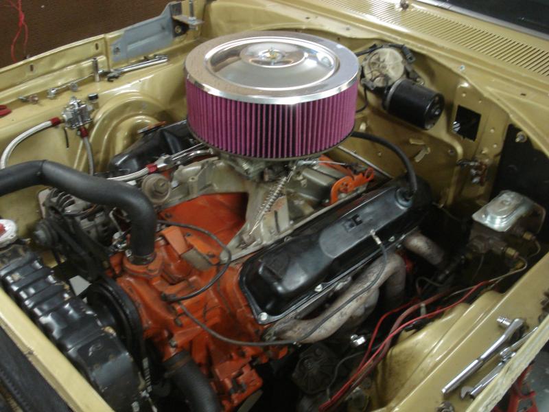

My car should go mid 11s, won't know until next year though. 10.5:1 compression, Comp XS290S solid, Stealth Heads, Hooker Comps, TM7, 4 speed and 4.56s.

Thanks for all the advice guys. I think I am going to go that route and get a little bit more compression outta this thing... Appreciate it. Also GTX MATT, awesome car. How do you like those Stealth Heads? Have you had em running on the car or in the process of building it?
I like them, ports looked very nice ootb. Car has been together and running for about a year. I'm running 9 inch M&H slicks and it spins from 30 mph in 3rd.:headbang:
