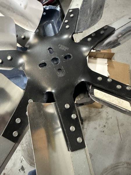

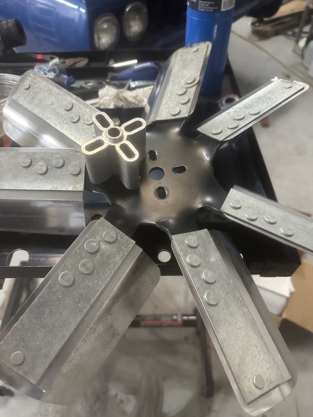

What does an original fan look like and where can I get one if I decide to? This one is obviously not original and I am trying to decide if I want to put it back on. Trying to do an original (if possible) restoration on my 69 Super Bee, 383, 4 speed, factory air. Non clutch. Also recommendations to have original radiator re-cored if needed. TIA
Original fans vary, depending on the specific application. But, they are available either used or repro. Source a local radiator shop to get your factory unit recored.

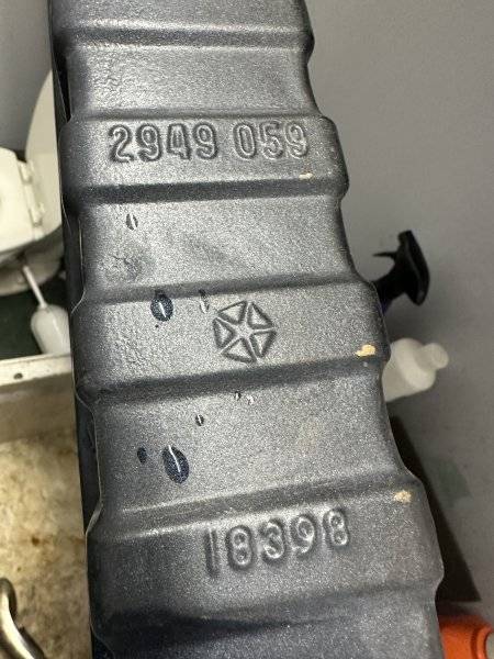

Your current core #2949059 is showing as being for a '69 B body 318 w/ac application.
#2949055 is for '69 B body 383 with both auto & 4 spd with a/c.
The 055 core used an 18.5" seven blade fan #2863216 and #2658456 thermal drive clutch. If you intend to do an oem restoration like you stated, you may want to locate the correct core before investing big money into your current core. If the numbers aren't a concern, go with your best judgement.
Thank you. I had assumed that the radiator was original to the car but evidently not. I would like to be oem correct, but not at great expense and difficulty. I will do some looking. Also, the core in this one is not leaking, just full of rust from a very bad heater core. It is full of evaporust now and may be useable, but if it is the incorrect one…
I had an unrestored factory A/C GTX 30 years ago that had a fixed spacer in place of the thermal drive fan that normally went with the A/C cars. I had the broadcast sheet, and it was coded for the spacer. So the non-clutch could have been factory OEM.
Yes I have the spacer. Neither it nor the fan appear to be original, and not all that old. Engine was rebuilt a year or two before I got the car and th we were probably added then, as well as, per another post herein, the radiator from a 318 car. ‍Sure wish I had the broadcast sheet. thx

I was pleased with the performance of the fixed blade fan in previous GTX, but I currently own another factory A/C car which has the correct 070 thermal drive with matching date code from Tony's Parts. If you want nit picky factory OEM, it works well, drove the GTX to Carlisle last summer in 95 degree heat, and no cooling issues.

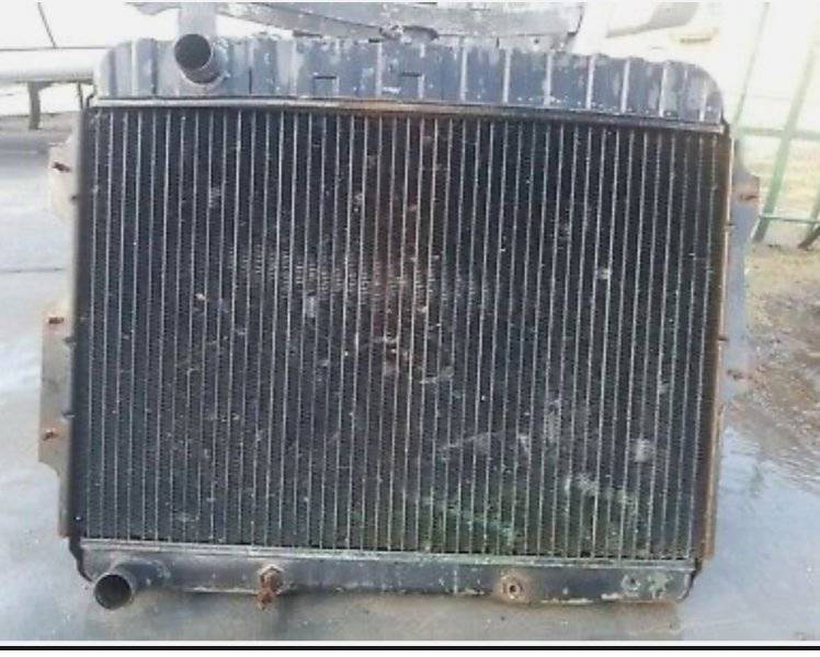

It appears none of the parts you showed are correct for your car. No idea where that flex fan came from Probably aftermarket. Also with that 318 radiator you have the lower inlet is on the passenger side. Your Bee would have had it on the driver side. That said, you must have a 73-up water pump housing with the outlet on the passenger side. The correct radiator and fan was mentioned in Post 6.
Both top and bottom inlet/outlet on this radiator are on the drivers side.
Actually found this pic online of the same radiator. Mine is in better shape.
