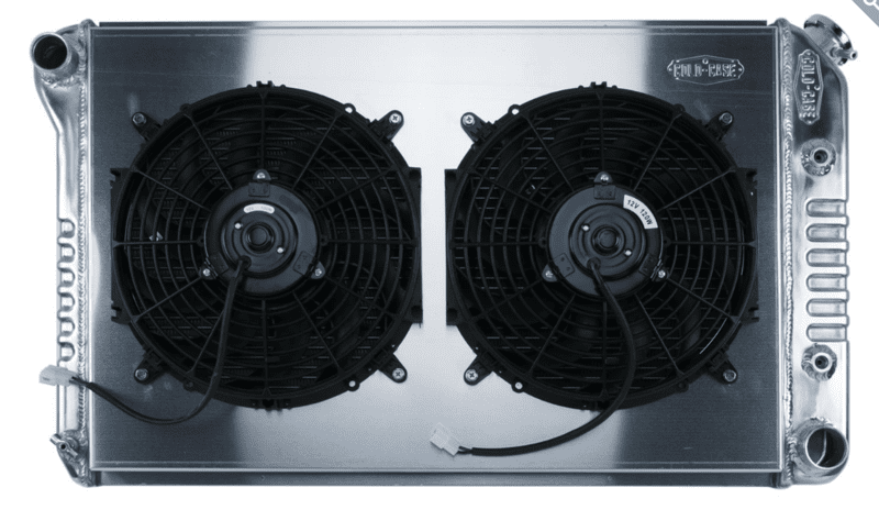

I would like feedback from anyone using electric fans, whether a single or dual fan setup.
HOW HAVE ELECTRIC FAN(S) WORKED FOR YOU? ANY PROBLEMS?
I find it very hard to believe that the company, Cold Case/Max Performance, that makes a fine quality aluminum radiator would sell a dual 12" fans and aluminum shroud assembly that doesn't work. After making sure everything was working properly and there were no air pockets in the cooling system, I was still seeing temps over 220° in my wife's GTO.
I got with the vendor that sold us all kinds of stuff for both of our cars, and he recommended a 16" two speed fan and shroud assembly, rated 4.9 out of 5 stars, over 70 reviews. I also have the 17" version for my Roadrunner, and soon I will see how it works to keep my 440 6bbl cool. I got Cold Case radiators for both cars.
I tried the factory mechanical clutch fan without the shroud on the GTO and it seemed to run cooler than the dual 12" fans, and that's when I decided to get the 16" fan. The problem is that I didn't take the car on the highway w/the mechanical fan, because that's where it is overheating. Everyone says at 40 MPH or higher the fan is no longer in the equation anyway.
Bottom line is I can't believe that the fan I have in the GTO now, so highly rated by over 70 people, the only brand that this very busy, very knowledgeable vendor sells because he never has any problems with them from customers, is the "second fan and shroud assembly that is so crappy" IT is the reason why the car overheats! No way!
I am convinced that the gap between the water pump impeller vanes and the divider plate (crazy Pontiac design) is too big, and that is causing the pump not to work properly, especially at hjgher RPMs.

My thoughts, from 25 years of working/learnign on cars, 25 years as an engineer, and a few years working as an engineer at a cooling-fan manufacturer:
The root cause is always 1 of 3 areas:
  1. an engine creating excessive heat into the coolant,
  2. inadequate coolant flow,
  3. or inadequate heat exchange at teh radiator.
Elec fans are a crutch for a cooling system that, for whatever reason, benefits from more airflow across the radiator, to 'fix' the true cause. That's not necessarily a bad thing, though, if actually allows the system to work.
But - those elec fan blades are a restriction to airflow through a radiator, esp when not in use (freewheeling is still a restriction, albiet a reduced one). From discussions at the fan manufacturer I was at, those aftermarket fans have terribly-designed blades (for generating flow) and the finger-guards on them are quite dense and therefore are a restriction also. They may provide a CFM rating on the fans, but usually not at the corresponding pressure drop, so the airflow rating is meaningless when attached to a radiator whose pressure drop across the fins is unknown. This restriction will also get worse if the fans have box shrouds built into them, if they are covering a 22-26" square of heat exchanger with a flat-box shroud with some 12-16" circles for the fans.
I can fully see that a cooling system with some underlying problem, could have a highway overheating problem due to reduced radiator airflow.
With all that said, I would remove the shroud if possible and take a close-to-home highway drive and see the change.
Maybe then take 1 fan off and see if the car can stay cool at low speed (you have no mechanical fan, correct?) and how the highway heat changes.
Bio, i'd look real hard at the lower hose and a new radiator cap also.
Not only have numerous people, websites, etc said that "over XX MPH" (usually 40 or 45 MPH) the fan no longer is in play,
What this statement usually means is that at higher speed, the ram-air effect of the vehicle moving through the air is sufficient and a fan is not require to pull sufficient air through the radiator to cool the engine.
The only thing I haven't tried is the mechanical clutch fan on the highway, and now I feel stupid for not having done that, only because it's a box not checked off.
Correct. That's why I don't think it's the fan.
Agreed on the spring, especially if you decrease the clearance on the water pump impeller, as that will create more coolant flow, and increase suction on that lower hose, and that could become a new culprit if it isn't already.
But if you are not actually boiling coolant out, I would disregard the radiator cap as a cause. The cap maintains a pressure rating, which raises the boiling point, but doesn't change hte coolant temperature. Increasing the cap rating also increases pressure on your heater core. I always want the lowest pressure cap required to prevent boiling.

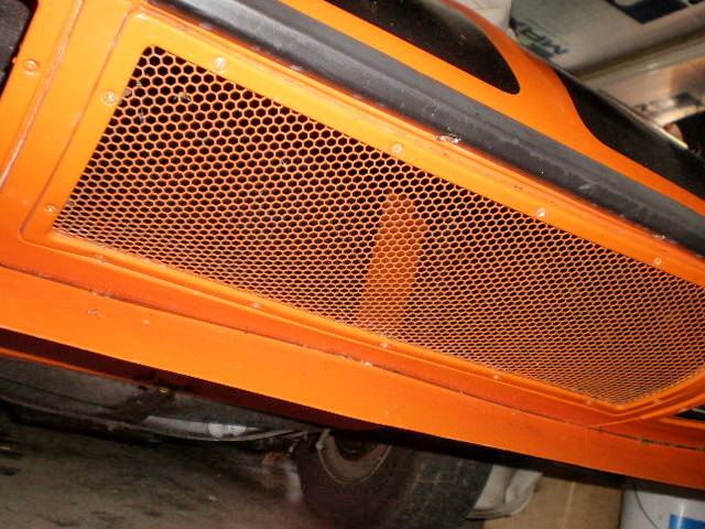

Never had need for electric fan,you know they never overheated when new with all O.E.M. equipment,even with a 30"x 8" grille opening,this has never been over 200* under any condition,idle,on the road or whatever !
