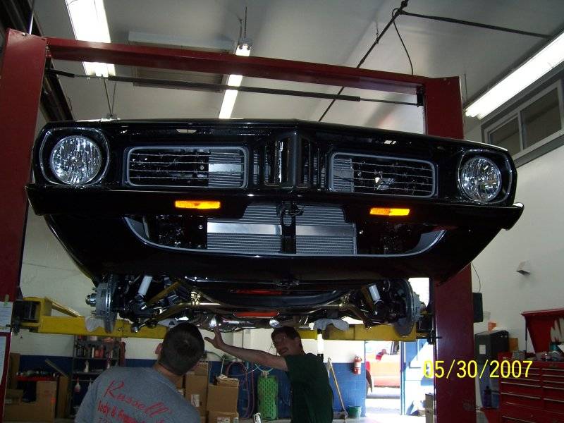

We built this one with the Summit cross flow.451 big block using the factory clutch fan, no shroud. Worked fine.
