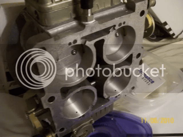

You can drill and tap the holley if it
has a double wall on the vacuum
port on the primary side. Don't run
the tap all the way thru, but just
enough to seat the nipple fitting.
There may an existing boss in the
carb base casting (which from your
first pic shows it's there.) Very easy,
and you won't have to drill and tap
the intake. Done this on my current
setup, and enough vacuum for pcv
and brakes.
and brakes.

Ooh this is an interesting idea! Let me look more closely at the carb! I think what you saying is that the primary (front of the carb) side is a double wall with a boss that I can drill out and would provide full manifold vacuum! This might be worth a try!
NO dice not enough meat…
Worth the investigation. Your
base plate doesn't have the double
wall.
10 Minutes with a drill and a tap and you would be done. Easy Peasy.
