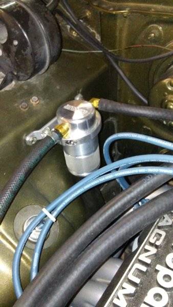

I have one get you some pics later today. You ought to see the goop water/oil stuff that collects in there. Its a good thing to have but not a replacement for a PCV. It is plumbed in between the PCV and the carb.

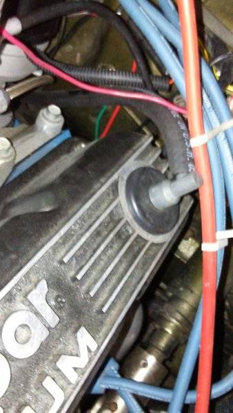

Starts here
Catch can

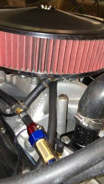

Back into the carb
