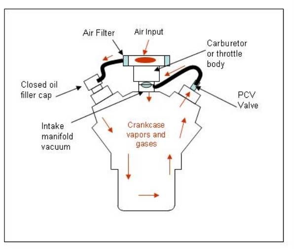

Several people seem to have questions about the catch cans, including me. Could someone explain, and maybe post a picture? I tried a PCV on my car. Seemed fine until I fired it up one time, and got a big cloud of blue smoke out the exhaust. I plugged the PCV, and no more smoke. It was hooked to the back of the carb. No place in front. I think there's something wrong with how i did it, so i might need a catch can. If it were explained better.
youn may not have a baffle in the valve cover under the pcv.

What you want to happen is the suction on the tube, or hose in the case of the pcv, to be flowing a greater volume of air than the vapour being created. You create a negative pressure in the crankcase. So what that does is pulls clean dry air into the crankcase from the inlet vent. That's why the oil filler caps that were used along with the road draft tubes were open and stuffed with steel wool. Allow fresh clean air in to replace the nasty vapour being pulled out. This is what keeps the acids and vapours from condensing inside the engine.

there's no real downside to a pcv on the street. from what I've read here nobody has mentioned water. water is a by product of combustion and can accumulate in the crankcase (water vapor condensation). the pcv can pull the vapors out reducing oil contamination. the pcv can reduce carbon in the crankcase helping to maintain cleaner oil. all engines leak past the rings some; some worse than others. I just don't see a downside for a street car.
These are the types of answers I'm looking for. I don't have a problem using a PCV. I just want it set up properly. Some say the thread should have ended long ago, but with all the squabbling, and unhelpful answers, it can be hard to pull out all the good ideas. So now I know I need to check for a baffle on my aftermarket valve covers. I should block off the breather on the same valve cover as the PCV. I don't need a catch can. I don't want one. It will reduce moisture in the crank case. Maybe stop oil seepage from the engine. Thanks to all who posted useful info. I will give it a try.
