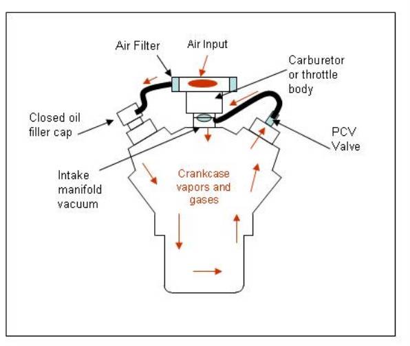

Here's a simple picture of how it works.
Ok. So, it shows a hose going from the breather on the passenger valve cover to the air cleaner. Is this also needed for proper function? My car currently has two breathers. Neither connect to the air cleaner. One on each valve cover. Drivers side also has the PCV towards the rear of the valve cover. Will two breathers have a negative effect?

In the sketch above you can eliminate the hose to the filter by just putting a breather cap on that side but yes that's how it works, air in, air out.

Yea, sorry I should have mentioned that you would remove the hose to the air cleaner. The rest of it makes sense.
