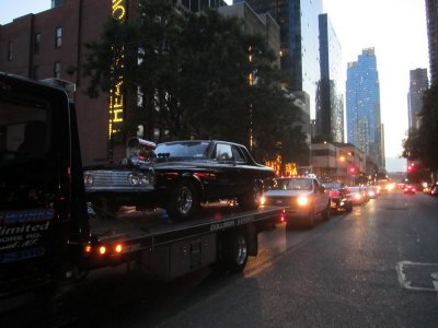

They say that 700 to 750 is the limit for a stock block. Yea,some guys get more than that,,,,,,,,but for how long. I want with the siamesed bore block and started at 521 ci,After a few parts failures I am now up to 545 inc.hes with room left to grow.Can go to 4.5 bore with the siamesed bore,I have heard of guys going 4.6 with a sonic check and still have some meat left. I also use a 4.5 stroke crank. Choose your parts wisely,there is a reason the cheap offshore crank is cheaper that a Callies,Crower or Bryant. Build it RIGHT the 1st time and save the misery later.
I street drive about 2000+ a year and try to get to the track when I can and it's not too hot out:blob1:
