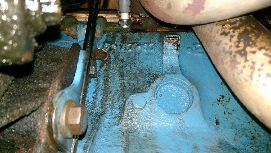

Now that my car is back from the shop I've had some time to get pic's. Just need everyones help on a few items. Based on what I've found looks to me a #'s car correct? Do I need any other #'s to verify I this is truly a #'s matching car?
Head- 2843906-6

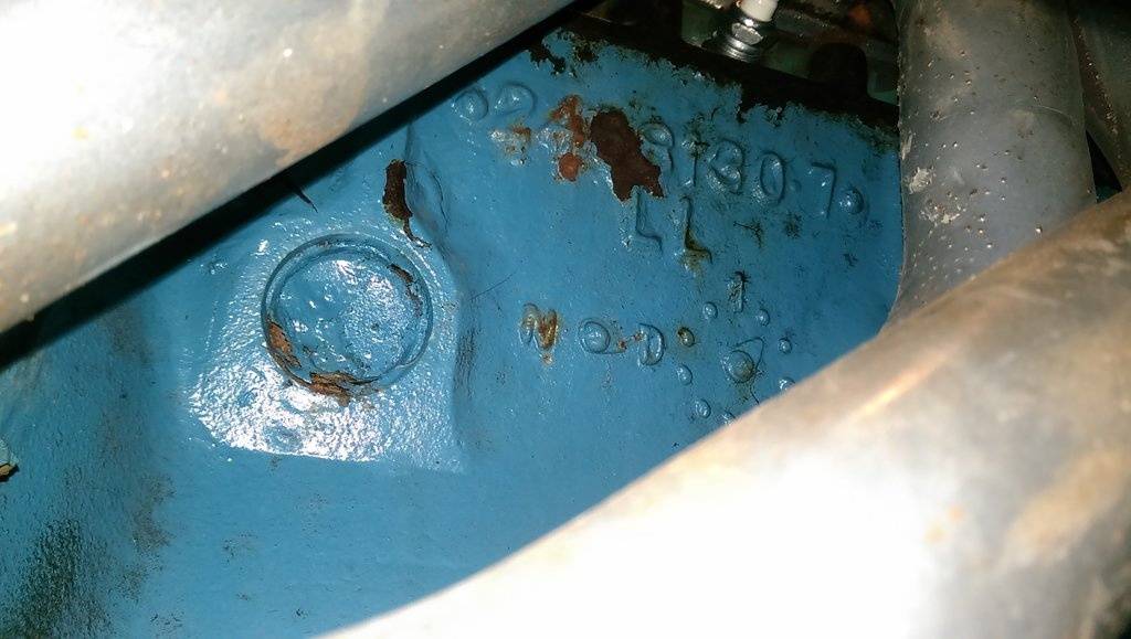

Engine- 246813-7 LL Date code on block 5-17-67 I'm assuming the 2468137 is the part #What does the "LL" Stand for? Also assuming the N & D are to designate the Night & day shift correct?

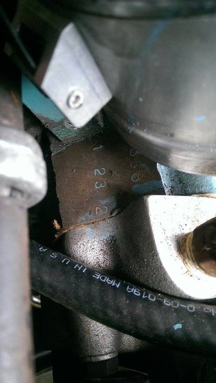

Pad says D383 1 23 2 - D = D series, 383 = Engine 1 23 - Jan 23. Does the last 2 Stand for 2 BBL?

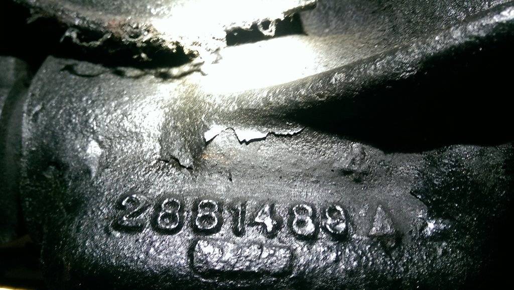

For the rear it has the 489 case. What does the Triangle mean as well as the 4 above it.

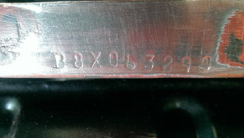

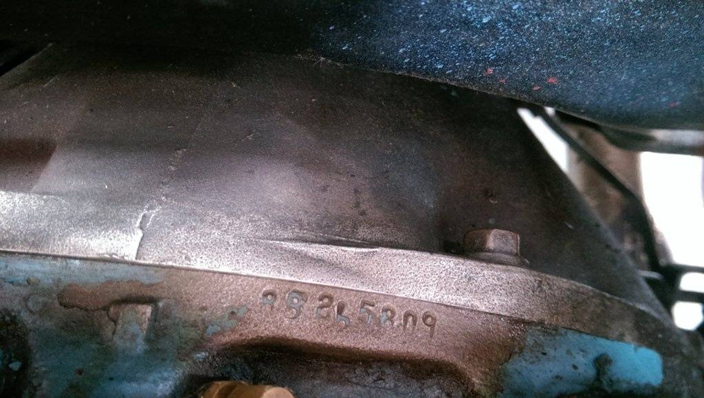

The other vin numbers are on the driver side trunk lip....
Your trans has NO stamping in relation to vin.....
489 cases was 69-74......
So based on your paperwork and stampings the block mates with the body and build sheet(assuming the trunk lip matches).....the other parts just complete the puzzle of driving it....
Back then I did not have clear pic's of the block/tran but now I do. I also discovered on the pad a #2 after the 1-23. So not sure what that meant.
So the 489 case was not offered in 68, meaning it was swapped out at some point. What does the Triangle mean as well as the 4 above it.
Also want to understand the #'s on the engine. Engine- 246813-7 LL Date code on block 5-17-67 I'm assuming the 2468137 is the part #What does the "LL" Stand for? Also assuming the N & D are to designate the Night & day shift correct?
Based on all of the #'s it appears the car is #'s matching for the block & tran, but NOT the rear.

Where's the vin stamp on your trans? The pk numbers are trans related numbers and not vin numbers....
The 5/17/67 is the block casting date....when the block was formed...the other number is the casting number relating to a 68 383 block....the ID pad date is the build date of the motor in relation to the build date of your car roughly...
The triangle is a manufacturer mark...means nothing other than on a 489 case will have that. Find a 742 case and your rear will be complete....

2468130-7 = 2468130 casting# for 59-71 383B, 7th "mold" (#core plugs replaced in casting)
LL = someone please tell!
D = day shift, cast during 2nd hour of shift
5-17-67 = casting date
D383 = 1968
1 23 = assembled Jan 23, 1968
2 = 2nd shift
VIN Block/Trans: I agree if the block has the VIN, so should the trans as stamped at same time.

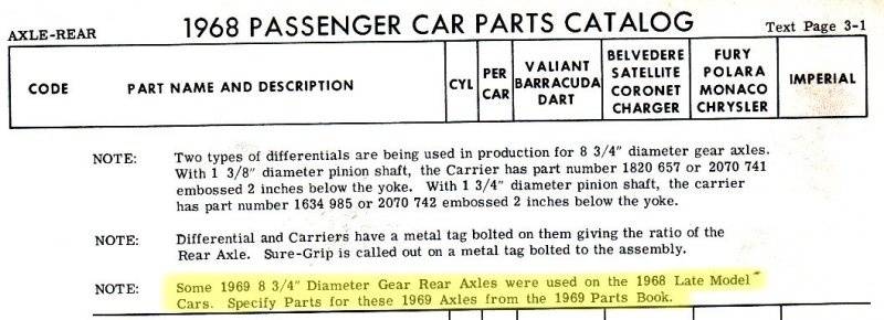

The 237 axle assembly code on the Broadcast sheet tells us the rear came with a 1 3/8 pinion so it was a 741 case.
While more common to '69 and later, the 489 case was released late in the '68 model year. Check the casting date on the housing.
