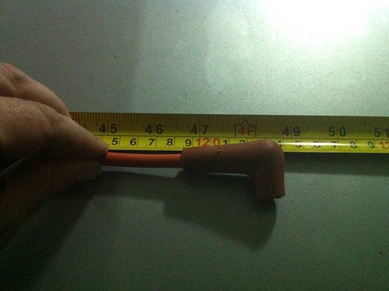

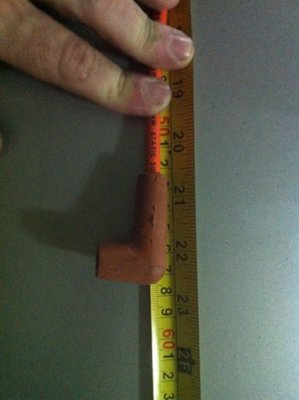

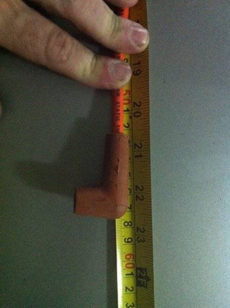

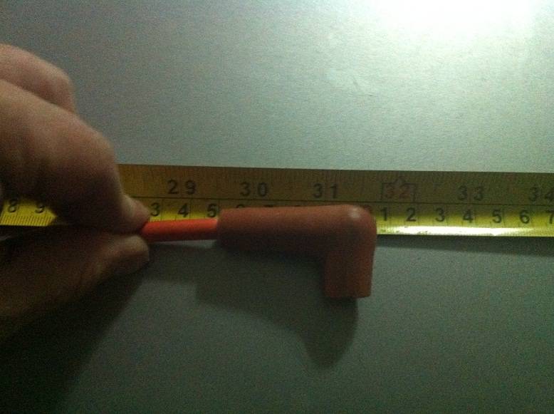

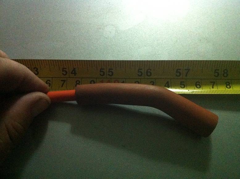

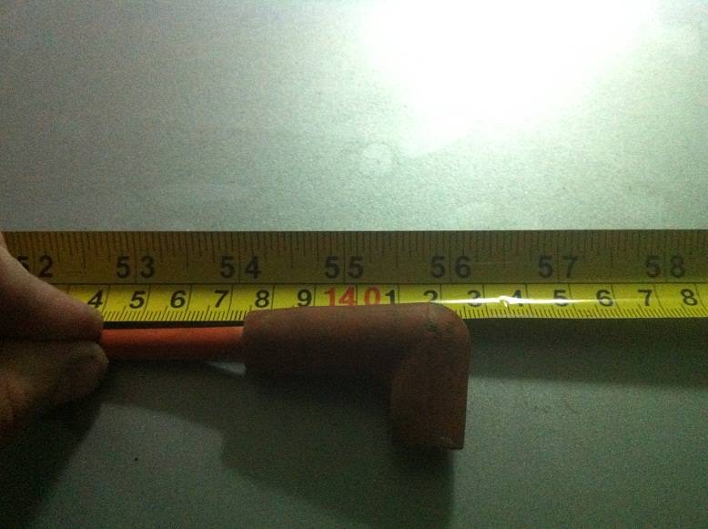

I’m searching the PN of the set i got somewhere between my files because I’m away from home to check the NOS set box personally or my 74 Part catalog but searching the info found the measurements I sent to firecore to make mine... from center of terminals between them as firecore request
Coil---9"
1-----22 1/4"----90º boot ( cylinder 2 )
2-----25----90º boot ( cylinder 4 )
3-----31 1/4"----90º boot ( cylinder 6 )
4-----40 1/2"----135º boot ( cylinder 8 )
5-----43 3/4" ---- 90º boot ( cylinder 1 )
6-----48" 1/2" ---- 90º boot ( cylinder 3 )
7-----55 3/4"----90º boot ( cylinder 5 )
8-----56 1/2"----135º boot ( cylinder 7 )
I’m telling you request for the old order I sent ( back in 2012 ) because if you send measurements maybe could charge some extra fee making them as a custom set, while maybe if between their files you could get the regular price? Dunno
These measurements are prooved to work on 73 and lates Big Block with stock brackets and routing configuration for these years ( and Manifolds ). Its on my engine based on the NOS set I got.

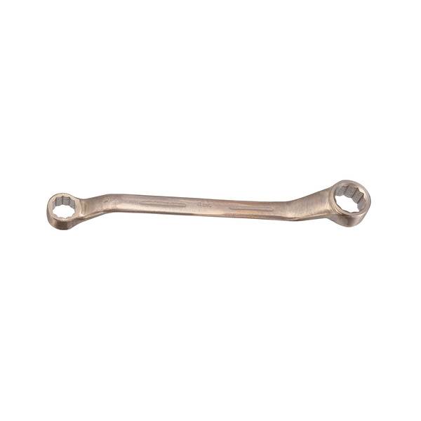

About changing spark plugs... passenger side is easy from engine bay with rachet and socket, but driver side... definitelly WAY easier from underneath the car. A loop wrench is enough to loosen and then remove it with hands

Maybe I used the wrong therm in english for the wrench name ( english is not my mother language ) but I meant this one:
With same angled shape in fact!

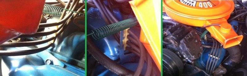

Brackets needed for 73 and lates big blocks
2 M brackets attached to head bolts, one on each side
1 H1 bracket on passenger side with its plastic wire separator
1 J bracket on passenger side withs its plastic retainer
1 extra plastic wire separator for the driver side valve cover
AAAAAND
the extra bracket I pictured on the thread I posted the link WHICH IS NOT AVAILABLE AS A REPRO... Attached to the valve cover bolt down the air cleaner pan... with its plastic wire separator of course
That's all. Nothing more nothing else.
This is at least for AC cars

finally found the PN of the NOS set I got
3744973 maybe superceded by 3838000 which is the PN on my 74 parts catalog. These PN were handwritten on the box decal, and got printed the 4892-H PN on it

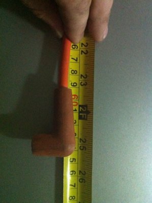

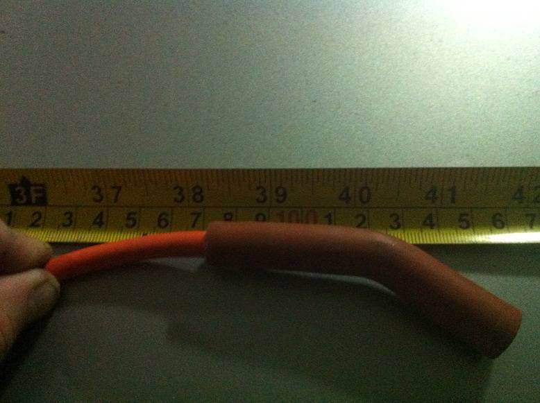

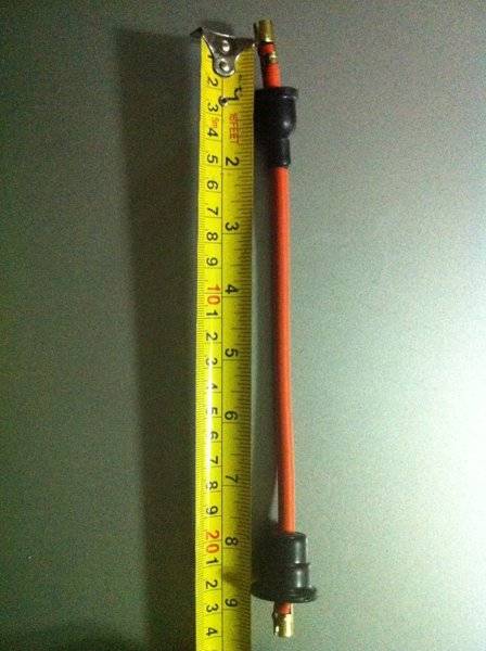

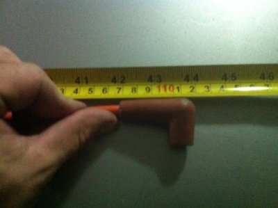

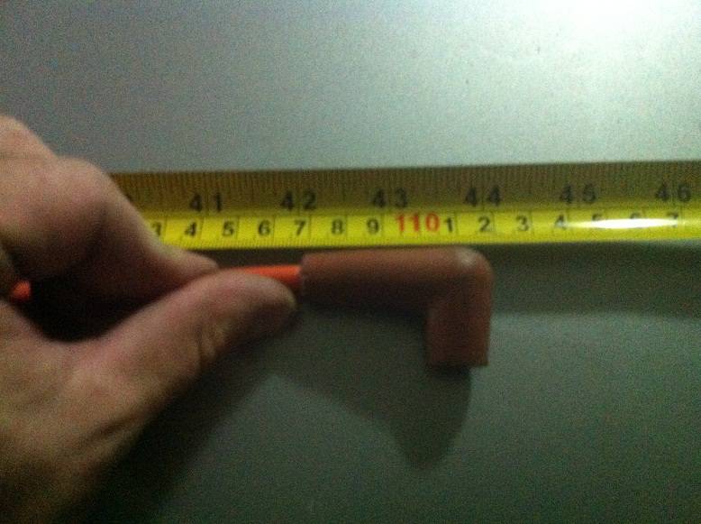

posting the actual pics of the wires and mesurements ( found them on an email I sent to Firecore )... showing just the spark plug end, but they are of course measured correctly on the other end
IMG_0918.JPG IMG_0917.JPG IMG_0916.JPG IMG_0915.JPG IMG_0914.JPG IMG_0913.JPG IMG_0912.JPG IMG_0911.JPG IMG_0910.JPG

On last pic its shown one which IS NOT AVAILABLE AS REPRO ( the one down the return spring throttle cable hold by the valve cover bolt ). The valve cover bracket is welded so just need the plastic wire separator which is available separatelly
