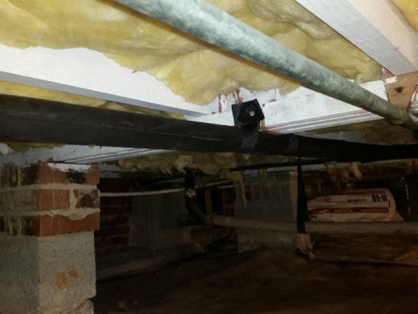

Finished with the crawl space ( for now ) and the insulation and hanging of the pipes . . . glad that's done . ..
Here's an insulated pipe and the hanger holding it in place . . . notice, as I said, all the floor joists are primed . . .
Don't mind the spiders - I don't have many down there, after meeting a 6' black snake down there, I found where he/she got in and got that sealed up real good, and I don't have much of any problem with mice nor snakes anymore . . . the cave crickets drive me nuts, and when I get it all sealed up, and get rid of the moisture, they'll all be dead too.

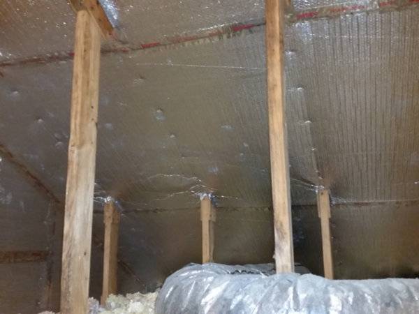

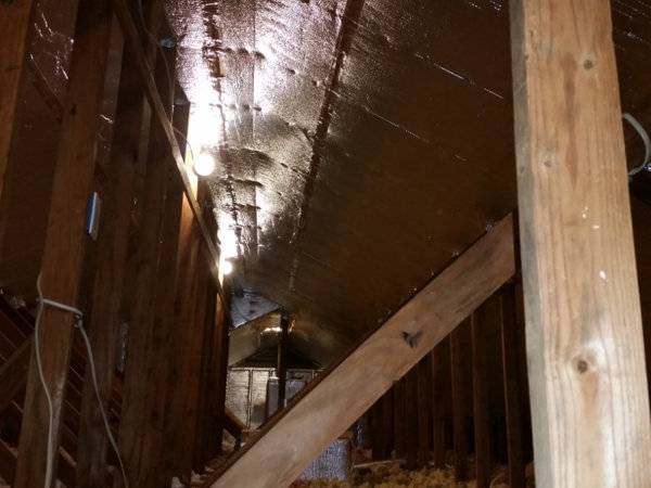

Installed a full radiant barrier on the bottom of all the studs in the attic and I've reduce my attic temps by 50-60 in the summertime . . . HUGE difference ( lot of work )
The Radiant barrier was bought at the local home improvement store - it's (2) pieces of silver mylar on both sides with bubble wrap in the middle - works GREAT !

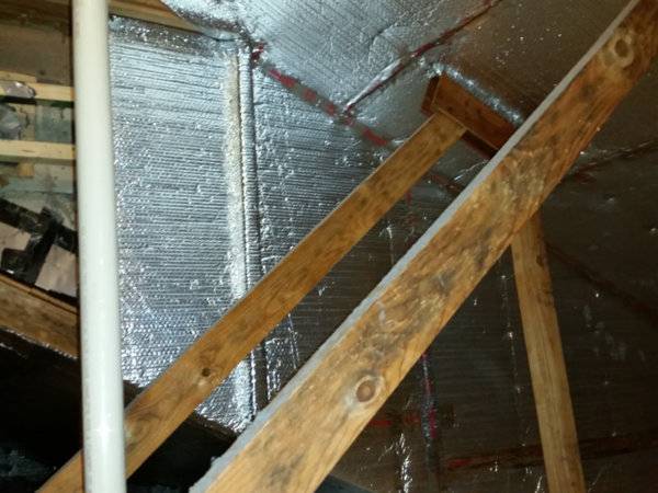

Ant another shot of how it's attached . . . I've got eaves vents on the house, all the way around, and a ridge vent at the peak - the air flows in the eaves, travels up the 4" gap ( ok, 3 1/2" gap ) between the roof decking and the radiant barrier - and exits out the ridge vent - it the temp get above 100, a attic vent fan kicks on and blows the hot air out . . .
If I had those temps at my house, I would consider bringing that set-point down a little bit....to like around 80 degrees. :)
