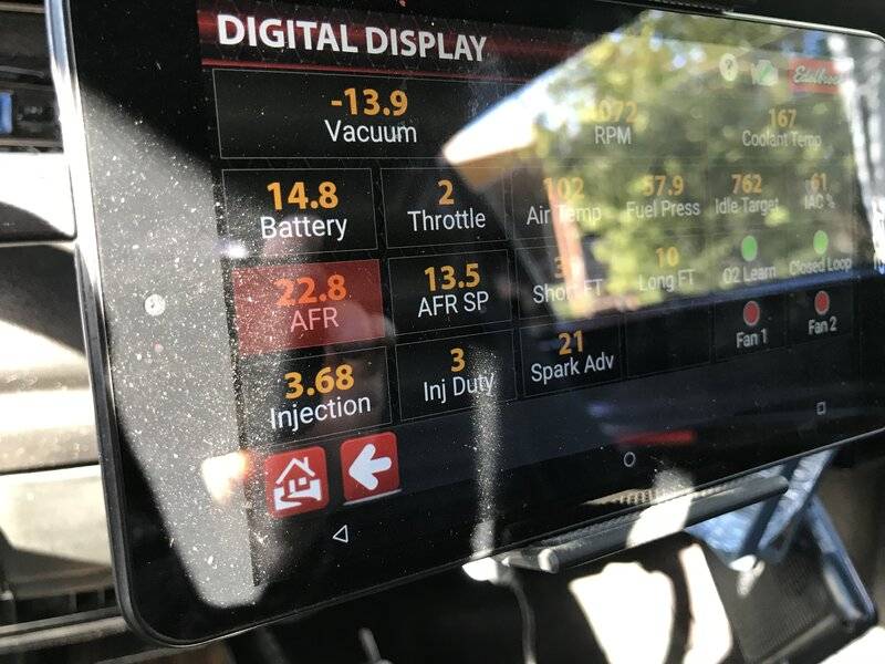

Getting this AFR since FF Box installed. Drove it about 15 miles. Still 22.8. No noise or performance issues. Drive it more? What is a normal range? Thanks.
View attachment 1031142 Getting this AFR since FF Box installed. Drove it about 15 miles. Still 22.8. No noise or performance issues. Drive it more? What is a normal range? Thanks.
Goal is as close to 14 as possible. Good range is 13.6 to 15.2 for most driving. O2 sensor wiring might be loose?
22.8 is way lean, as in it won't run that lean?
Your setpoint "SP" is the one just to the right.
Something is wrong, exhuast leak, sensor location or sensor itself.
Does it have a diagnostic window with errors?
But I see the O2 learn light is green so maybe you do just need to run it more.
Dennis, what's the one next to it labeled AFR SP? That number looks about ideal. How does it drive? Any performance issues?
The AFR SP is the specified value...
The lower the voltage output from the sensor the higher the value shown in the AFR box... 22.8 volts means the unit isn't getting a signal.... It's likely running on the known values & ignoring the AFR... That's why the AFR is in red....
Drives ok. No knock, odor, or other indication. Thought I noticed s slight stumble when rolling on after a shift with rpm under 1k. Isolated. Gotta drive it more. Its been laying around and jockeyed a lot. I put fresh gas in it. We sill see. The 02 Bung felt secure. It is on the side (drivers) that had to come off to install the FF2. Will report back.
Installed ahead of flange. Surprised the aging TTI’s survived.
Follow the wires from the sensor back to the main harness, likely it got pinched, possibly a wire got pulled out of a connector... Something along those lines... The fact the sensor is on the drivers side only makes me more sure thats where your issue is...
