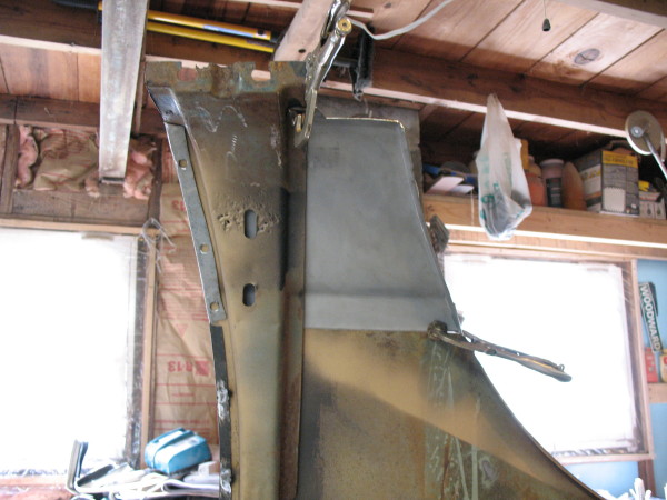

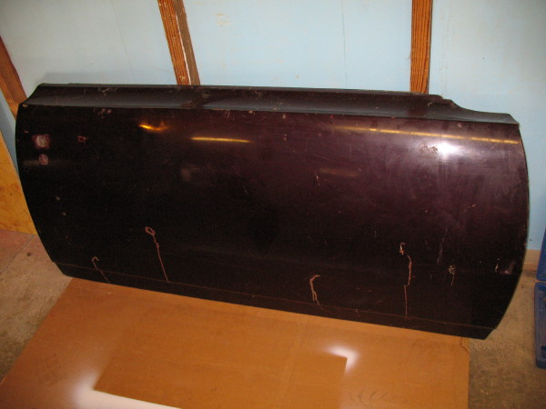

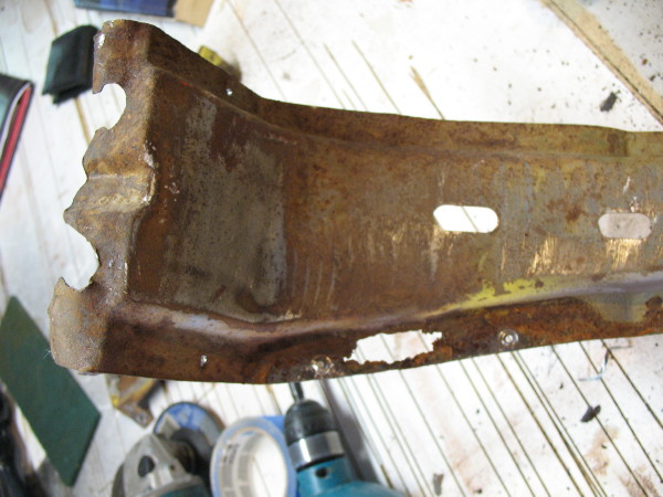

I should be getting my pillar parts, thanks again General!, on Wednesday, so for now I got the doors I will be using out from my storage building and finished disassembling them and those will get blasted same time as the chassis. Also grabbed one of my fenders, which are going to need some work, both have some rot behind the wheel opening. Had already picked up the lower patch panels some time ago, so now it is time to fix them. Check out this old repair, it looks like they used part of an old metal sign for the patch and melted some braising rod over the top of the joint to adhere it:rolling:. Unfortunately the understructure has some thin spots and a big hole in it, thankfully, I have an extra, so that will get replaced too. Here's how it looked so far, still have to do some cabinet blasting, cleaning and por priming before I can put it back together and weld the patch in.:grin:

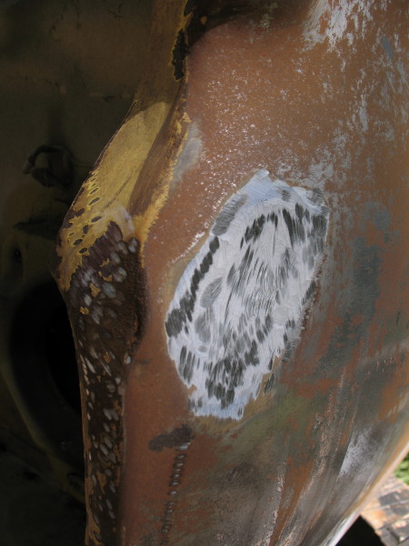

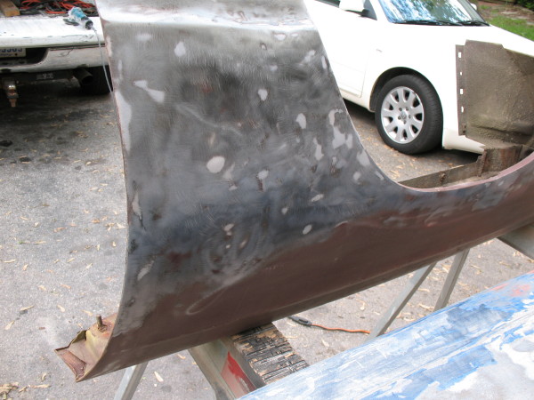

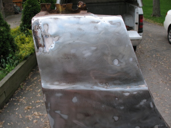

Got some more done on the one fender, sandblasted the surfaces that won't be exposed after they are assembled and por15nd them as well. Should have that one back together today. I also pulled out the other fender, which was primed and needed to be stripped so I can see what kind of shape it's in. Well, it's not great, in fact, the "DOGS" original fender just may be in better shape, so I pulled it out too, but I'll save that for another reply.
Also found some dents in the front around the headlight bezel that will need some work, I'll try to beat them out some so they won't need so much filler.:grin:

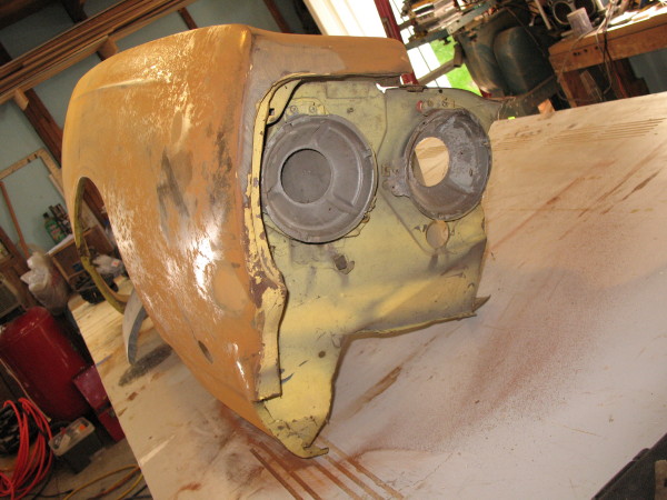

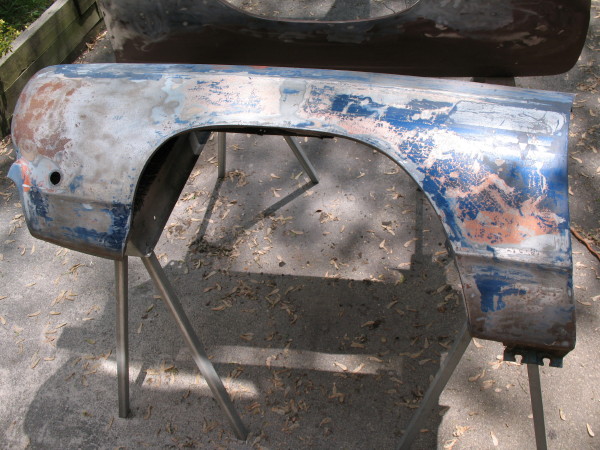

Ok, here are the pics of 2 driver side fenders I have to choose from. It is looking like the "DOGS" original might actually require less work than the one I picked up along the way. So I stripped the paint off both to make the final determination and in the process uncovered some more of the "DOGS" racing heritage. It seems the adhesives from the stickers leached through the paint and stained the metal. It may be hard to read in the pics, but I see one "Firestone" and one "Crane", kind of gohstly. The one that was in primer has small rust hole in the usual place and is just dented and dinged all to hell. Both are repairable and I will probably fix them both, use the original and sell the other ready to paint.:grin:

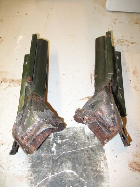

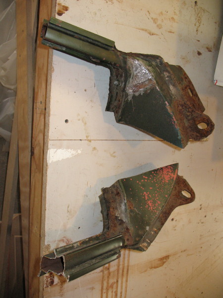

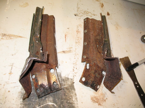

Yes I did get my a-pillar parts from Generaljmwlee, thank you very much, and here is what they look like. I have removed the stuff I don't need off of them so far, still need to blast & prime them before install, hopefully by the end of the weekend it will be ready to go.

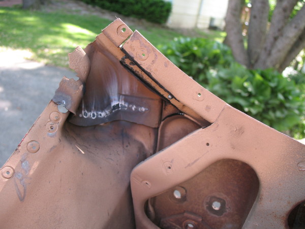

I got the pillar parts welded to the cowl today and got a little further with the one fender. Next I will install the cowl. I probably won't be leaving for the Island for another 10 days or so, my materials and tools are on a container ship headed for Mustique and I don't want to leave until I have a confirmation date that they will arive. I will have plenty of time to get the "DOG" to my buddies collision shop for the start of the next major part of this resto.
