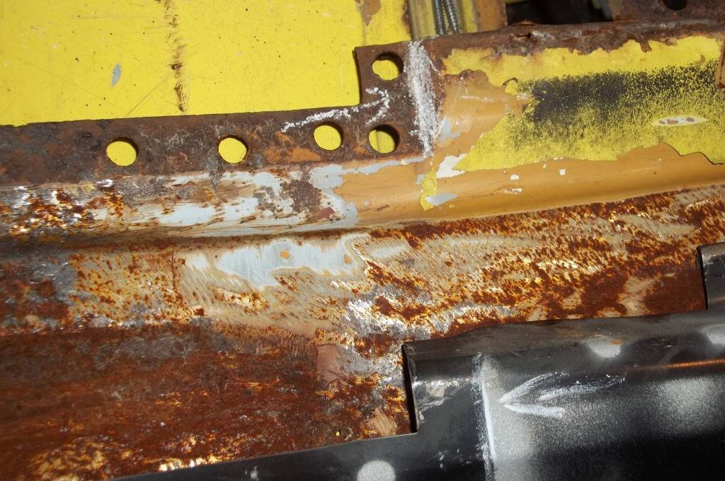

Wow, you weren't kidding about the plated trunk floor!!!! Looks like they replaced the rear frame rails with box tubing as well which isn't necessarily a bad things as long as they did it right. I remember building my first car in a 15' X 30' garage so I know what your talking about but everything has it's rewards. My dad and I built a 32' X 60' garage which is great but you sure as hell can't go out there in the middle of the winter and expect to be warm in any less then an hour or two so next time your sitting in there all toasty warm just think "suckers". Thought I'd mention all we used in our smaller building was a little pot belly stove which could run you out in a hurry.

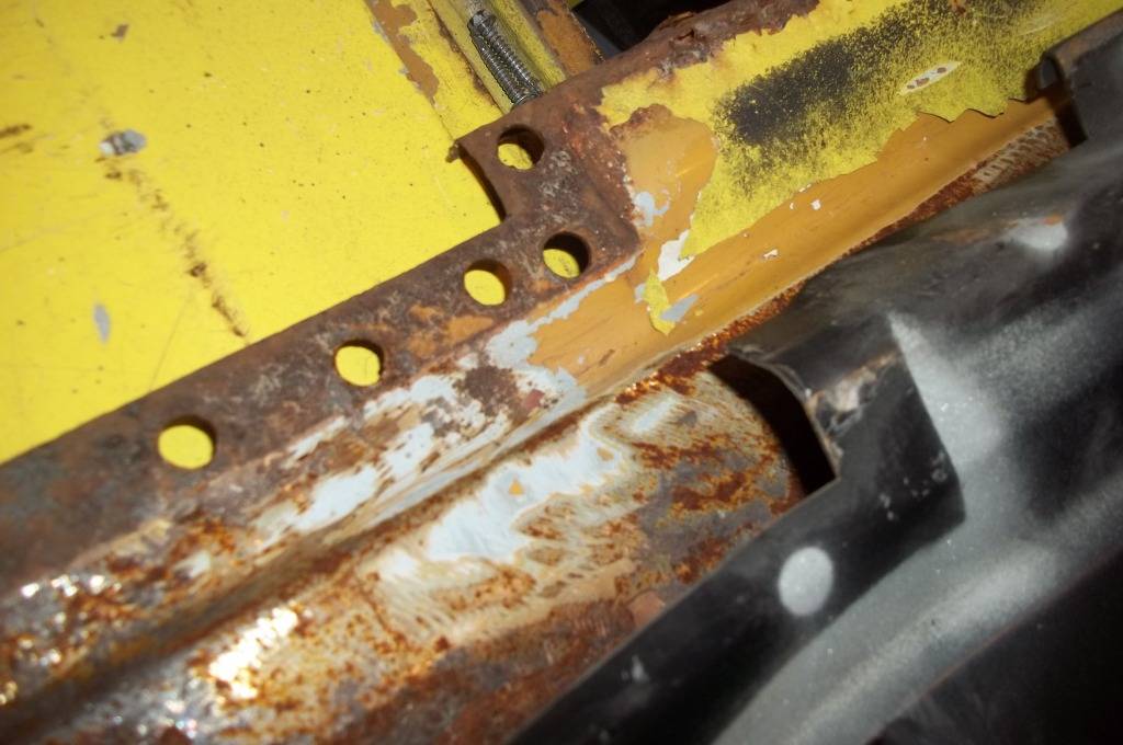

Thanks guys, yep i wasn't kidding with this "repair" work i told you about Devin this stuff is thicker then frame rails :), amazing what can be done, i have done the same crap at one time or another im sure, but this mess i would like to think i wouldn't do it, Must have worked i guess is the only thing i can say...
It's been tore out, grinded out, and burnt out, some kind of grey glue that when it catches fire will kill ya if you breath it in i found out lol... But GONE now!

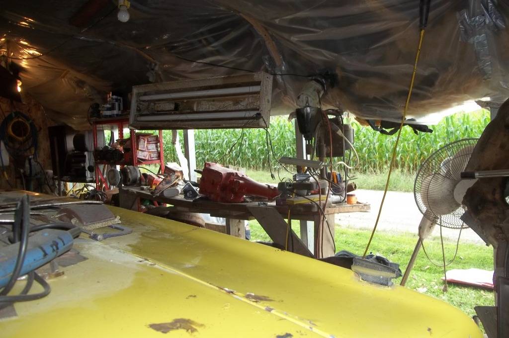

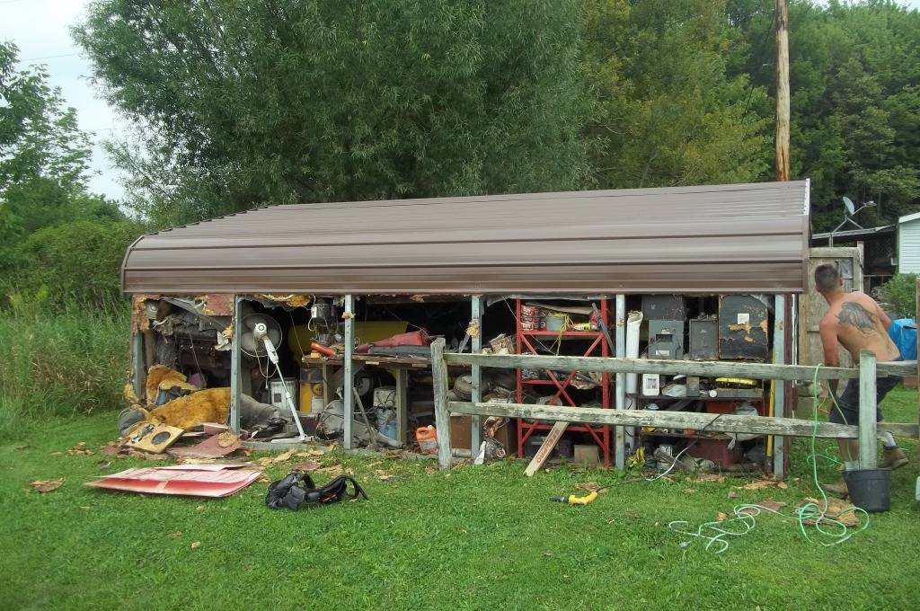

Hey guys, i have my computer back, im behind with a lot and not to keen keeping up with new 'windows" programs and stuff so i decided to get everyone up to date and inbettwen my work ill post things ive already done... I think that will work anyway! BUT, First picture is my garage, yep, the whole thing getting new wood panels and then vinyl siding, My biggest problem here is i have NO pictures of the thing done, ill get them just for updates, besides it looks really good!!! The thing is, i just put the camera on here to download and these pictures i took in the middle of getting my PC fixed so im just behind in things and never thought to check if i had before and after.. im slow like i said.... anyway you can see the yellow fender, completely junk and my 4-speed on what i call my buffing bench.. I told you all many a times, im not fancy or exact-ah-moon-go the second one i, inside looking out and a mess everywhere this siding project helped with.. Thats Robert, my son in laws brother who is did this for us...

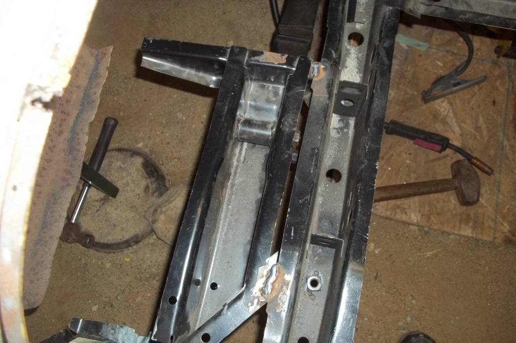

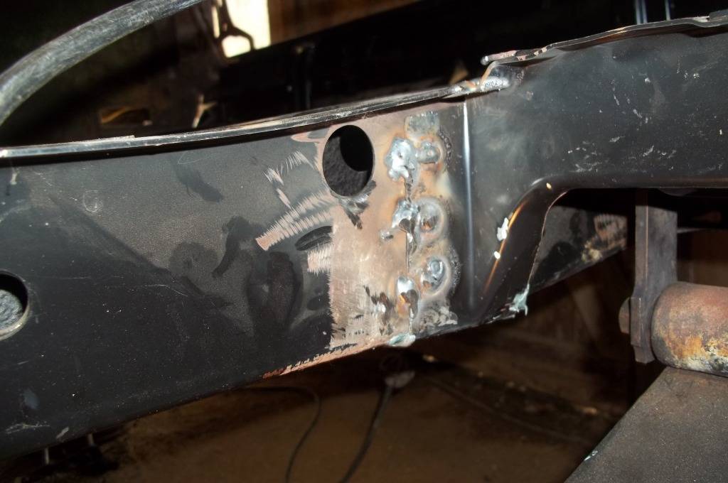

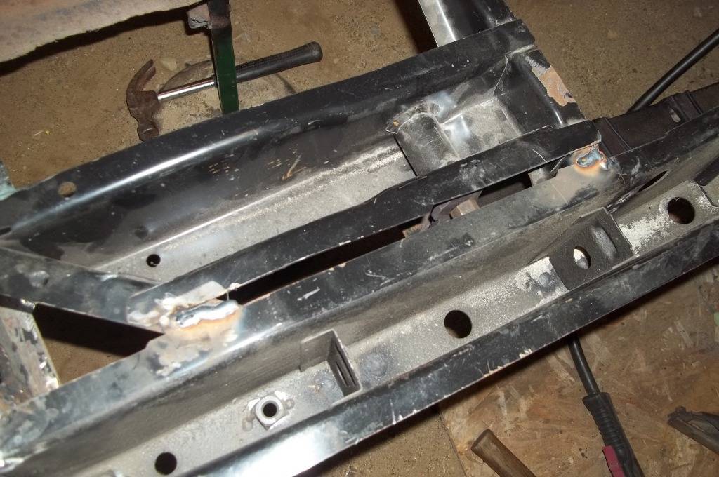

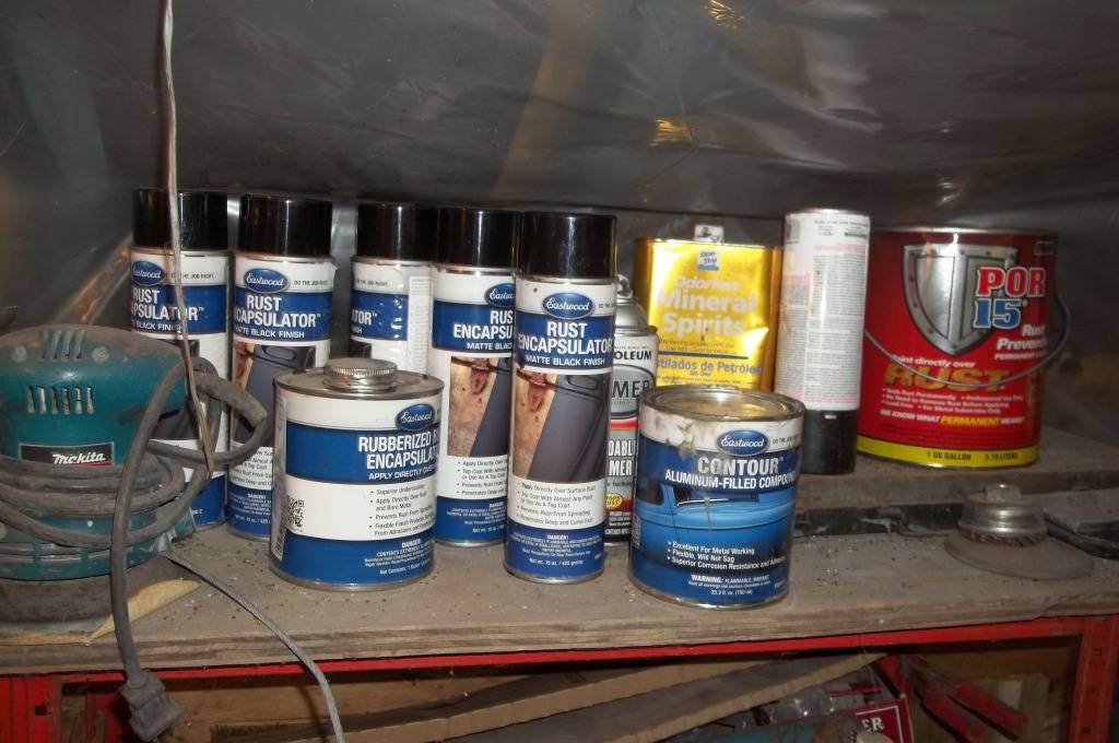

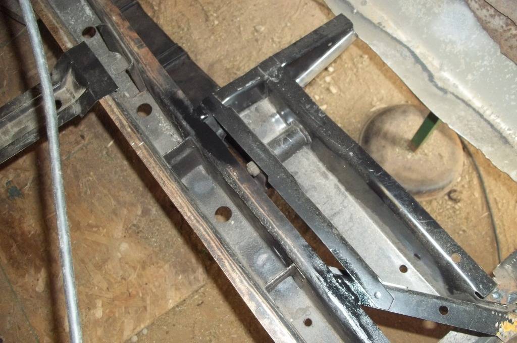

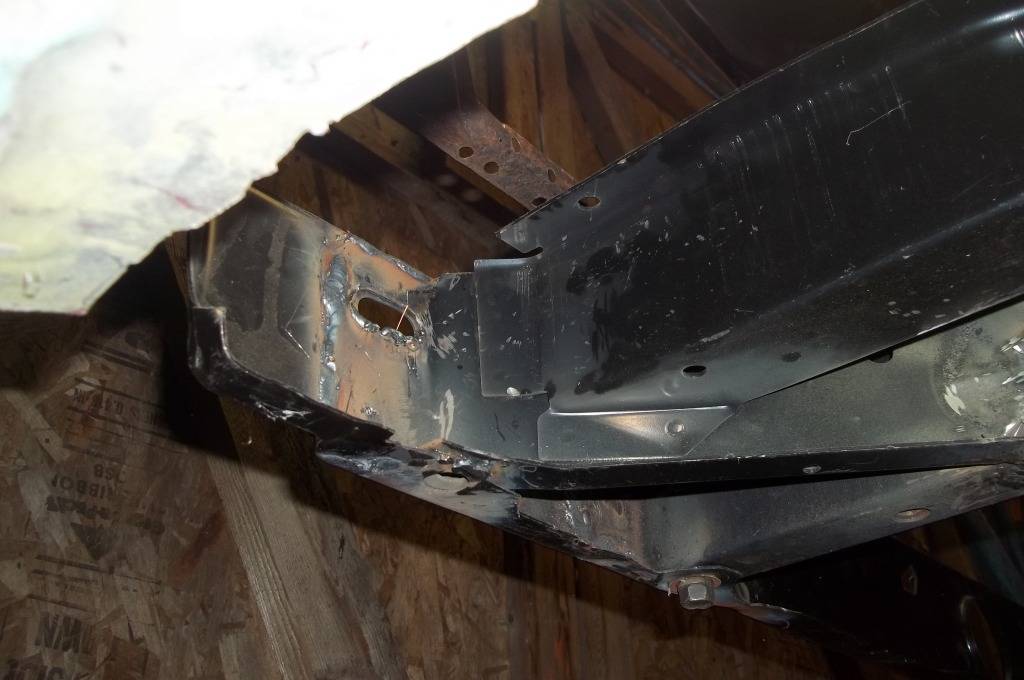

The next ones are the spring shackles to rails an and crossmember, I drilled 5/16 holes for plug welds and then touched up a little on the sides, Then i used Eastwoods "metal to metal" and pasted it on and then used that Eastwoods encapsulator over it, the pictures don't look as good as seeing them, the way i did it makes a good look i think... pictures are some when welded, some after grinding and then done, until i get caught up ill just post and hope :) In the order it/they should be and ill get the pictures leading up to this point... and im aware big time my welding isint PRO welding but!... Im not a pro! :)
I should say that i do check and make sure my welds are penetrating the metal ok, and im happy with them, sloppy i guess, but satisfied... and this one picture is some of the stuff im using, a mis commutation with my listening skills and i ordered the wrong stuff with the Por-15, it was Rust bullet i think now but i cant allow myself to have this stuff sit and order another 200 bucks of other so i will be using it on the underneath, the inside (rails, rocker's) and some of the outside parts will be Eastwood, and its "supposed" to be great stuff....

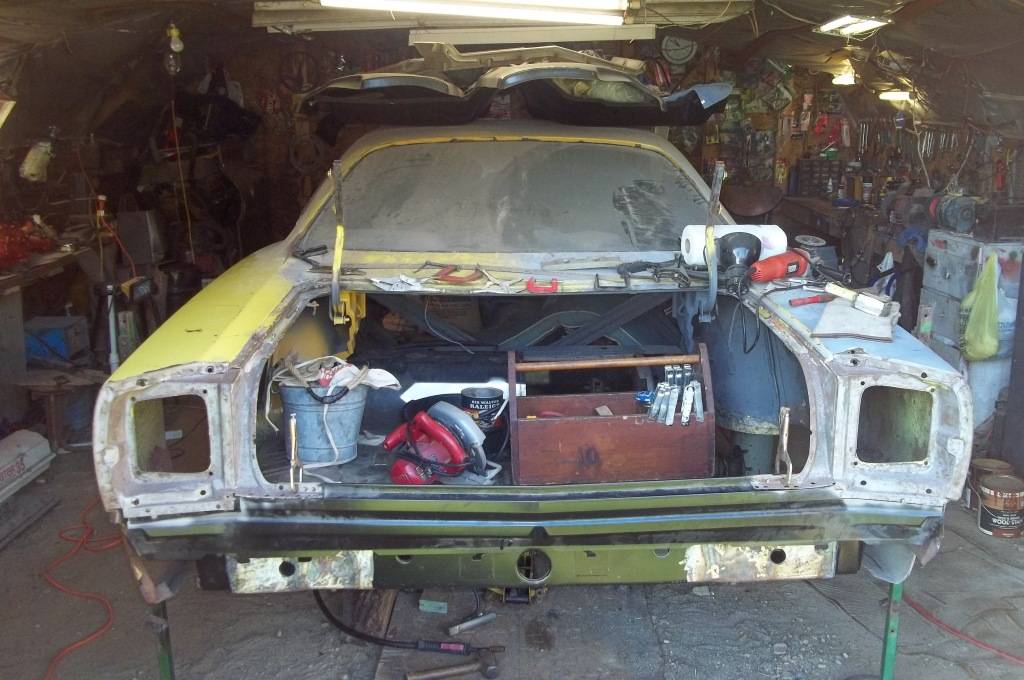

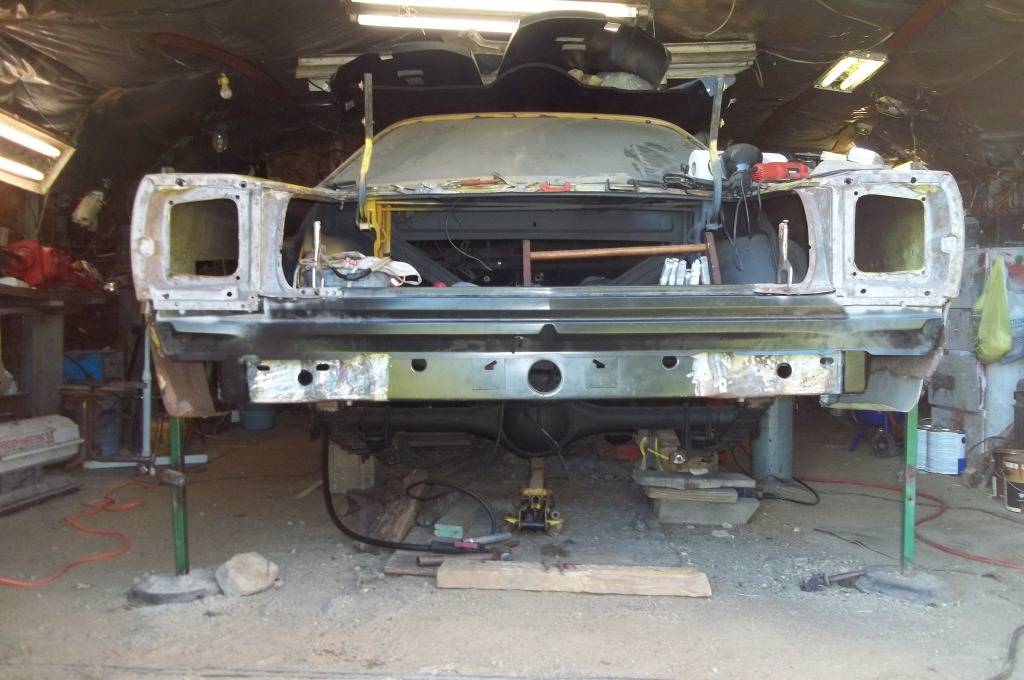

The last i have right now is some of the tail panel alignment starting, hope to get more pictures and more work soon.. I still need to go thru folders for other pictures...

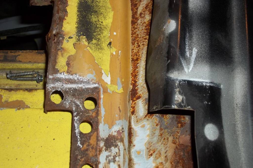

The tools in my trunk pan, checking things :) are Roberts doing siding.. One thing i don't know if i mentioned but the leaf springs and differential have been media blasted, rust converter and primed, I have no room to put things so with winter coming on my son in law helped me get them under the car and hooked up, i was about jumping up and down lol to find everything fitted right, so far, I got used but original shackles from Mark here and new Moog bushings for the perches and springs and everything fit like a glove, the down side is under the car, sanding, primer and final paint will be harder, oh well, it cant all be easy!!!
If anyone is wondering about the supports on the side of quarters, I didn't want them moving after the tail panel was removed, Wow, i didn't realize how much it took to keep a thread updated! lol....
Lookin' good. Pro looking welds are for the pro's! As long as it penetrates good and you're confident with it, that's all that matters. I just did some undercoating on my Coronet today so I can get the diff back under it too. I wanted to do that before I put it in and I really want to be able to move it again. (But now I have to learn how to put a diff together!)
As for your side supports.....yup I was wondering!
I've been away from mine so long I'm beginning to worry if I'll get back to it. Oh well, I can get my fix from your build and others until the cold hits and then I will get back at it.
Thanks guys, Im working on the tail panel now and i see the original has a little different build to it then the AMD, not much and i have some ideas that may work but wanted to show you... A small down slope in the area.. Don't think it will be a problem at all... It has been a sunshiny day and the wife and i are or did work on buttoning up the old place for winter, good thing is were about ready which is making us both happy!!!
Good work Ron keep it up, also don't worry about the welds, the more you weld the prettier they'll look. You got the penetration and that's what counts.
Hey Ron, glad you put those pictures up. Now I have something to use for a reference for mine. Like everyone else said, as long as the welds are solid, who cares if they aren't pretty.
