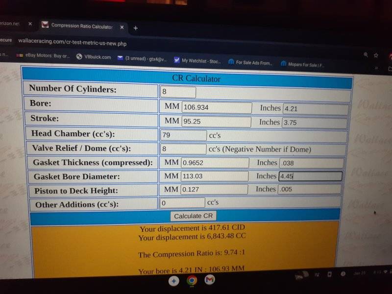

No. I used 0.040 piston to head, and 78 cc.
With your numbers I still get 10:1. Again, details matter.
Oops. I used 4.28.
again details matter lol :). that was back in 2004 I think mine came out to 9.8 now that I think about it. it was a 1965 Chrysler 300L had to be careful with the total timing for pinging. it was a heavy car.
