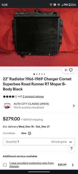

Or you can get one of these.
Looks and works great.

Ended up using the dakota pick up upper hose and original type lower hose--also found a reducer for lower hose--thanks for all the help---I cant tell you how many rads and vendors I searched and never came across the Auto City Classic radiator (at least at that price) at that price--it would have been perfect--
