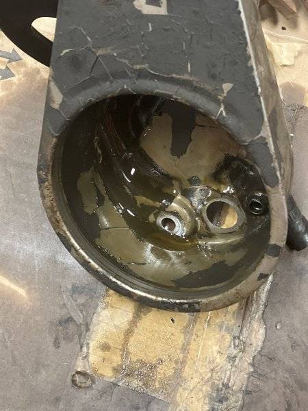

I just put another pump in the reservoir. It was a used one from the shed. At first it made the typical grinding sound until it had pumped up. I hooked it up to the steering box only. Assist was excellent even at idle. I wanted to confirm that the pump was adequate to provide boost for the steering before hooking up the HB lines. The steering had me confident that I was DONE with steering pumps.
Then I saw the leak. It is coming from the bottom of the housing. See photos below:
Keep in mind, every time I change the pump, I have to swap over the reservoir, the brackets and the inline cooler.
The pump body has this big O ring that seals to the reservoir.
I think that is where I am leaking.
Regardless… it has to come out and get pulled apart to get to it.

I pulled the pump again and took it apart again. I took the O ring from another pump and put it all back together. NO leaks and the steering works like it should.
One thing that is a trait of mine is the determination to never leave meat on the bone. I don't like to lose and I don't like to give up.
This has good and bad elements to it. The good: I usually prevail and am glad that I followed through. The bad: When I keep at it while pissed off and intolerant, I'm probably not doing my health any good with all the yelling, cussing, cuts and scratches and such.
The pump that failed this morning was working fine yesterday but when I took it apart, I found the flow control valve and valve spring pushed way to the front.

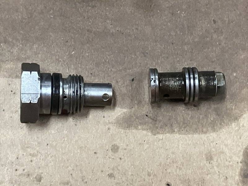

If you haven't taken one of these apart, here we go:
Here is the back side. You can see the bracket mounts at approx 11 and 5 o'clock. These serve two functions. They hold the pump into the reservoir and they are a mounting point for the brackets.
There is a return nipple and at the bottom, unpainted is the union fitting that serves a few functions.
The fitting serves as the port to attach the pressure hose and also holds the following in place:
The flow control valve on the right determines the amount of boost that the pump will make. Rick Ehrenberg of Mopar Action magazine stumbled upon this discovery something like 10-12 years ago.
Take note of the picture below.
The green arrow points to a 7/16" headed bolt that screws into the valve. The red arrow points to a thin washer that fits under the head of the bolt.
V8 cars usually got one washer, the slant six cars got more. The more space between the head of the bolt and the valve, the lower the boost. Rick experimented with different amounts of washers to reduce the boost to an amount that he felt was acceptable. This trick has been covered in the forums before. From my memory, the most you'd want is .125 thick of washers. Beyond that, the pump starts to get choppy/notchy especially at idle with big tires.
I left just the one washer in place in the pump I just put in.
