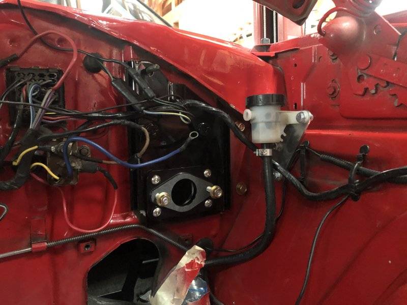

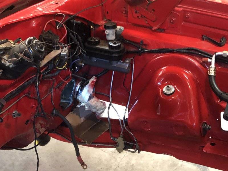

I moved it to the fender apron near the firewall.
It is accessible but not in the way of anything.

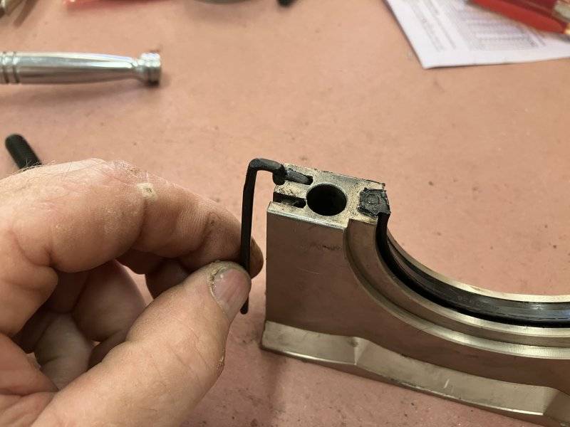

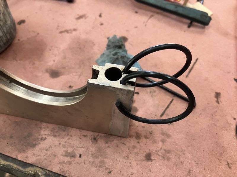

Regarding the rear main seal leak. Do you think your issue was that the side seals were not fully seated on the first try?
At first, I suspected that I may have accidently installed a seal for a LA series small block since my many gasket sets may have been mixed together. I measured the crank journals on a 318, a 360 and a 440 crank and found that they are different enough that it would have been obvious upon installation if I had the wrong seal in place.

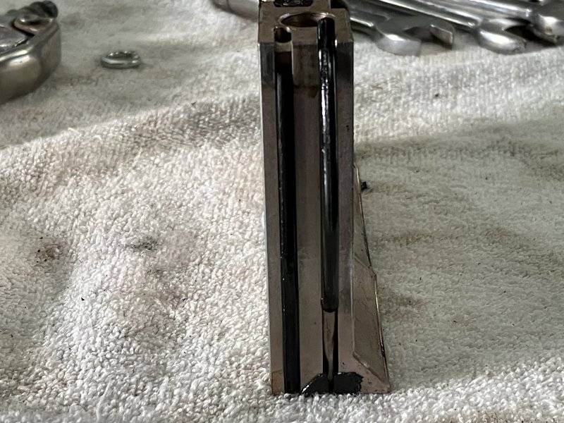

During removal, I saw that I had the correct seal and it was installed correctly. This retainer uses O rings to seal the sides. They fit into the top hole and bend around the sides like a candy cane. There is a machined groove in the top and the sides that the O ring presses into.

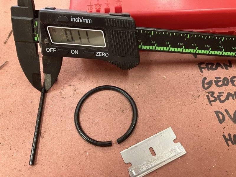

The old O rings were stiff and needed to be replaced but the closest size I could find was slightly larger.
They fit but were kind of old.
I noticed when I pulled the retainer out that these has broken.
You can see gaps at the top of the left one and the bottom of the right.
I tried to install another set of O rings but the diameter was larger....Too large. They kept shifting out of position when I installed the retainer. I decided to just leave them out and instead, smeared this stuff in the side grooves:

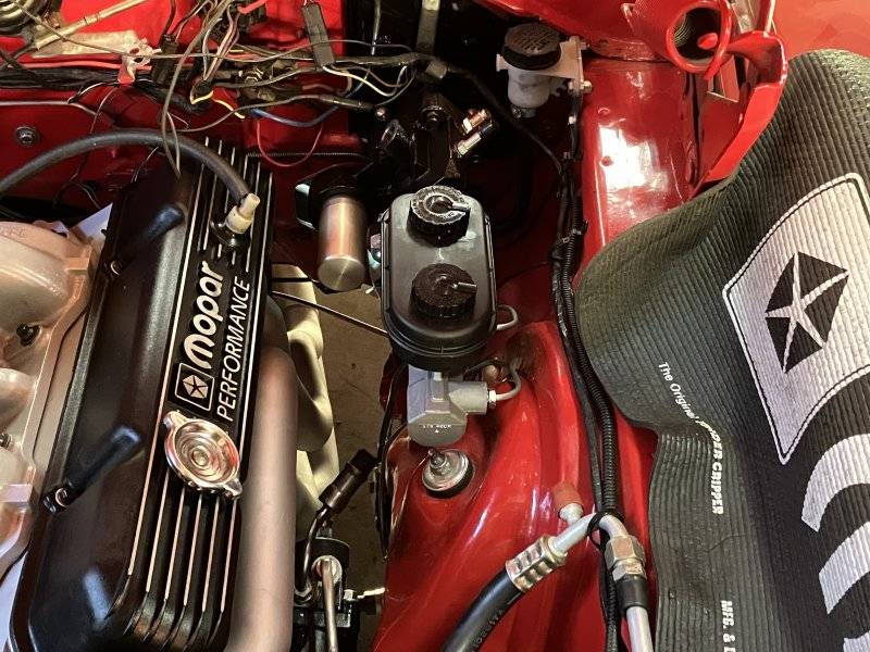

The power steering pump swap is complete. The pump in the car now is the one I’ve had since 2006 or so. It has worked well since I put it in.
Steering boost works like it should.
Hydroboost is dead. No boost. No assist at all. Stopping the car feels like before, similar to a power brake car with the engine off. Very disappointing. I drove around the back yard at low speeds to see if it would start to build up pressure but I’m getting nothing.
I don’t know what I did wrong. The hydraulic lines are tight and not leaking. They are connected to the right ports. Maybe the HB unit itself is bad?
At least I can drive the car at low speeds. The car lift bay has been occupied for over 5 months while the maintenance on the other cars here have been delayed. I'll be able to move it out so I can do some overdue stuff on the truck and Jigsaw.
I’m going to let it stew for a little bit before I make a decision.

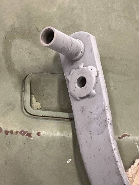

I will admit though that my inclination is to pull this unit and install the manual master cylinder that I was originally going to use. If the pedal effort seems too high, I may pull the brake pedal and drill a new hole above the original one to increase leverage.

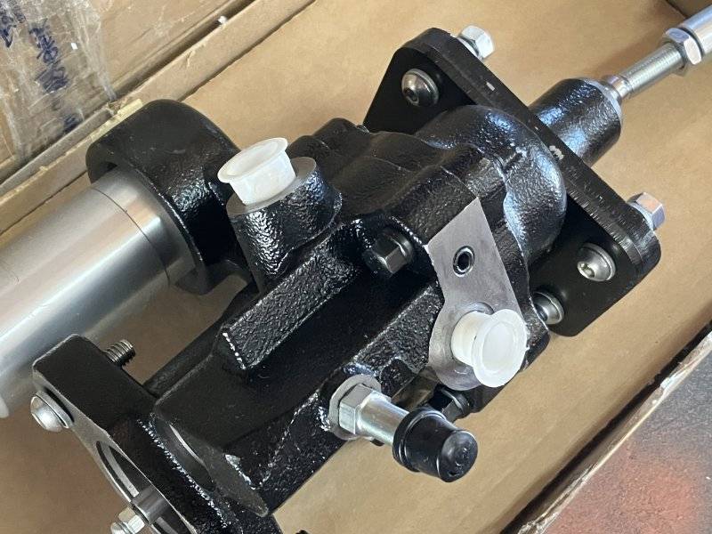

Dumb question but did you check the ports on the booster to make sure there were no plastic plugs inside ? Those plugs are easy to miss, don’t ask how I know. I am not being a wise a** here and please don’t take me the wrong way.
These were in the HB unit when I removed it from the box:

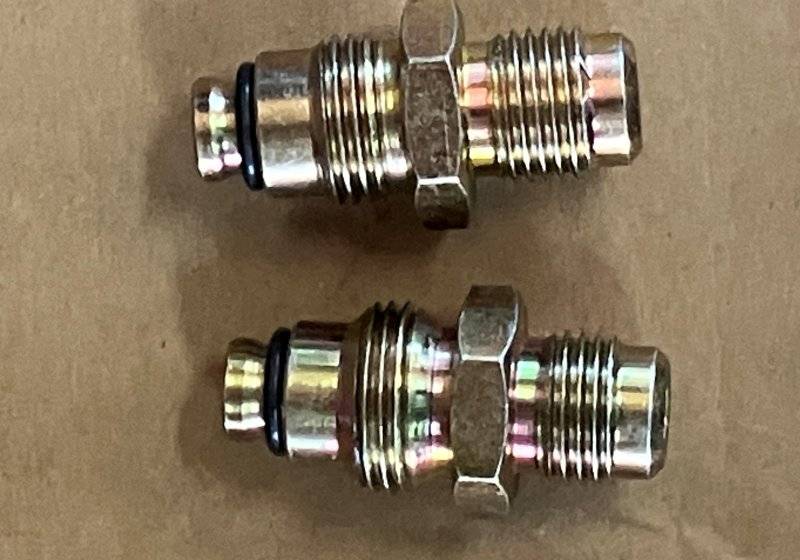

They had to come out to install the brass adapter fittings:

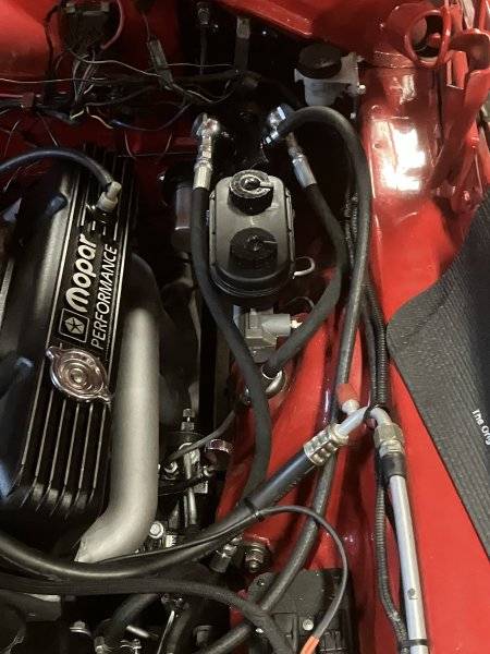

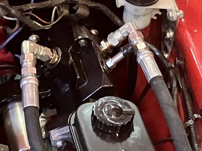

This is with the brass adapter fittings and 90 degree AN fittings.
This was with the banjo fittings for a neater, tucked in appearance.
This is the simple 15/16" manual master cylinder setup that I put in right after painting part of the engine bay in June.

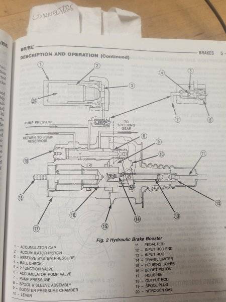

Here is why I am leaning toward a bad booster: Somehow, the fluid goes into the HB and back out to the steering box and the steering feels normal.
I'm confused as to how this can be. I sent an email to Dr Diff. I figured I'd ask him for guidance since he requested that I install and report on the performance of the unit. He is at the SEMA show so I may not get a response right away.
