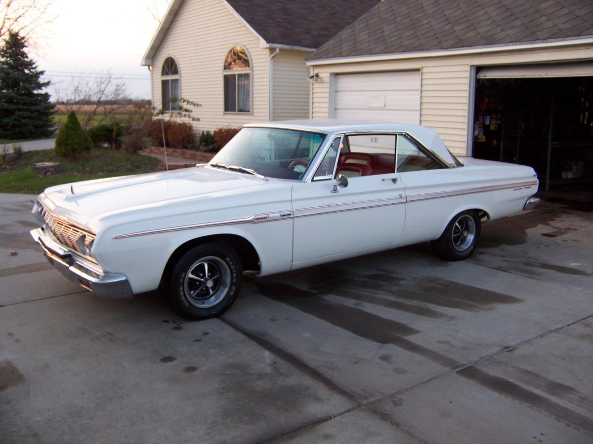

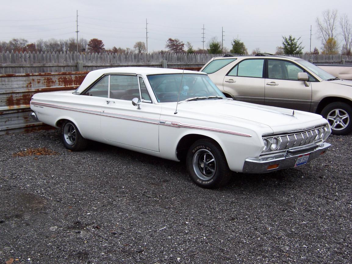

Cole;I've got a set of 235-60R14's that came on the Plymouth;they were on a 6" wheels and had no clearance issues. A little rub at the front at full lock turning. I'd think a 275 would fit in the rear-with the proper backspacing-the fronts...maybe a 215? I've got to think the wheelhouse dimensions are similar. Clearance issues might arise when turning. I'll let the experts offer better advice...
