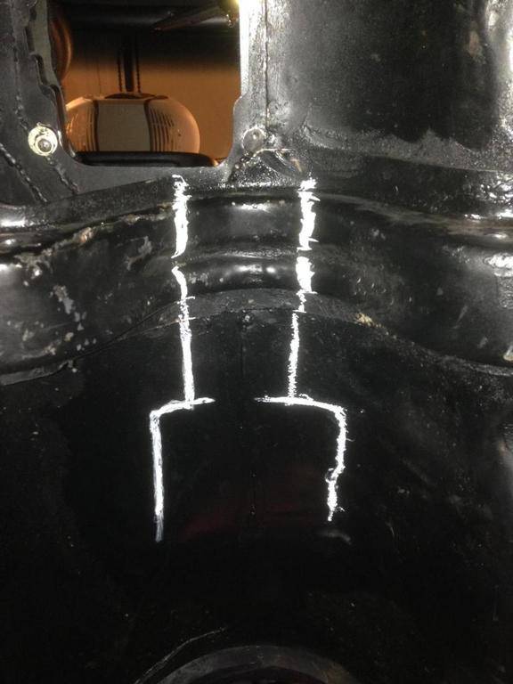

what I'd really appreciate is if someone could get me the proper tail shaft height from an original setup. Maybe from rocker panel pinch weld to pinch weld left to right and how far up? Should have measured mine before removing it but I really didn't expect this.
When I put the 727 back in my car, I can see that the tail is 1 1/2-2" higher than it sat with the TKO600. That's more than enough to give a vibe. I loved the overdrive, but there is no point if you can only drive 60MPH anyways. I found anything after that it started to vibrate.
Here is a photo of how much I'd have had to cut (including trans crossmember) to get tail high enough to have angle right. If I didn't have dynamat already layed I probably would tackle it.
i set my drivetrain up to run 3 degrees downward tilt and left the rear end exactly where it was from the factory. I can cruise 125 all day with no vibrations.... I'd say just check the output angle of the trans and if its 3 deg down you will be ok...dont get too much or too little or it will induce vibrations

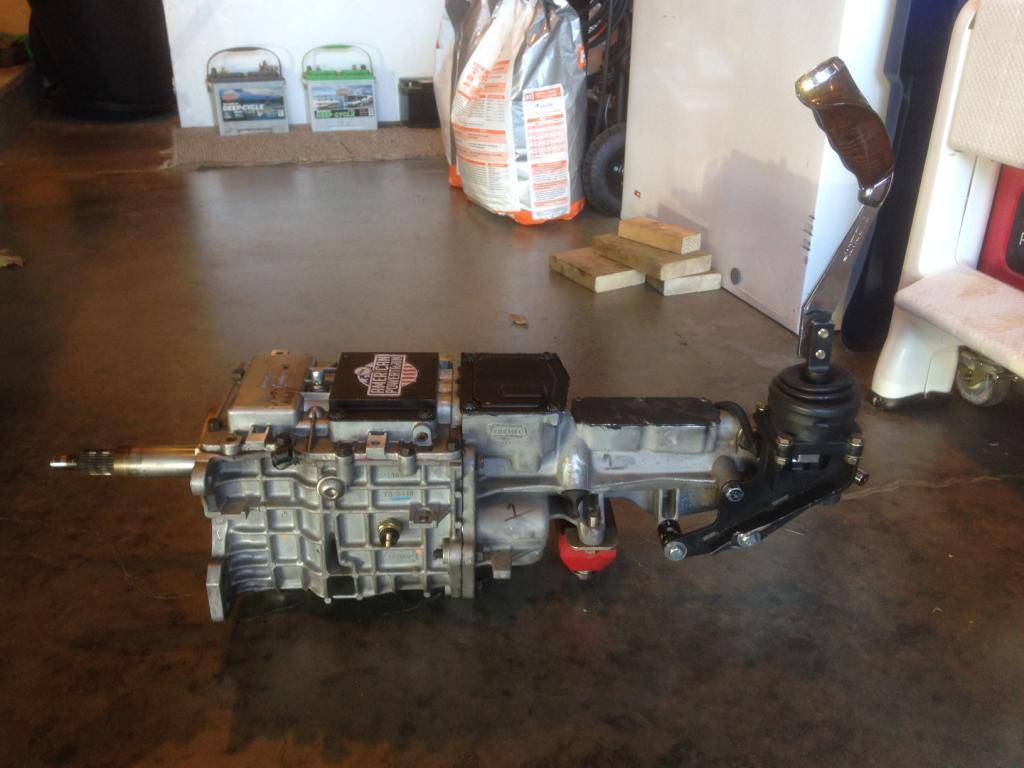

I fancy that shifter! Looks like a good length and the pistol grip is sweet
Hmmmmmmmmmmmmm, you'll have to explain that one to me??????? Forgive me I'm a little so sometimes haha. I'm a little curious to how that shifter even works since it's not even in one of the shifter locations (shift rail comes out the back)? Does it improve the shifting?
Yes rod comes out the back and hangs over the tail shaft causing the slip yoke to have to stick out too far so it clears shift rod when in 1st, 3rd or 5th. This and a combo of a bad driveline angle results in a high speed off load vibration when the splines relax. Thus the 727 back in the car.

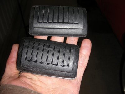

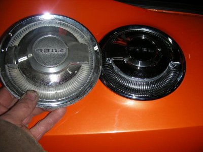

Now for my Christmas gift from my daughter.:icon_santa: She knew I hated that broken Emblem. I also bought pads for my new man pedals haha.

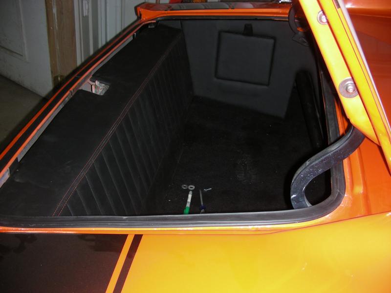

The last piece has arrived, the Quicktime bellhousing. Here's some more eye candy for the Charger. The daughters gift made me dislike my ugly gas cap even more so I took advantage of Year Ones 30% off and ordered a new one and a new dome light lens. The upholstery shop just finished the trunk panels too, didn't have time to clean them up and just threw them in there.
Agreed. Man that trunk looks great. You could probably draw up diagrams with dimensions and sell them!
Thanks guys, Once I get a chance I'll show how their made and installed (really simple).
