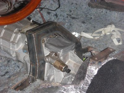

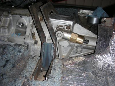

Here's the progress report, Viper T56 fitted. Next will be re connecting the cross member, in the pics you can see my plan. In order to get it to clear the rear shifter location that I'll be using it will be tipped forward a bit. I'll make 2 of the brackets, weld one on each side of the inside of the cross member and then box them in.
I'm very happy with how little has been chopped out on the actual floor (almost all of the cutting was done on the hump).

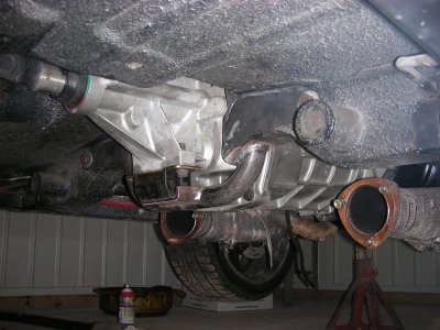

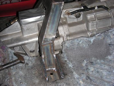

Time to update my thread since I've been over in the Trans and driveline section lately. The cross member is done, restored to better than factory strength and the tranny mount done as well.
First is a pic of the 2 plates all burned out, ground smooth and test fitted (remember I had to lean them forward to clear the shifter location).

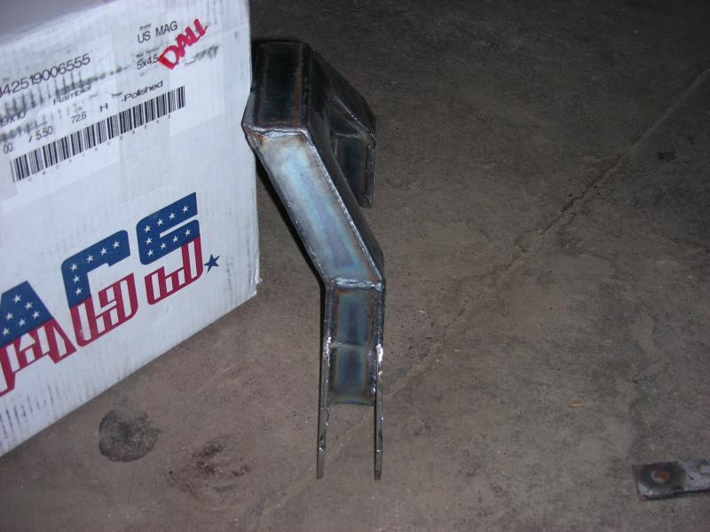

Now is 3 pics of the plates fully boxed in and ready for install.

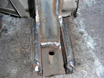

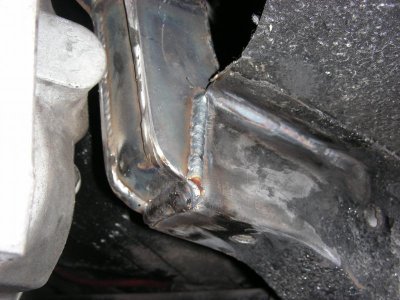

Now all welded in.

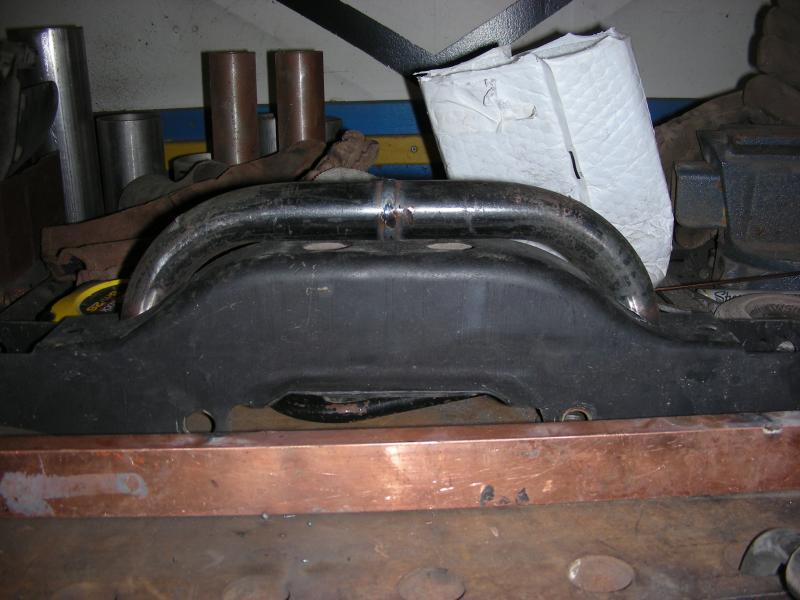

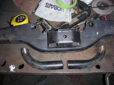

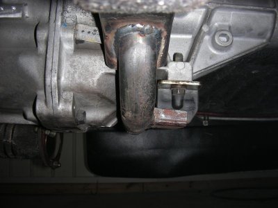

Now for the tranny mount, I'm sure you can see where I'm going with this right off of the bat. I wanted to really tuck it up in there and keep the install really neat (still need to drill 2 more bolt holes and install sleeves in the frame).

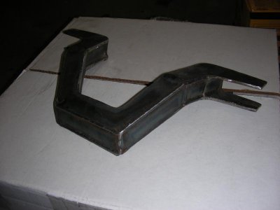

Started off with the original tranny mount and some bars my brother had bent to make Z bars out of (Shhhhhhhhh don't tell him).

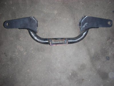

After welding it all up and cutting the center out it's all done except drilling the extra bolt holes.
Here's the final product (minus 2 holes), I'm pretty stoked with the results.

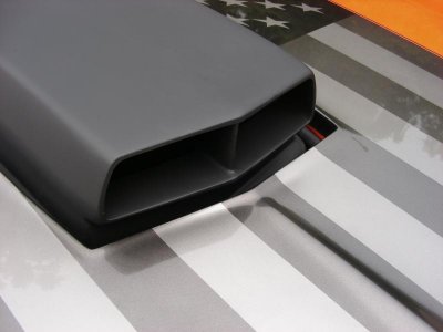

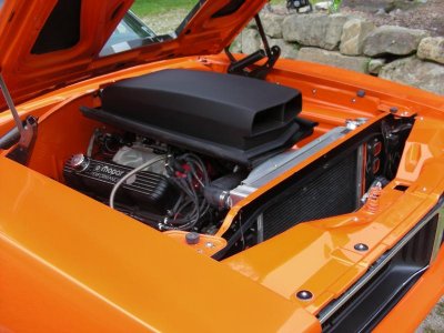

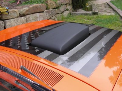

Thinking about a new emblem for the Charger haha, problem is where would I put it? Maybe the hood scoop? any ideas?
Actually thinking a graphic like the old six packs had for the hood scoop that has 456 in big numbers and six speed in small letters under it? I like that better.

Damn! That tranny isn't going anywhere! She's put together very well.
Thanks Prop, It might be overdone a bit but I feel good about it.

I think you missed a big part of the thread, I couldn't bring myself to use it haha. The Ford scoop never got mounted on the car and is still collecting dust, instead the scoop that is on the car is a 100% made from scratch shaker scoop that resembles a Cuda grill (a little).

Great work on the tranny mount, looks real smooth. Excellent fab work as usual. :thumbsup:
Thanks Monro, Your car is coming along great and looking really sharp.
